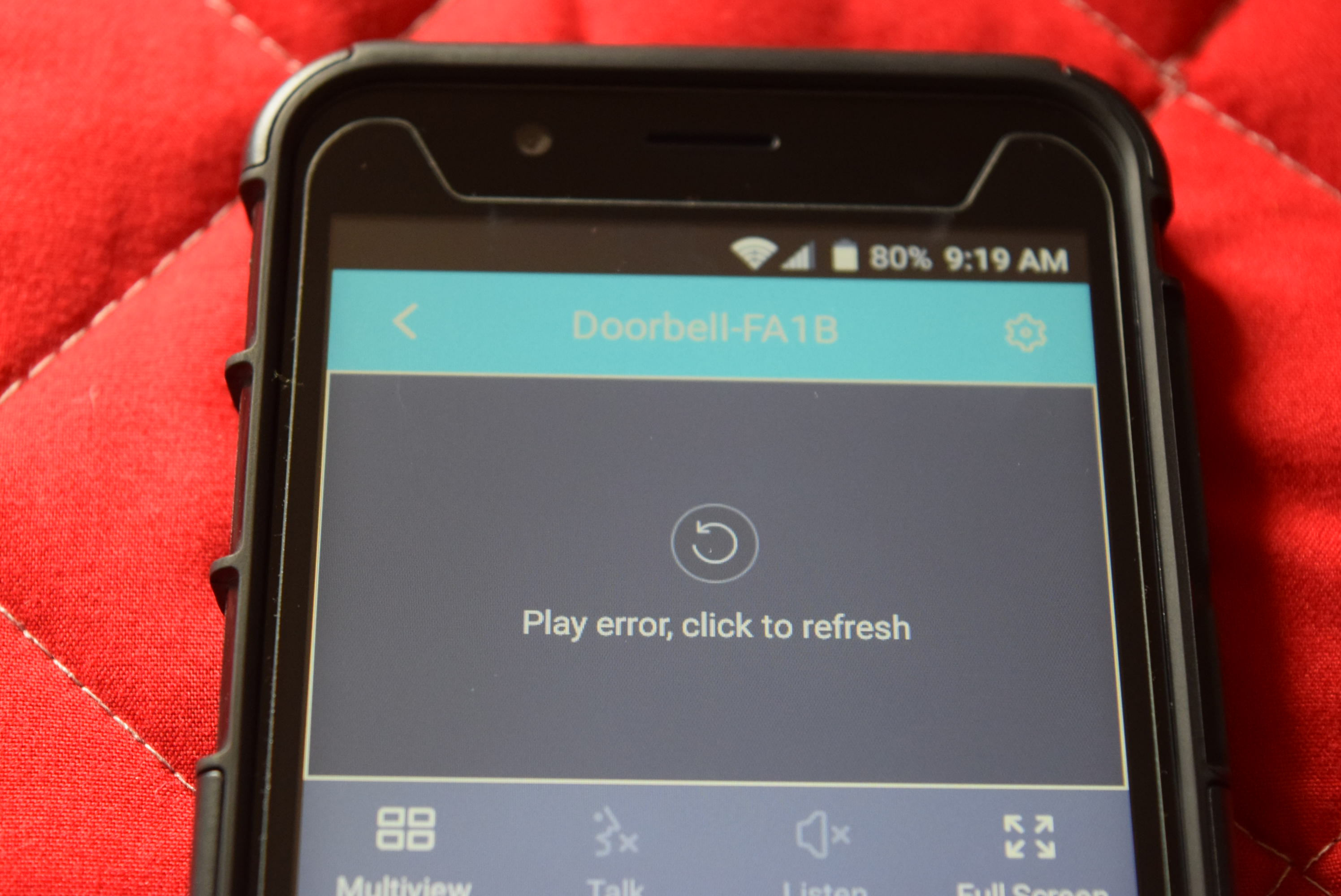

i find it very discouraging the replacement ad110 struggles with 1080p live view streaming. the smart home app live view frequently shows the "play error, click to refresh" message.
checking the device information on the smart home app takes longer than what i think is acceptable as if the doorbell is not ready to talk to the app or vice versa. smart home app also keeps showing the doorbell as offline even when the NVR shows the doorbell is online and recording. live view on the NVR lags with so many skipped frames. using the smart home app motion detection motion range frequently shows 'failed to load.' support ticket process is equally slow. *sigh*
