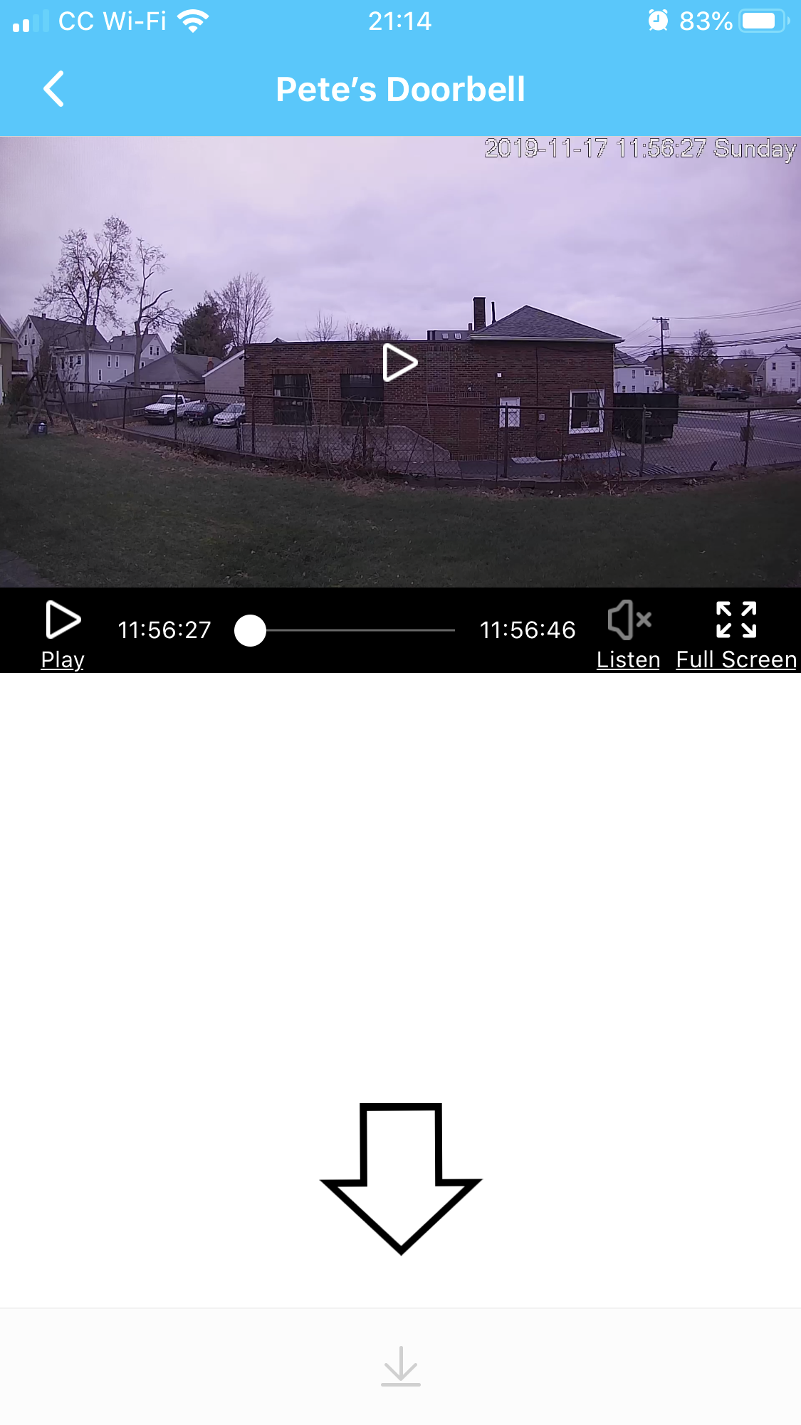

I can view any of the Card Recordings but as you can see here there is a little arrow at the bottom of the screen which seems to be a download but it is grayed out / doesn't do anything when viewing the recording.

WOW that don't look nothing like what I have seen...
Is that the camera view on the Smart Home App?
Re: Amcrest Doorbell
Yes - This is the iPhone App, and my first time using this app ever so I don't have any previous experience. It says it is version (get this) 3.2.1 =)
Interesting lol... Well that explains that I haven't seen the IOS app so I am not sure there might be some type of issue they didn't know about yet... I would reach out to Amcrest tech Support and see if they can Clear things up...
