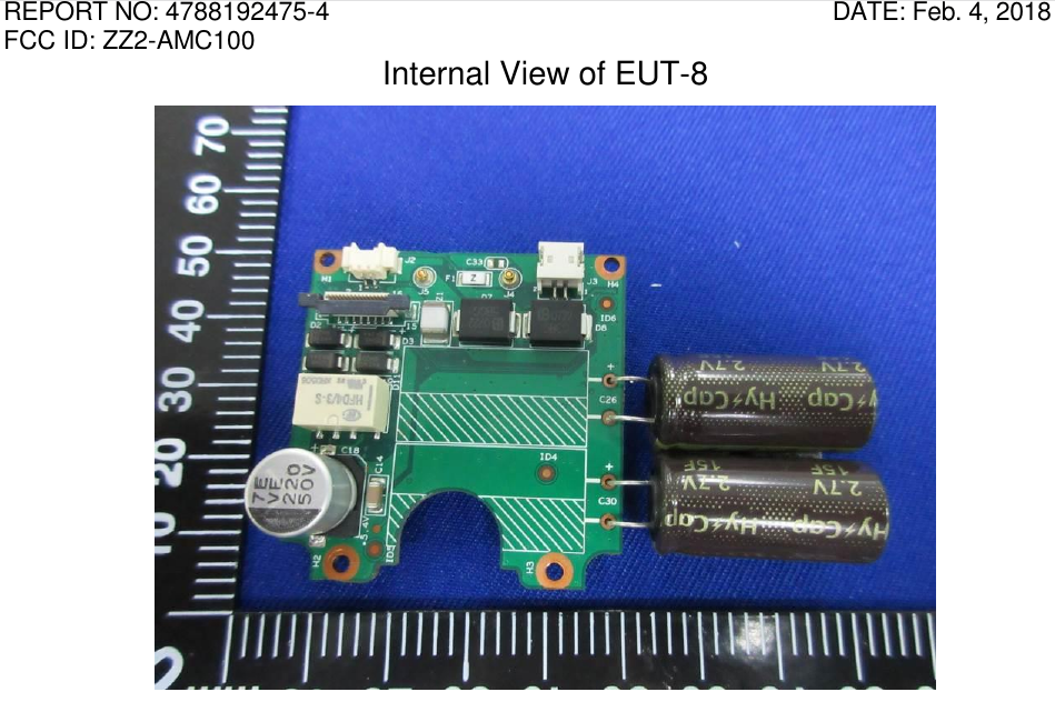

next was to cut the power via the breaker. the blue ring light stayed on when the power was cut. the internal pictures posted on the fccid.io shows at least two capacitors that would help explain why the blue light stayed on when the power was cut.

Interesting... I hope that isn't yours if you want a RMA lol. I know it isn't just saying though... So 2 1.5F 2.7v Super Cap and see the Classic 4 Diode Bridge Rectifier, Relay, 220uf 50v SMD cap, Fuse, snubber network.... SO this is what is the Power supply for the Doorbell where is the camera part lol jk...
Please no one take your Doorbell apart... Unless you don't want a Warranty if ever needed...
