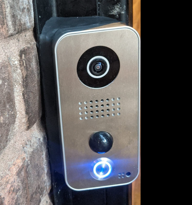

Gave it a year.... the Amcrest AD110 is bye bye. Changed to the DoorBird D101S. It is a little choppy as the frame rate is lower, and I cannot view the doorbell in the Amcrest View Pro (have to use the Blue Iris App), but these downsides are small prices to pay for absolute stability and much better responsiveness of the PoE wired LAN solution.

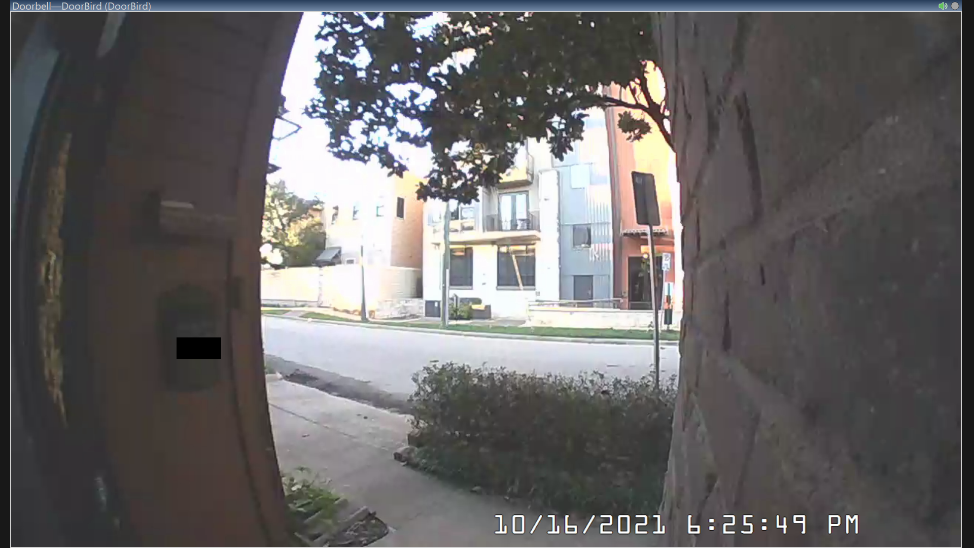

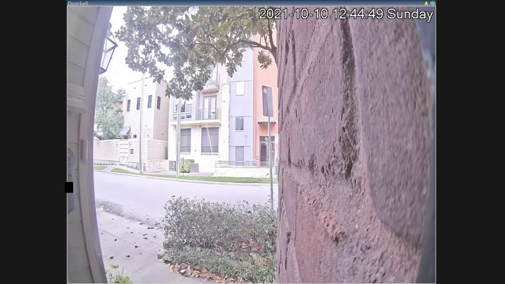

I got my DoorBird ("DB") up and running. The image admittedly not as good, but it is not that bad. I have attached before and after shots. The biggest difference is that DB is "fisheye" to give a wider view. I have other cameras to capture license plates, this only needs to be sharp enough so I can recognize faces, and both cameras meet this criteria. The upside to the lower resolution and wired ethernet makes it much faster response time. From doorbell push to notification is under a second. As a bonus, The Amcrest camera failed to load 80% of the time, and the rest of the time it took 5 seconds to load. I took the door chime kit off my doorbell, as DB gets PoE so doesn't need it, and simply rings the inside doorbell by connecting two pins simulating a button press. Also, DB now remotely opens my electronic lock on my gate with another relay. This is purely a bonus, but it it pretty sweet. DB NEVER LOSES CONNECTION—EVER—and works very well with Blue Iris. In short, I wish I went with this solution from the beginning. This is an Amcrest forum, so to Amcrest: please check out your competition and consider making a PoE solution. I wanted to go with you and would have paid a premium if you had the same features and your better camera.
