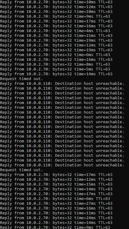

when I upgraded my transformer from 10v to 16v, most of the "doorbell is offline" things went away.
I will keep monitoring wifi/pings.
Find the IP of the doorbell and run a ping -t to it
Mine has said "Successfully connected to wifi" at random times and I see that the pings stopped simultaneously, but I haven't had issues in the past couple hour, will continue to monitor the wifi signal.
My doorbell is " 11ng (2.4 GHz) 92% (-54 dBm)" and among 60 clients, it's in the middle in terms of signal quality, will hope it stays connected. so far so good
amcrest doorbell disconnecting.PNG (55.02 KiB) Viewed 2621 times
