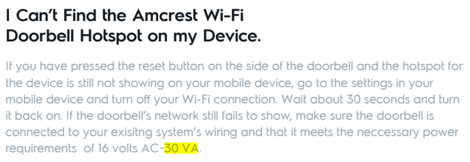

amcrest168
Posts: 474
Re: Amcrest Doorbell
Post by amcrest168 »
Revo2Maxx wrote: ↑Mon Dec 09, 2019 2:07 pm I am going to guess that the answer is going to be no. You see while the Camera can use them Volts to run the camera using a Step Down Converter to 5v and I am going to guess that the Amps would be around 500ma... There is a few things going on in there as well. With some Electronics that is going to convert the AC volt to DC because it also runs on DC..
Main thing is that this Camera was built and designed with a Door Bell Transformer in mind. However if your Door bell that you have is say already at the Max Rated Transformer because the installer or builder was Cheap lol. Then to be safe I would upgrade the Transformer... However under normal everyday systems I am sure the Transformer that is already installed will be more then enough to work an Amcrest Doorbell camera...
Edit: So please don't pay no mind to the Whole Ac and Dc power... The Door Bell Camera uses a Normal 16vac to 24vac power... It is in the Camera that the power is changed over to DC... Sorry i don't want to confuse anyone and make them think then Need a DC Power supply it works off the Normal DoorBell 16 to 24vac that is all that is really important...
i found the answer. it appears the ad110 doorbell works best with 16V 30VA.
