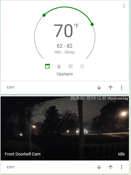

I am able to add via RTSP to sighthound and homeassistant lovelace card though, good stuff :ugeek:
Code for homeassistant
configuration.yaml
Code: Select all
camera:
- platform: generic #AMCREST FRONT DOORBELL CAM
still_image_url: http://10.0.2.70/jpg/image.jpg
stream_source: rtsp://admin:password@10.0.x.x:554/
name: Front Doorbell Cam
username: admin
password: asdfasdf
lovelace manual card
Code: Select all
aspect_ratio: 50%
camera_image: camera.front_doorbell_cam
camera_view: live
entity: camera.front_doorbell_cam
type: picture-entity
