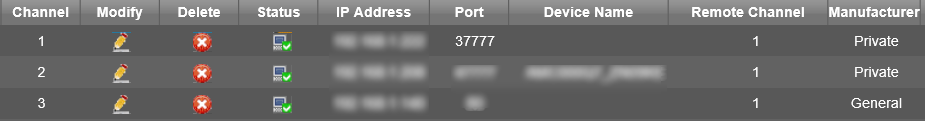

I recently purchased one of these cameras after having several other Amcrest cameras that I'm very happy with. I'm having some issues with this one though. The camera is connected to my NVR over RTSP. It stays connected all day with no issues. At night, it loses network connectivity every few minutes. When the NVR loses the connection, I can no longer ping the camera, or connect through the Amcrest app on my phone. After a few minutes of being offline, I can hear the camera say 'Successfully connected to network', then my NVR pics it up again.
My front porch light is on a timer. As long as the porch light is on, the camera seems to stay connected. As soon as the light goes out, and the porch gets dark enough (when the IR led is triggered?) is when the issues start happening. I've seen other people complaining about the camera regularly swapping between night and day mode, which mine is doing as well based on my neighbors exterior lighting.
I've tried a factory reset. I've tried upgrading my doorbell transformer to a larger one (16V 30VA). I'm running out of ideas short of leaving my porch light on all night. Anything else I should try before I return it? There's not much in the way of configuration options in the app, so I can't think of anything else I could try? Maybe I have a bad unit?

hi @Jurykov and welcome to the forum. do you have an amcrest nvr? the doorbell should be added as a private device as opposed a general device via rtsp. consider re-adding your ad110 doorbell as a private device instead of via rtsp. for illustration, i have added a camera via rtsp on channel 3 and it shows up as a general device. channel 1 is the ad110 doorbell added as a private device and it stays connected to the amcrest nvr even with the night infrared night/day flipping.
