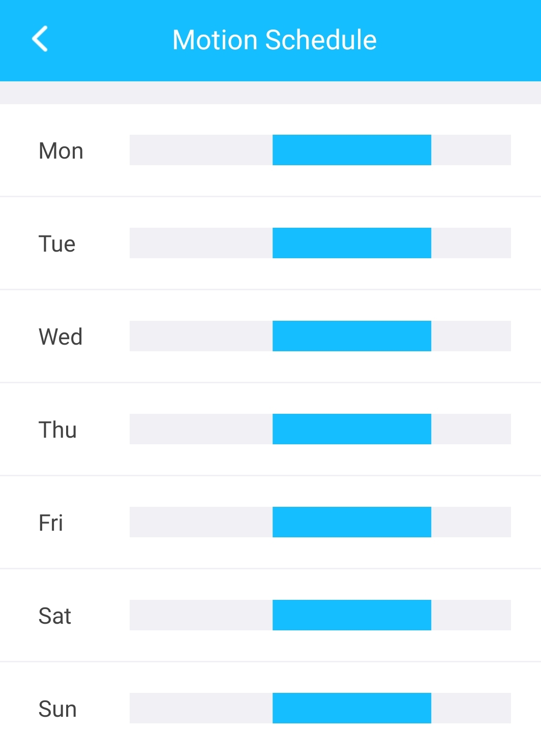

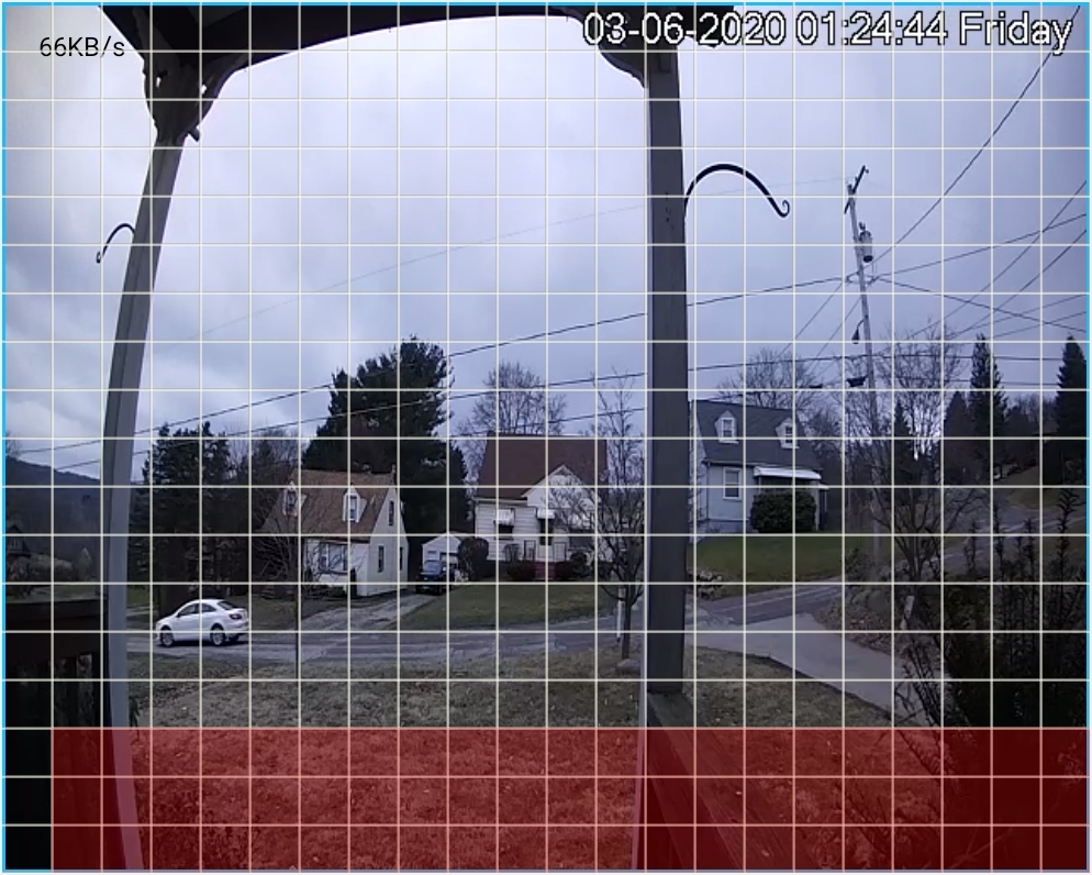

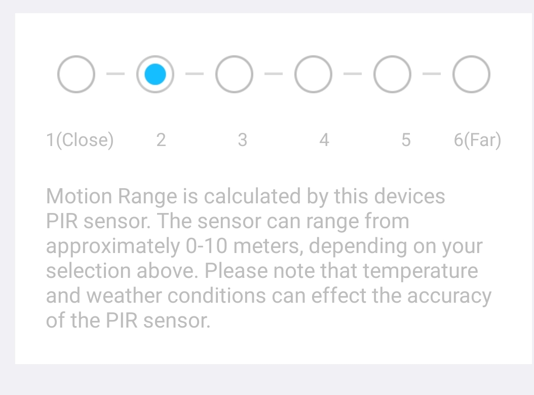

Hello Bit8Bit welcome to the Forum... Sadly motion was tricky.. I can say that I have mine on the 3 lower sets and I changed my Detection level down to the second dot on the level... Sadly I can't say this is good for everyone because I have mine set on my NVR to record and don't really care if I get alerts on my app unless someone presses the button... I was getting loads of alerts but I have a road that points my front door now I get no lights because I also change the Schedule to remove that time when light would set off the camera because it does SHINE right into my camera when they come off the hill...
