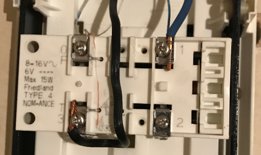

Re: Amcrest Doorbell
trying to get my existing doorbell to work. this is how it looks today before i connect the amcrest doorbell camera.
any suggestions would be nice.
- doorbell.png (267.76 KiB) Viewed 1329 times
@Ekke Something that kind of puts up some red flags is the left side of the photo it says 8-16v then says 6v Max 15 watts... 1 That transformer isn't going to be big enough for the doorbell camera. 2 It is hard to tell what I am looking at in the picture.. I would need better deteail of your system. Make Model? Odd thing is it looks like there is some large house wire like what would carry Mains Voltage. Then I see some Ultra Thin Wires or at least 1 but kind of looks like 3 and them some Ultra small wires... Would need something that is good enough for 2amps.. to the camera
