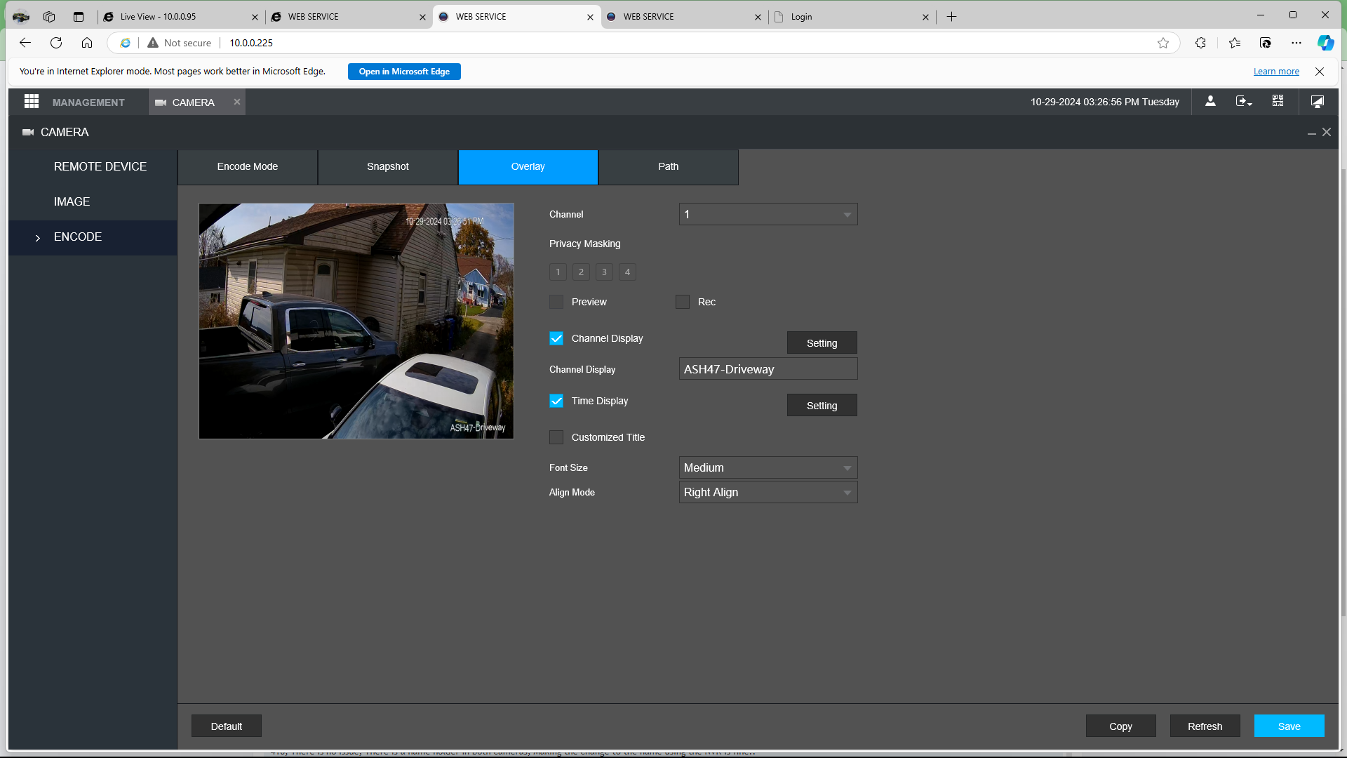

There is no issue with changing the camera name. While I will admit that the one I have here is the 410. When it comes to the name of the camera it works the same between the 110 and the 410, There is no issue, There is a name holder in both cameras, Making the change to the name using the NVR is fine..
NVRs WebUI, Click on Management, camera, encode. Then on the top of that screen are 4 tabs click Overlay, then next to the camera picture is a drop down for channel pick the channel you want to change, then change the name of Channel Display, IF there is a name and some reason yours was off make sure there is check box, If enabled already change your CAM# so what ever you want to have as the name of your camera in that box. Then in live view you will notice that it has changed..
Screenshot (3541).png (94.93 KiB) Viewed 4472 times
Screenshot (3542).png (95.18 KiB) Viewed 4472 times

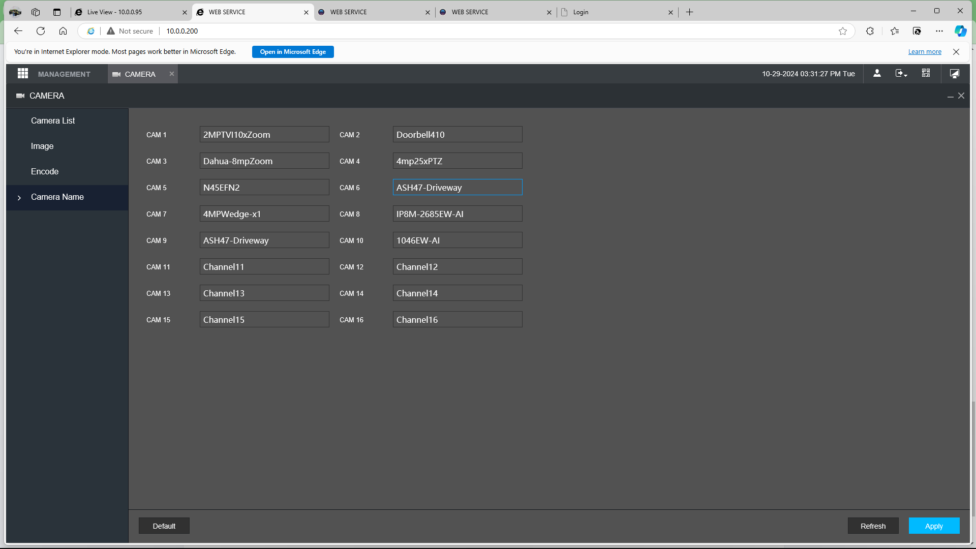

You are correct, It is under Encode within the Camera area. I have corrected my post. Thank you.. See picture below.
Screenshot (3545).png (340.2 KiB) Viewed 4462 times
Re: None of my Cameras Record
Sorry when I started my reply I was at thought of one of my AI NVRs, So I stopped at Camera when I meant to add in the Encode area, Kept going from the camera area rather then adding in the Encode. Gotta a lot of things going on these days.. Sorry for the confusion As you can see in my AI NVR here the camera title area is under camera..
Screenshot (3547).png (66.32 KiB) Viewed 4462 times
