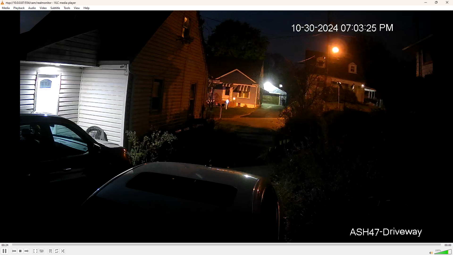

Want to know if your ASH47 is working with the correct password?
rtsp://admin:password@IPAddress:554/cam/realmonitor?channel=1&subtype=0&authbasic=64
You would need VLC or another program that you can run RTSP feeds with. VLC is best all around for many reasons..
Anyway enter your password and the IP address in place of the words and if you have the right password and IP then the feed will load and look like mine in the picture below.. This is using VLC..
Screenshot (3553).png (1.23 MiB) Viewed 3950 times

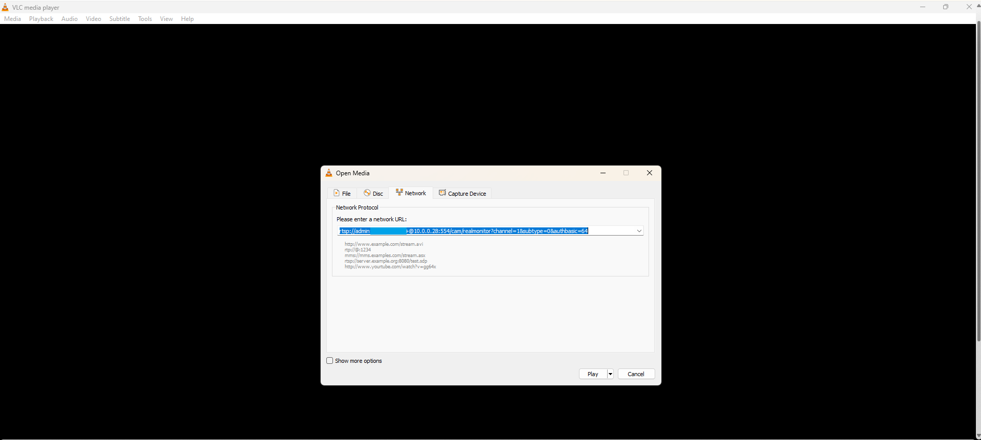

Re: None of my Cameras Record
IN VLC click on Media at the top left, Then click on Network Stream, Then copy that RTSP url above into the box area, then change the password and IP to meet your needs. Press enter and if the password is correct it will pop up a feed, if not it will pop up a box that ask for a good password.. I crossed out my password but should look like this.
