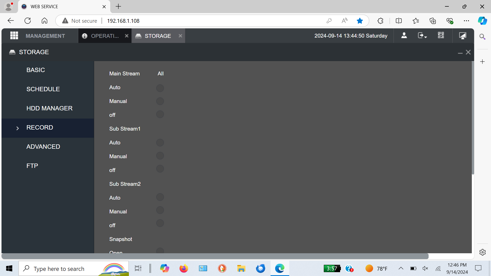

Yes, none of my cameras record. When I try to playback video from any of my seven cameras, I get a message that says there are no recordings! I have always been able to playback recordings. So, I checked my NVR 4108-HS settings. Everything looks good on the screens that have the schedule, EXCEPT the attached setup page. The instructions for this page says that these settings supersede any other recording instructions. The page is dead, nothing can be changed. All options are blank, nothing is checked and nothing can be checked. Aany advice will be appreciated.
Regards, Jim

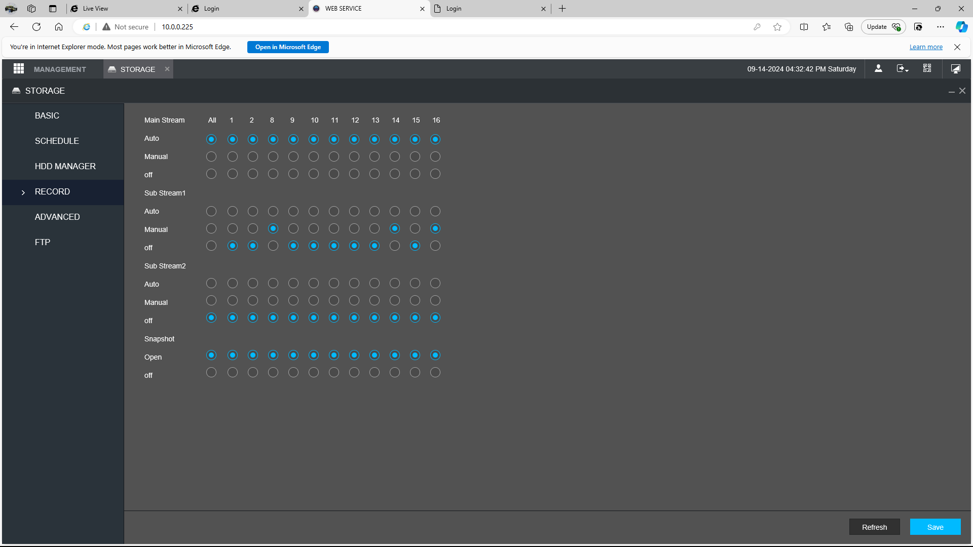

What is the status of your HDD? I ask because if your HDD is full right now and you have your system setup to stop after full it might be why there is no ability to change in the Record Menu. In theory it should look something like my 4116E-HS
I would Reboot the NVR if your HDD status isn't error or full. If it is Error or full correct that, then reboot and might need a reboot to correct. If all else fails then it sounds like you may need to Reset back to Factory the NVR
Re: None of my Cameras Record
There are no HDD issues, Status "Normal". I deleted some files, limited to 255 days of files. Freed up 95 Gb of data on a 1.22 TB HDD. But the record page is the same. Guess I will try to reboot.

I think the HDD is about 5 years old. I don't know about normal or PC HDD. If I bought the HDD, it is a PC WD model, if it came from Amcrest, I don't know. I formatted the HDD, it now has 1.8 TB free out of 1.81 TB total. HDD status is "normal". Everything looks normal, but nothing records. Is there some setting that could cause the Record function to be turned off? The storage log has no entries.
