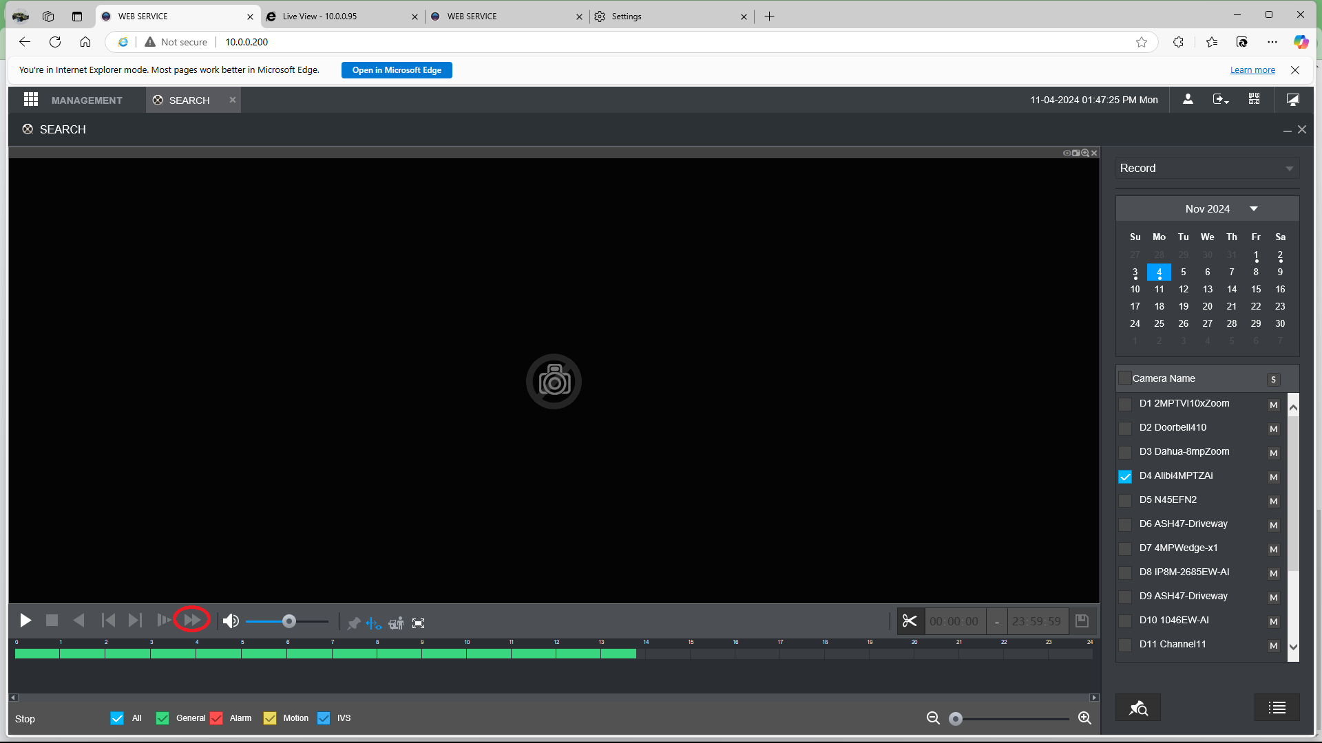

FF 16x using WebUi or GUI of the NVR. It is the double right looking button. Press it until it takes you to 16x then hit the one with the single right broken looking button to slow down..

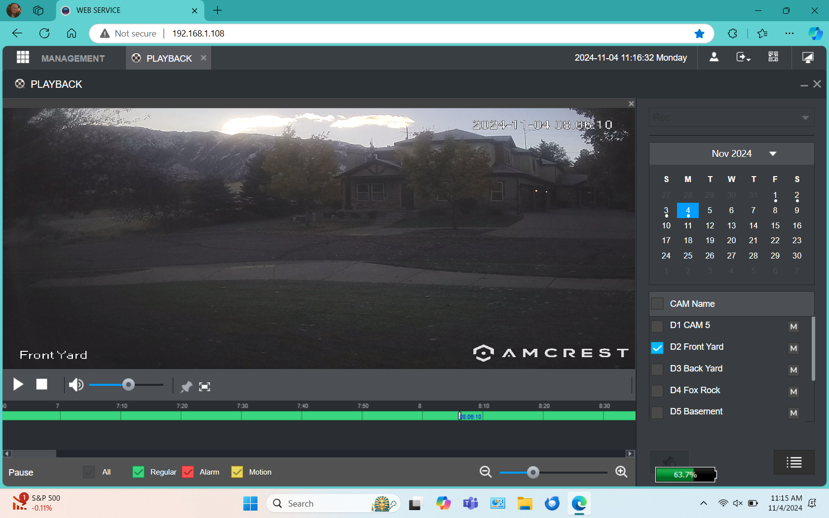

I don't see any double right looking button.

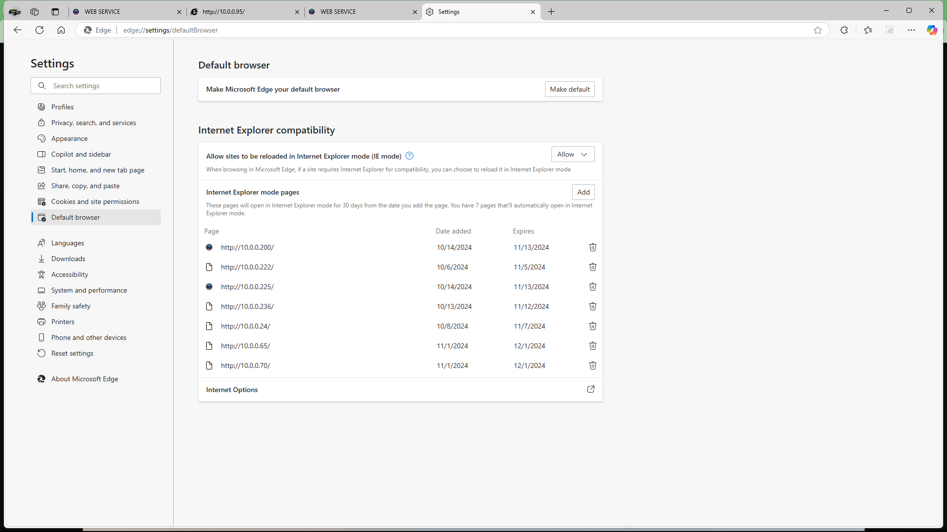

If your edge offers IE tab it is best to use IE tab for best results.. If you don't have it on your Browser top page like I have it might be that it was never used and will be added after it has been enabled.. From your view in the picture, Click the 3 dots on the right then settings and then Default Brower, then in there don't enable the browser to be default if you don't have it already in use as such.. You are looking at the box below to add in the IP of your NVR or Cameras that might be connected to your Local network.. See picture below right click open in new tab to see the picture full sized..

As you can see here in my Edge, using IE mode I have the extras that are not in Chrome or Edge normal..

When I get to the page that looks like yours with the additional left, right play buttons, there are no cameras in the play list. All of the cameras are in the device list in Management>Camera. etc.
