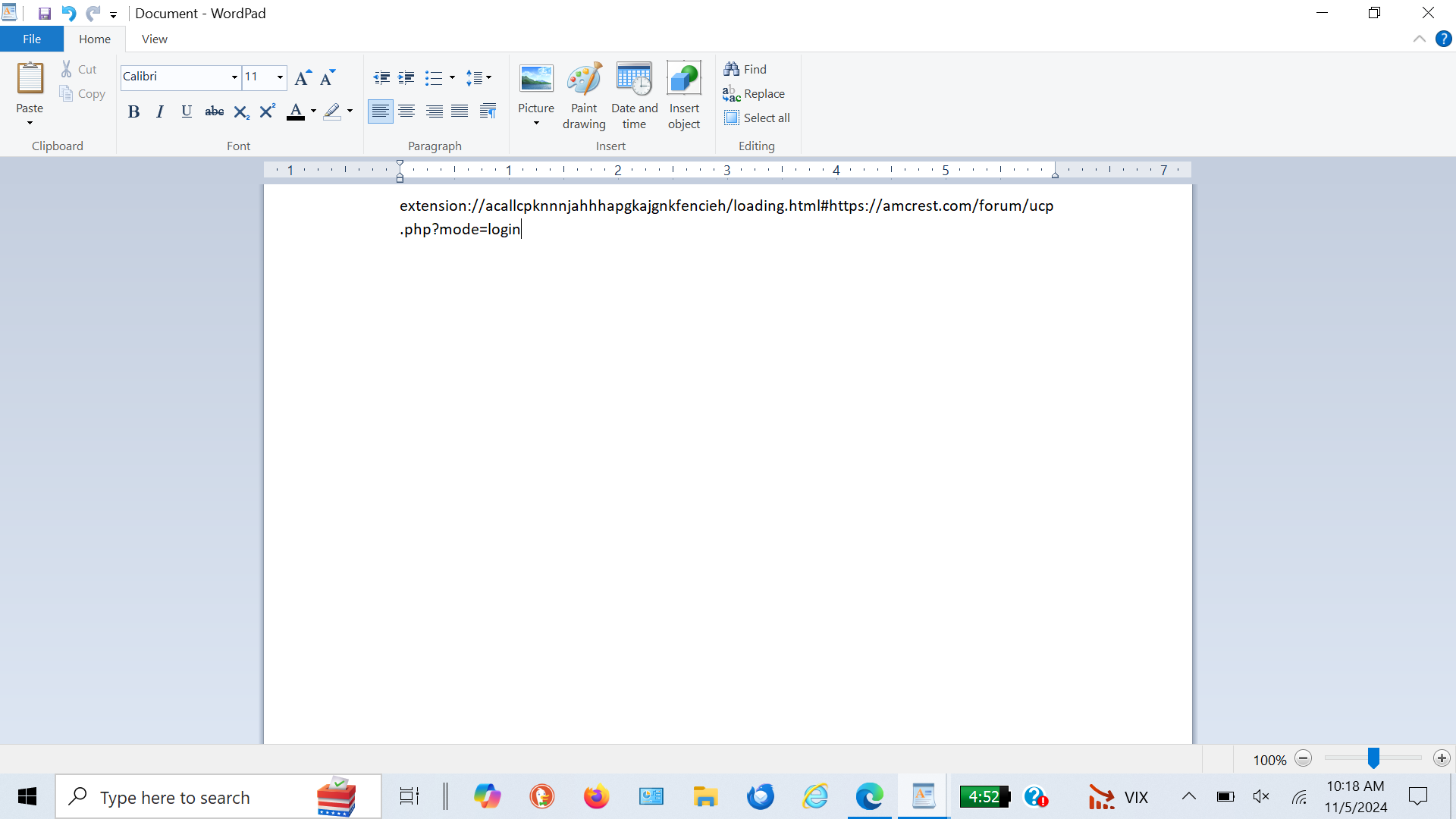

Here is the address that shows up when I try to login to the Amcrest Forum.
Screenshot (31).png (156.46 KiB) Viewed 3678 times
Regards, Jim
Re: None of my Cameras Record
Don't know might want to contact Amcrest about that. There should be no relation between the Amcrest Forum and your NVRs IE mode for your laptop. But I guess there has been stranger things.. Don't know how it would know one from the other. I mean if you were in IE mode and went to the forum in same tab I guess it might, But I don't use same tabs for different functions that is why right now using Chrome I have 12 tabs open so I can go back and forth between the things I am doing.. In Edge I use it only for my DVR/NVR and Ip cameras WebUI..
