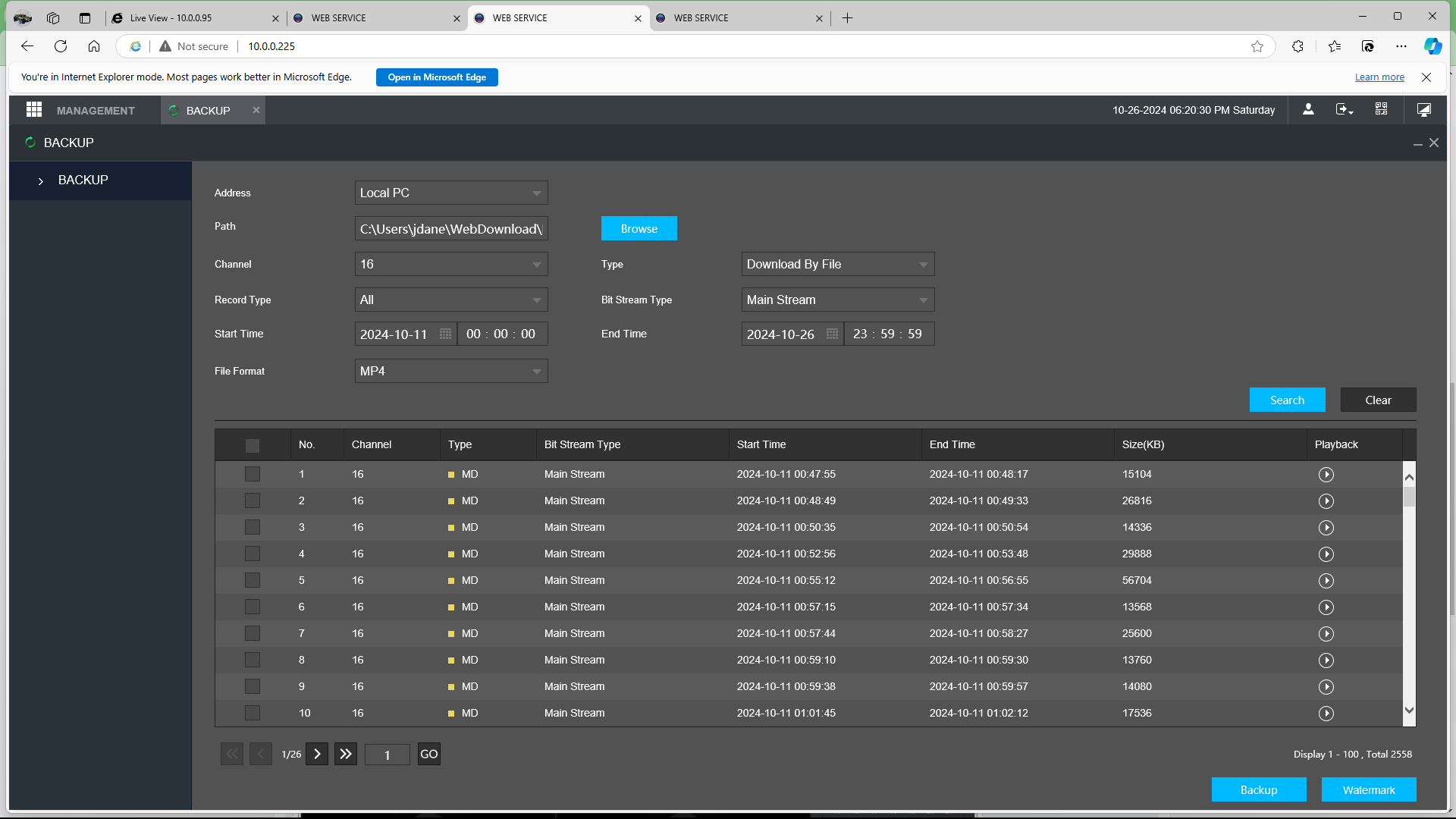

About it being easier in ASP to play back videos, That is interesting.. I mean using the both the WebUI and the NVRs GUI is much easier to look at cameras feeds and playback.. There is less clicks that are needed to change from 1 day to another. For instance, when you lets say want to look at footage for camera 4 on your system starting from 2 months ago looking for something that you know happened between 2-4pm. In ASP you have to bring up the date area every time and enter a start and stop time and what day you want to look. IN GUI and WebUI I click on the camera I want only 1 time ASP every time you want to look at another day... GUI and WebUI just have to click on the day in the calendar to change from 1 day to another. If you want to list the events in that day press the list button.. ASP have to click camera, click on start day and time then search. Want to look at next day, click camera, click day and time enter info and press search.. To be honest lets say you had 2 events each day that recorded 10 seconds each clip. My guess is that using GUI and WebUI method I would be able to look over both weeks before getting though 5 days in ASP..
In GUI and WebUI to be honest I could do 2 weeks in maybe less time in WebUi before playing back 2 days using Edge in IE format, Just by using backup function of the NVR.. For instance, Starting on 11th at noon on my Ai NVR on 1 channel for last 2 weeks it has 3600 events. On my 4116E-HS doing a search for one of my cameras from 11th 1pm to current day it has over 2502 events.. All being able to be seen on 1 screen. So if I wanted to look at just events starting at 1pm on othe 11th, After doing that search in 1 place, I look at the 2 current events, then scroll down list until next day at 1pm and watch them events and so on, All from 1 search playable from 1 area..

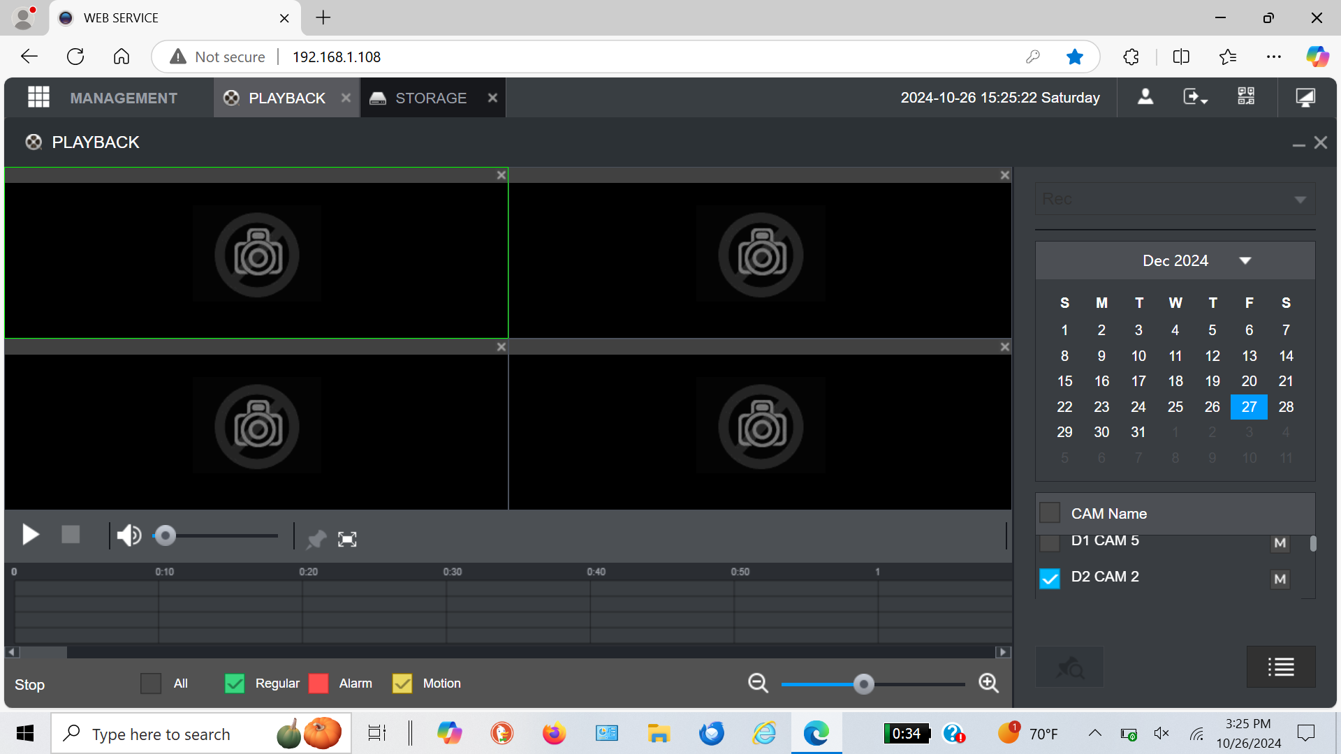

With regard to using the NVR GUI. Can you tell me why pressing the play button does nothing on any of the cameras in the list?
Regards, Jim
Regards, Jim
- Screenshot (29).png (255.97 KiB) Viewed 4332 times

Can I see pictures from your ASP. Because if ASP has footage from your NVR and yet your NVR don't have any footage then it must be that your ASP is recording using PC-NVR...
No footage seeing you just Formatted your HDD you said..

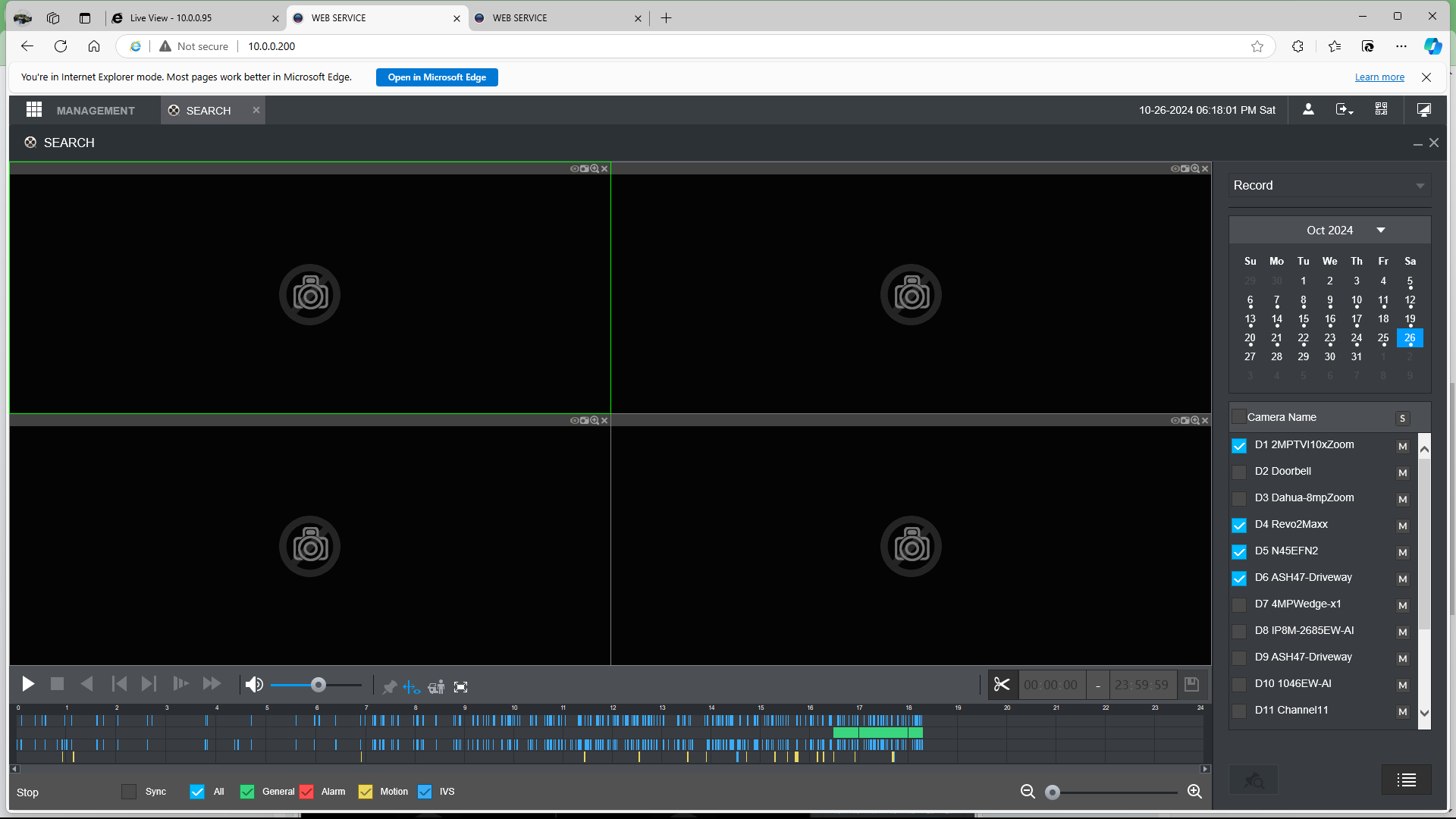

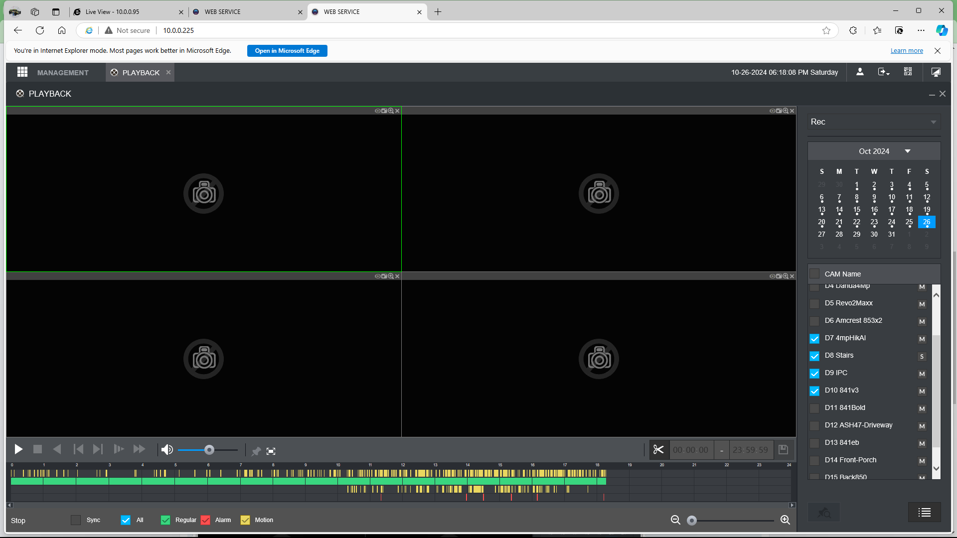

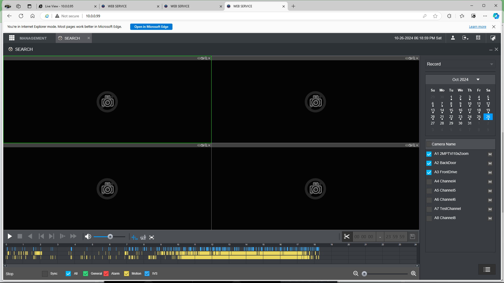

In my last picture you can see where I listed the ch16 from the 11th till today and have had over 50 more events since the last time I replied lol.. That isn't normally that busy of a camera.. On the first right pressing the playback button it will play the event..
