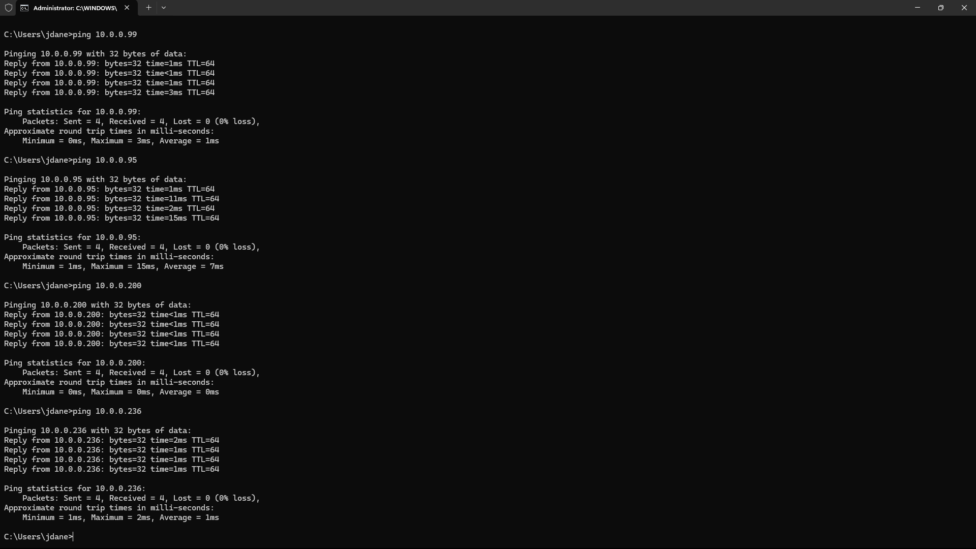

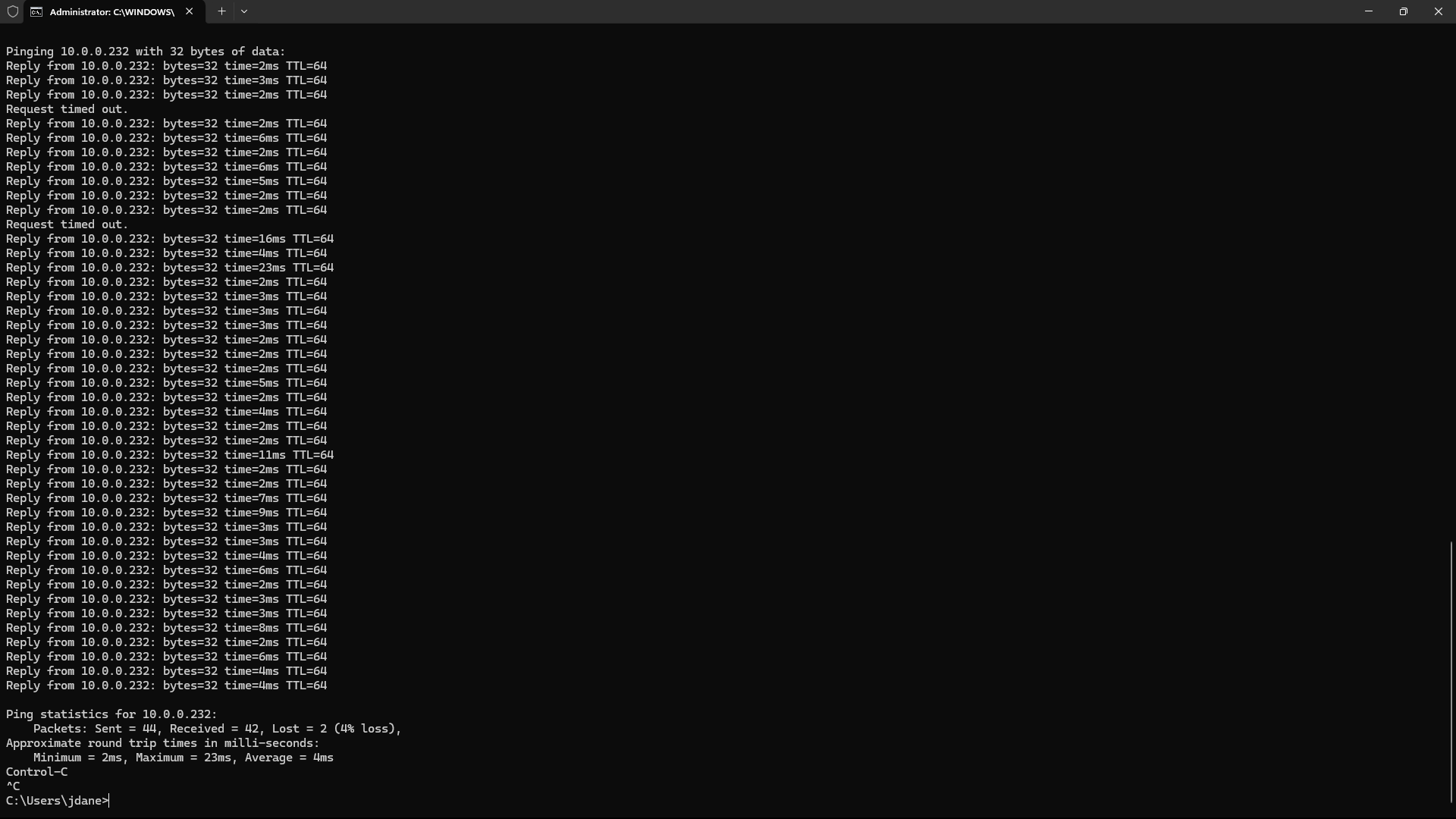

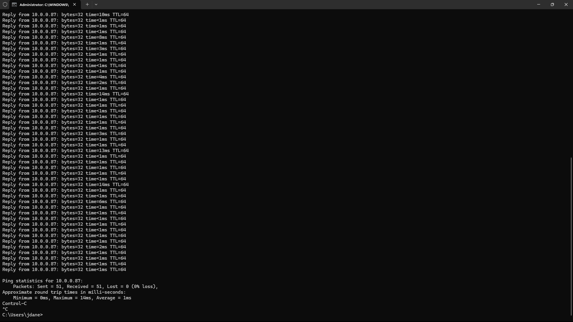

Computer used to access NVR is that wired or Wireless? If that is wired you might want to check your Network cables and or if you have an open port you might want to change the computer port test if that don't change then put it back where it was and move the NVR, Yet if that still don't change then it might be that your NVR is going bad. I know that before my 2108E-HS went bad on the ethernet it was starting to have packet losses. Yours so far has lasted longer then my NVR did before I had to repair it.. All cameras connected to POE ports worked fine, Only cameras connected over Ethernet and I was not able to access it in the end. Once repaired it was back working as expected...
So doing a ping from my office, I can see what devices are closer in my network and what ones have better connections then others. Looking at the pings the ones with higher return times are 3 switches away, Some of the switches I have setup in a way that it knows the pings are not prioritized so the traffic is held up. I can go into my Switches and change them to Critical and doing so I can reduce my Ping times.. So it hard to explain, Traffic at the last switch the cameras have their NVR and Ping times are 0 to 1max so traffic forward to me is reduced because I have other larger cameras that I give priority to seeing the NVR they are connected to are on my office switch.. So traffic to them cameras are critical and move better between the 3 switches..
When a AP or router is in play 3 switches away with a Wifi camera that is connected. i have it going to local to the router and at the router return time is 1 to 3 and says avg is 2ms.. However at my office that avg is upto 8ms and can change on days with high Wifi traffic in my neighborhood..
Loosing ping returns on the other hand means that the data isn't reaching the intended destination, resulting in a disrupted or unstable connection. Often causing lagging or glitches in activities like online gaming or streaming a video or video calls. In the case of working with DVR/NVRs can mean loss of packets that can keep a good video stream for our security cameras. Anyway this can be caused by Faulty hardware, poor signal strength.. Maybe issue with being in a large Wifi area where people are going over your wifi. Not meaning they are connected to it but their traffic is high and causing issues with others within the same channel...
to see picture fill size have to right click and view in new tab.
