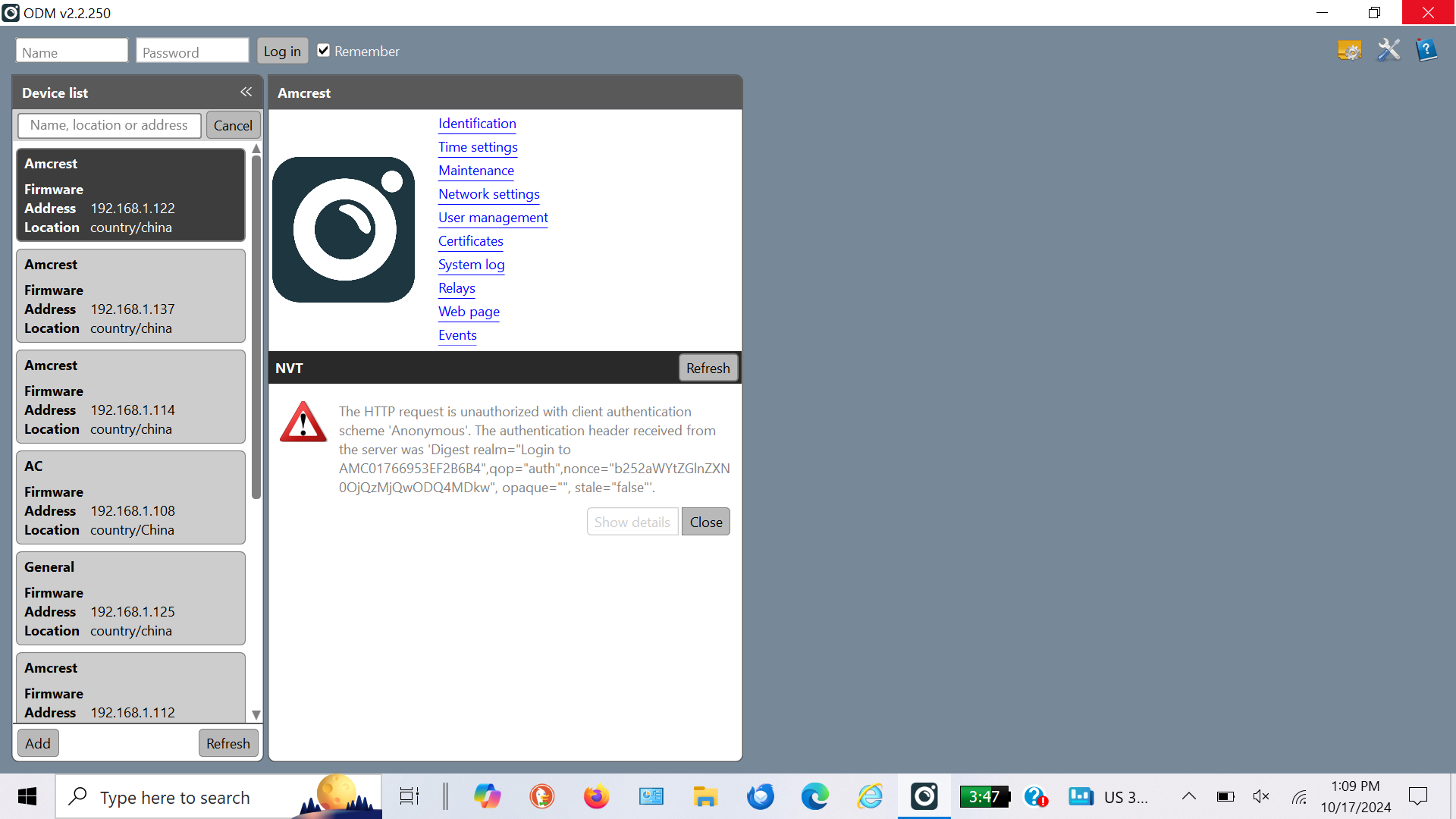

So I know it is hard sometimes but if you don't have ONVIF Device Manager. I would look at DL that from the web and at the top you enter your details and if it is correct it should let you look at your cameras like the picture below.. Only way I know outside of setting up ASP or Deleting it the app and adding it back to confirm that you really have the details correct. Main problem with App devices like the Smart Home products is once you setup you never have to worry about the password and even though you might have thought you setup it up right, maybe the password has something out of place for your 2 smart home products because it now seems that is only thing that isn't connecting and I don't have any issues making a connection to my AD110, my AD410, my ASH26, Ash47 and others to my Amcrest NVRs..

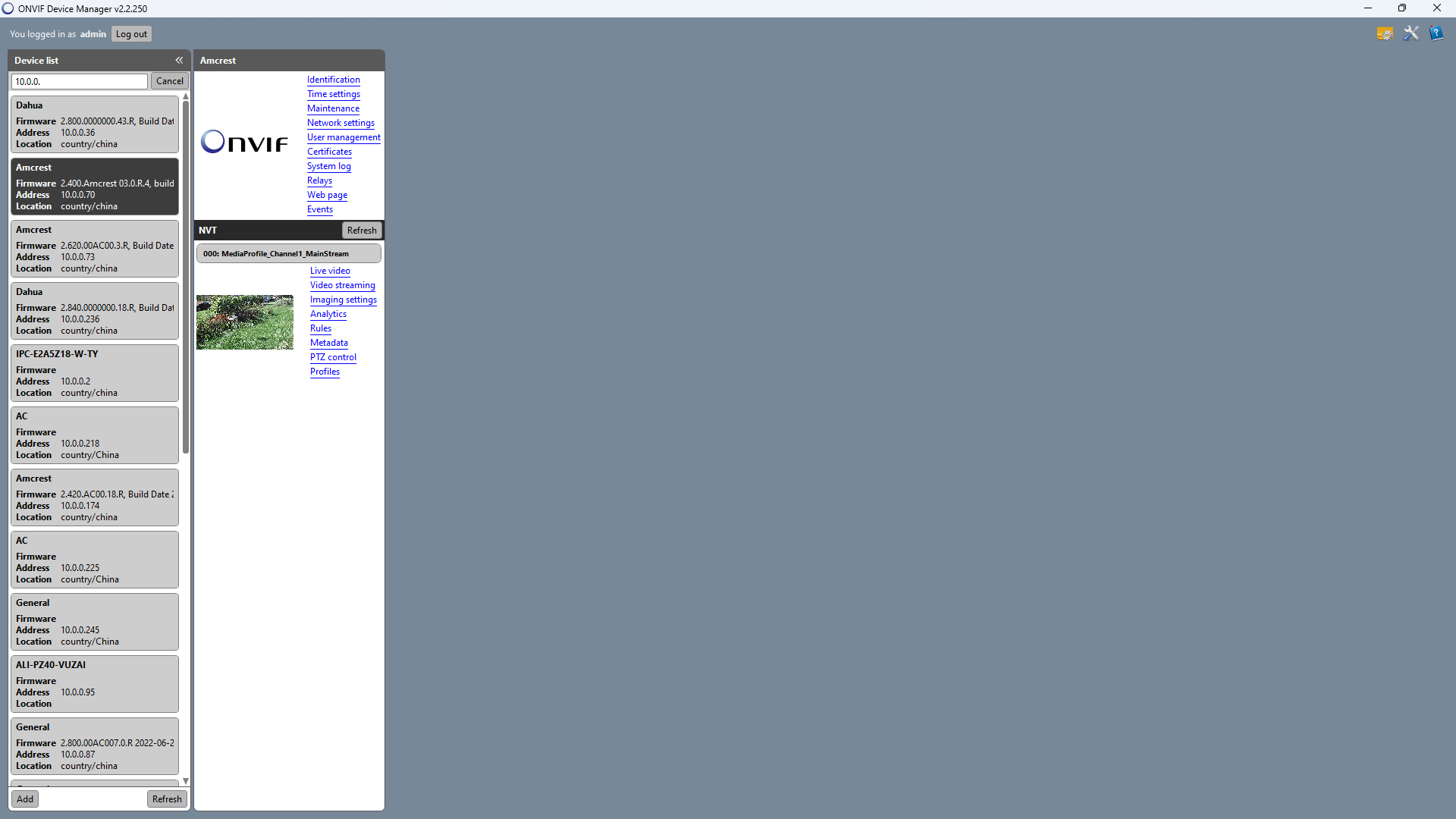

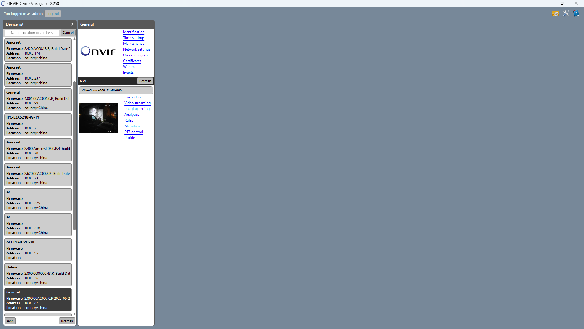

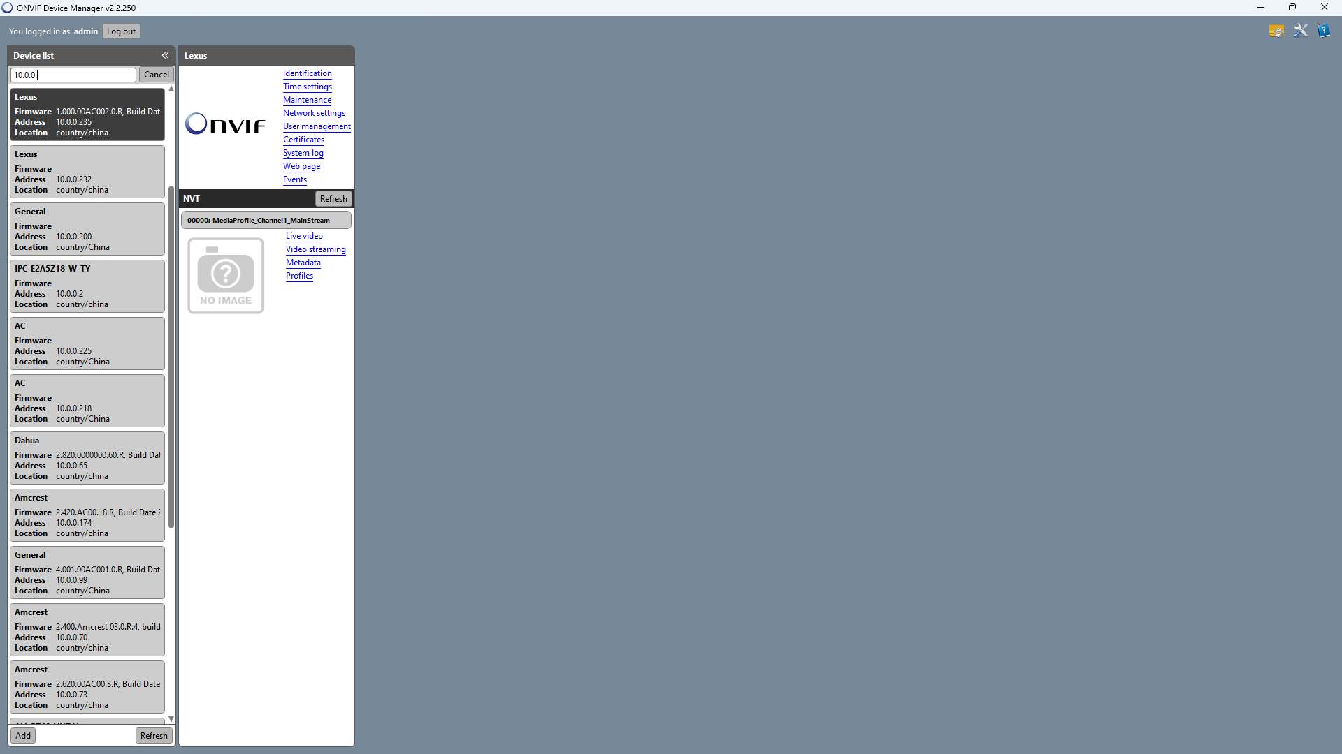

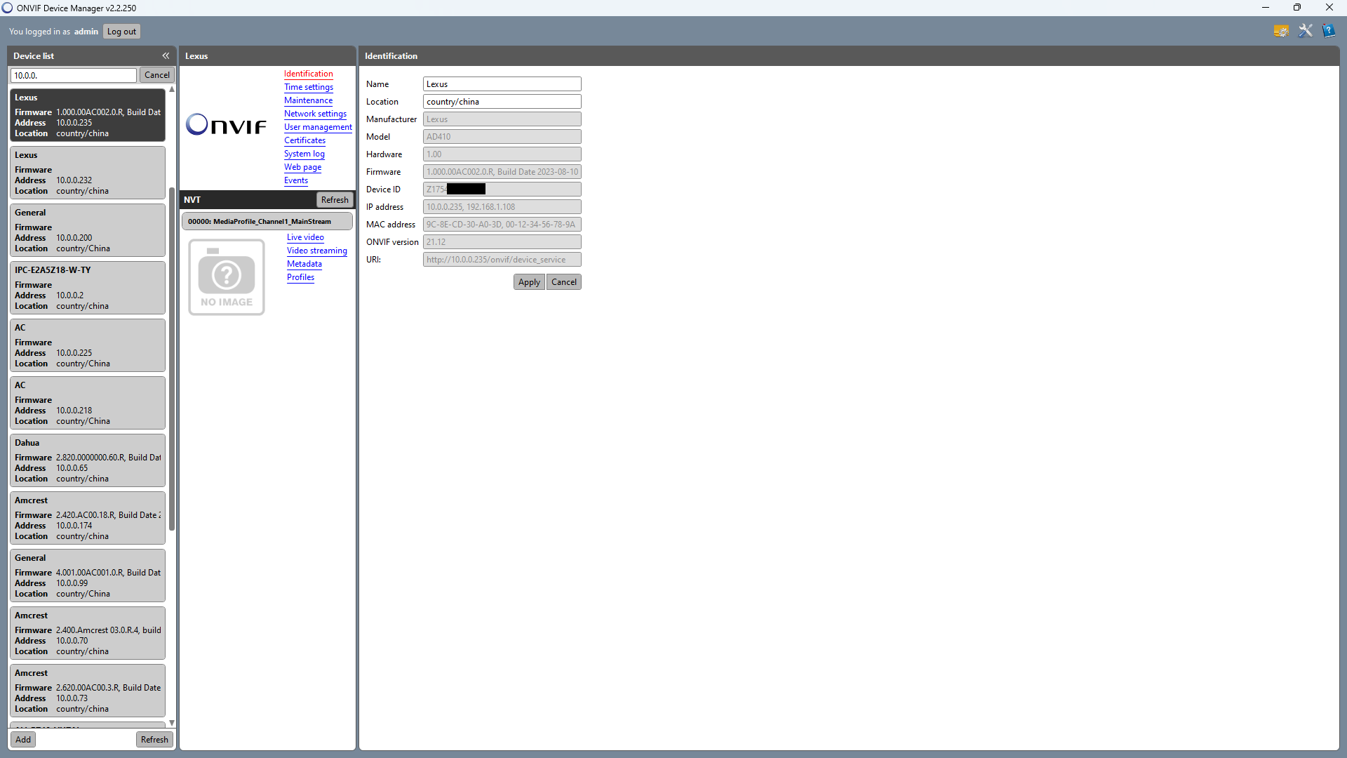

So something I wanted to show as well. If you look at the list on the Left, There are some that are there but have not data showing that is because the passwords are different then what is being used. If your cameras come up and don't show data then you might want to delete from Smarthome app and reset the cameras back to factory and setup again.. Also as you can see in the AD410 it has the data but no image that is because there is different ONVIF for the Doorbell but the data is there, SN, IP and Mac info.. So that says the passwords are good just Image for ONVIF isn't the same as other ONVIF IP cameras because it is really different...

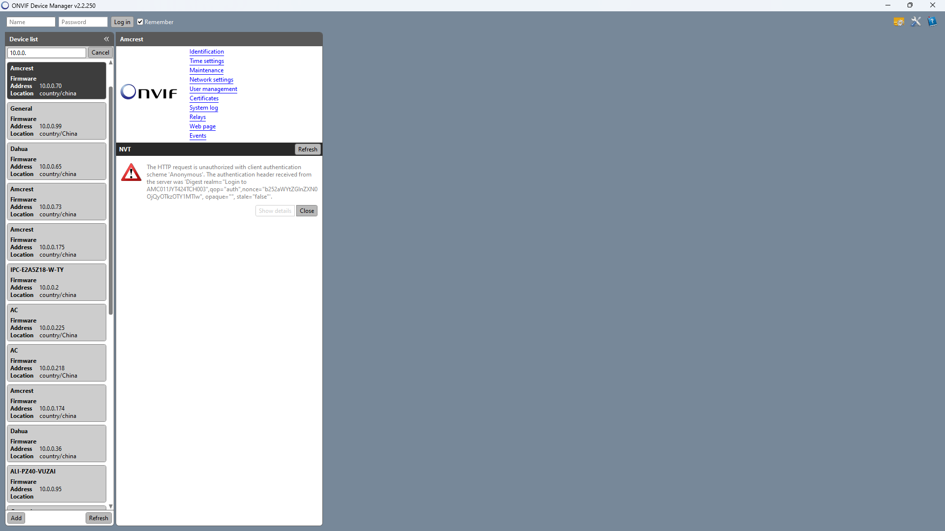

OK, I have Onvif installed, and I see the list of devices. But, if I click on any device it gives a message that is not clear. Maybe it is asking about a password?

That is odd, At the top of the program left side where in mine it shows that it is logged in, If you don't add your user and password there it should get an error like my first picture here. Again right click the picture view in new tab for full sized image.. Anyway after I log in and click on the same camera you can see it shows a little picture. Can you post what your system is showing?

OK, here is what I see.

Yes at that top left is where you add in your user name aka admin and the password then click login. Once you log in you should see just like my second picture when you click on the cameras in your list.

I don't have a username or password. And admin admin doesn't work. The download page did mention needing some other app installed.
