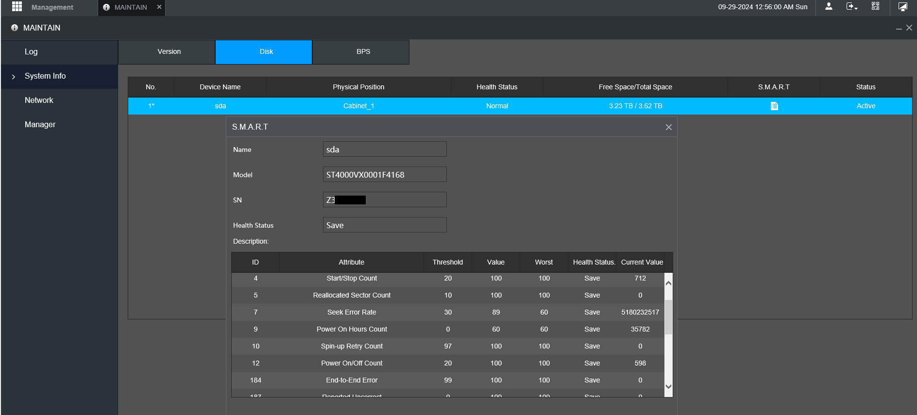

So tonight I looked at another system that had a abnormal reboot this was an hour after it normally would reboot and now seems that I need to replace this one before my other 6tb one lol.. Looking at this it only has 35k plus hours of use. You can see this is a Seagate HDD and is a Security HDD so I am not sure why it is failing so soon. You can see in the Smart info area it don't say healthy it now says SAVE and this HDD is now going to get changed out.
Thought I would update on what I know about one of my own systems. This might not be how it would work for everyone. But if your HDD does have these issues it really needs to be replaced..
