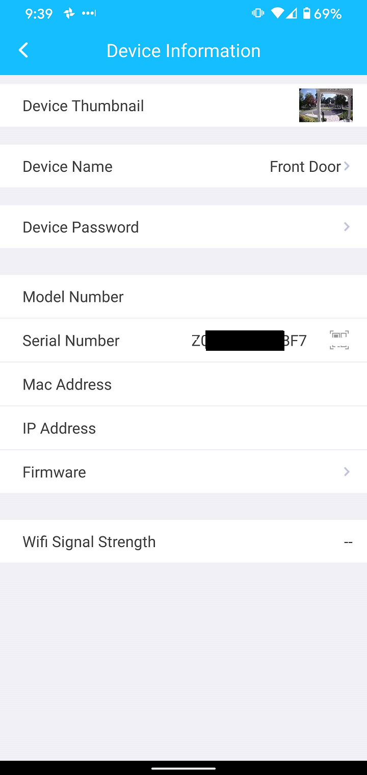

amcrest168 wrote: ↑Tue Jun 23, 2020 7:30 am there is no need to use the ipconfig tool to look for the doorbell's ip address. the smart home app shows the ip address of the doorbell under device information. i have always relied on dhcp reservations on devices where i need to access via their ip addresses hence no guessing as i routinely swap out routers to rebuild their custom firmware.
If the smart home app displayed the IP address of an offline camera, I wouldn't have this issue.

there was a botched firmware rollout that resulted in the doorbell being disconnected from the smart home app even when the doorbell is online. like i said before, i have always relied on dhcp reservation hence all i had to do was to preform a hard reset and reconnect the doorbell back to the app. in the recent botched firmware rollout where my doorbell was showing offline in the smart home app, nvr recording and vlc media player rtsp streaming also worked fine. install your 16v 30va transformer first and see if anything changes. i have a feeling you might have bricked the doorbell because of the ipconfig tool.
