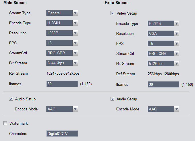

I was getting play error for a long time and could not see live view on smarthome app. As trial and error I went to Amcrest surveillance pro software that was configured on my lap top when I installed the door bell and tried to change the encoding what I saw was configured to custom, than I change it to 6144kbps and tried the smart home app to see the live. that worked so my opinion that smarthome app is not capabale of handling all the setting in it.
here is the setting that I made through Amcrest surveillance pro software worked.
