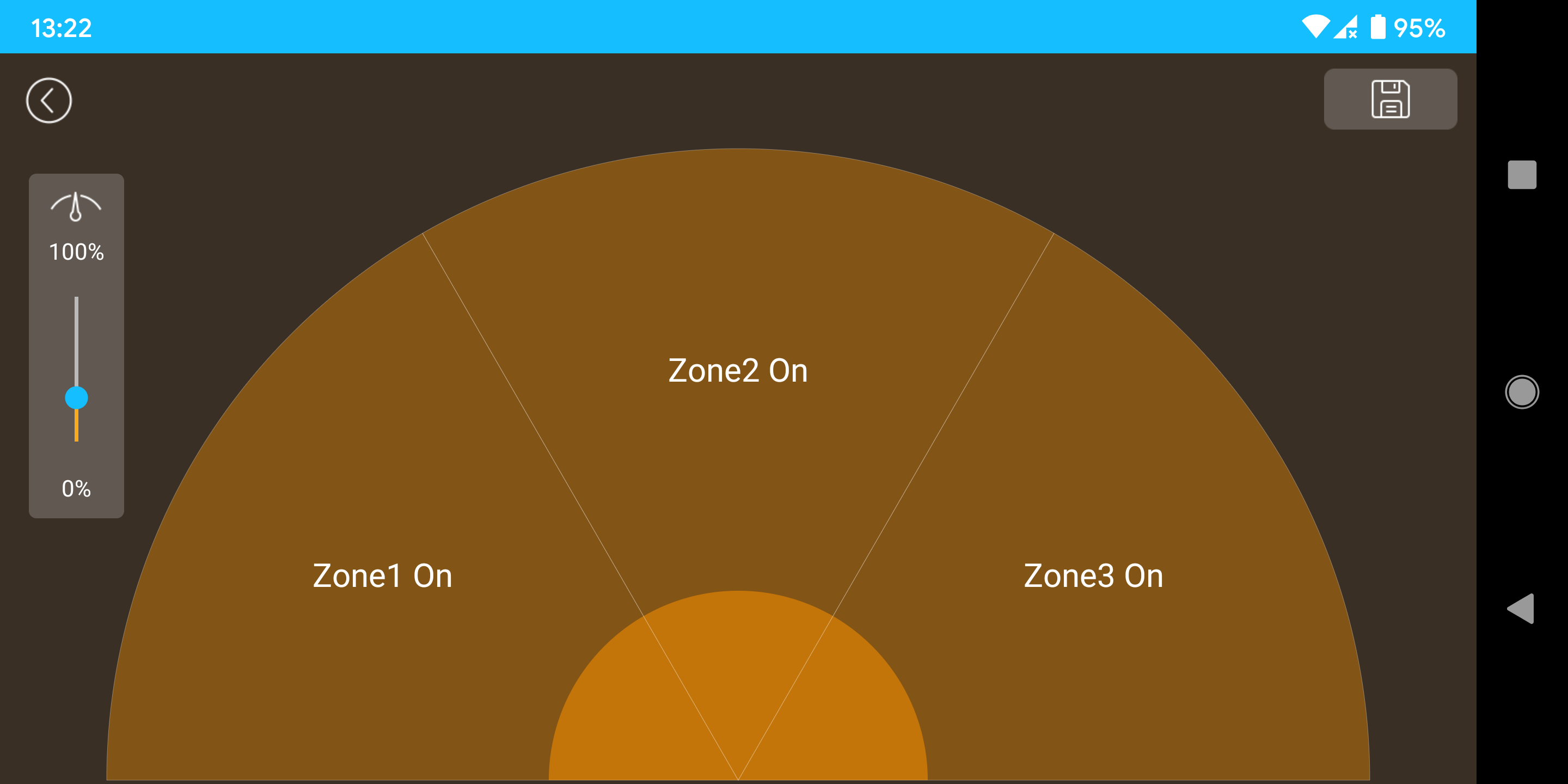

Another note for everyone: with the new update, V1.000.00AC006.0.R.20200828, I now see the app removed the motion detection drawing ability. Now you only have three zones you can choose to be on or off and a range option.
Perhaps the app was updated at the same time? I don't think this functionality is on the camera, but maybe it is? This wasn't in the change log for this update.
