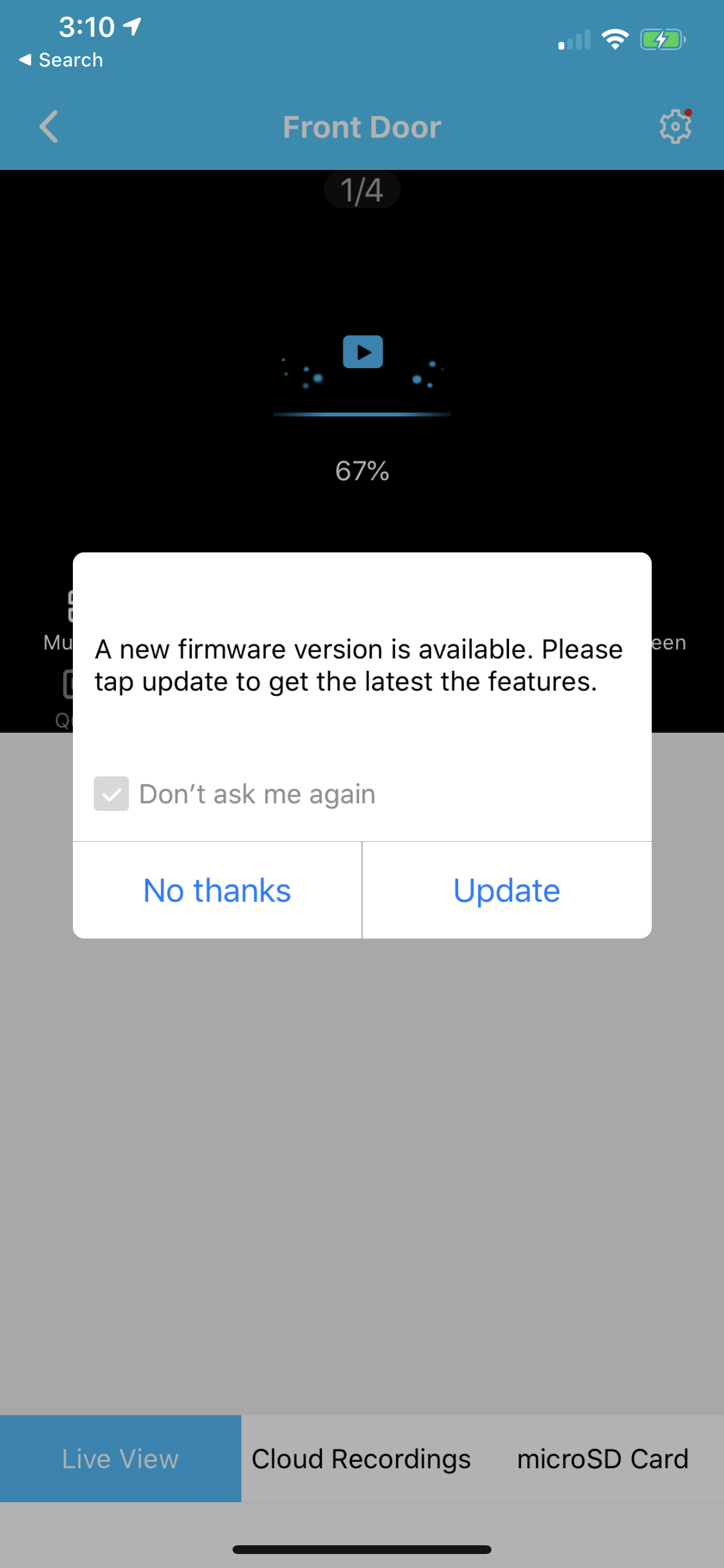

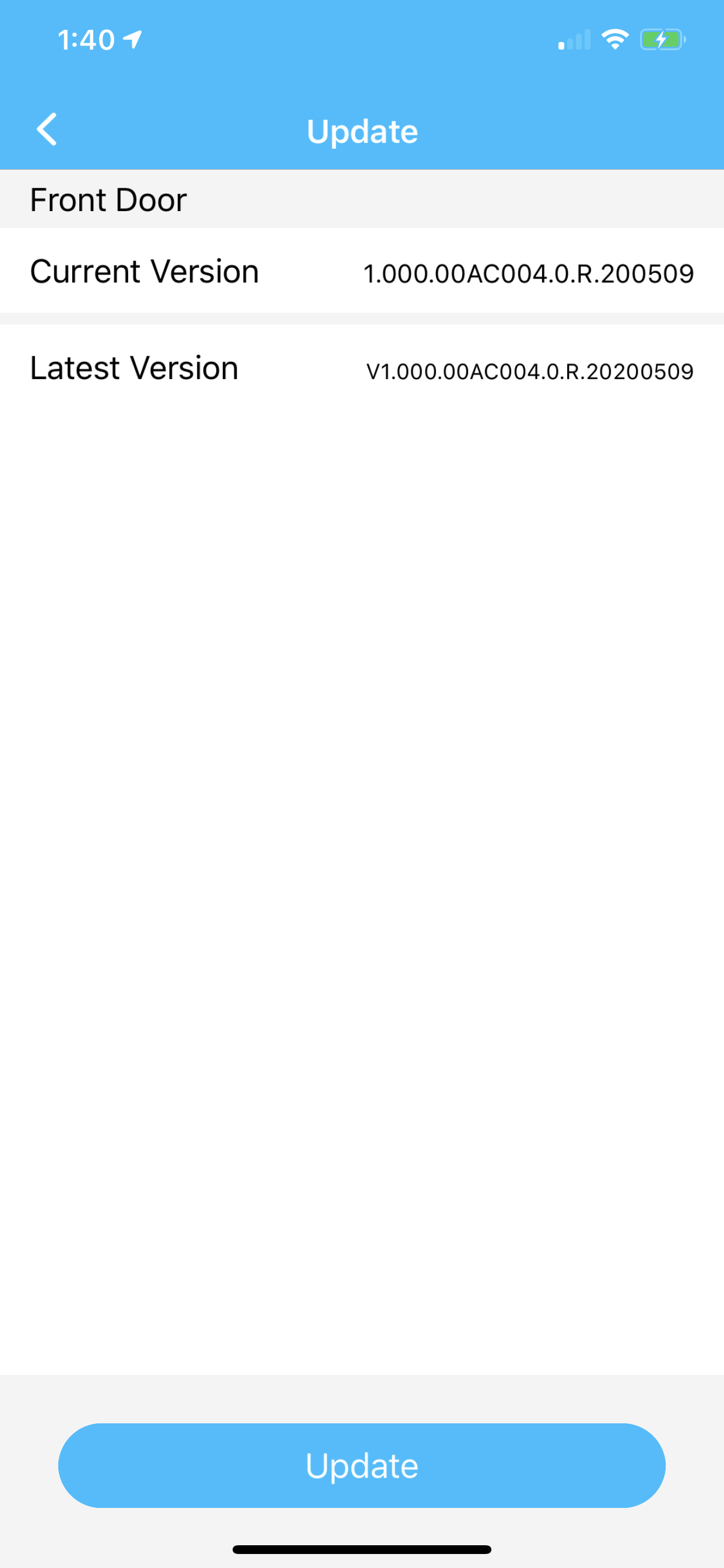

Updated Firmware successfully, but in doorbell it is identified as "1.000.00AC004.0.R.200509" (note the missing "V" at the front and missing "20" after "R.") rather than "V1.000.00AC004.0.R.20200509" Thus, each time it reboots from the update the app thinks that there is still a newer firmware update to perform and prompts again. This repeats endlessly.

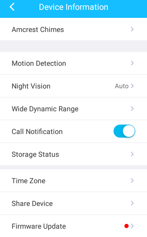

How did this not get caught in testing??? Your own screen capture above mine shows the same thing - the red dot next to firmware indicates that the app believes there is a newer version still available!!!

@djsteve i would wait until amcrest releases a newer version that is dated after 0509 before updating the firmware again. i'm glad to see at least the night vision, wdr, and motion schedule were addressed in this release albeit the firmware numbering issue.

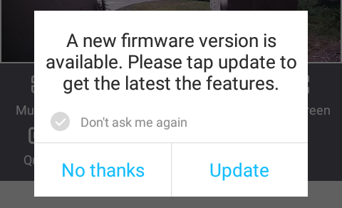

i think this firmware release is an improvement but it's an obvious 'work in progress.' i also changed the night vision setting from 'auto' to 'off' and it got disconnected and rebooted. i immediately changed the night vision setting back to 'auto' out of fear i might brick the doorbell. recorded videos can now be downloaded from the sd card but i think that has more to do with the smart home app and not the firmware. the wdr setting is a nice feature but it produces grainier videos maybe a setting of '1' is fine. '3' is visibly grainy.
also noticed a change to the link digital/mechanical chime setting. there is a configurable setting for digital chime in 'seconds.' amcrest still needs to fix the firmware version numbering. there is an option to stop the prompt by checking the 'don't ask me again.'
