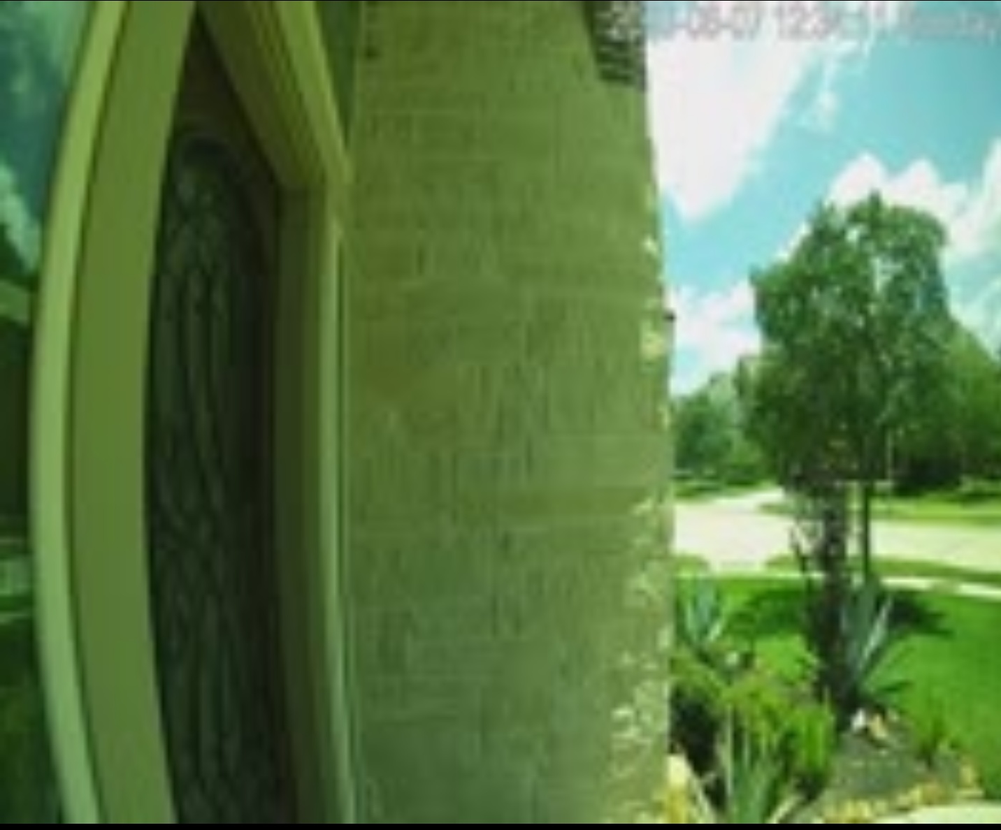

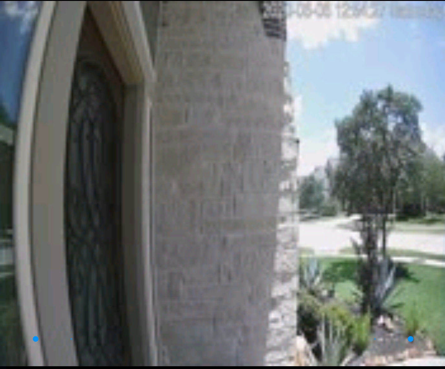

I can also report my camera shows a yellowish hue post-update. The video playback is also broken, always directs you to Live View... Not sure how such firmware can be released.
Pre update:
Post update:

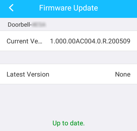

it appears amcrest has a solution to the false firmware update notification.

I am not sure why or what happened but mine was showing a Purplish color to the camera for the first couple of days.. Odd thing is that I reset the camera doorbell at the camera and for the next day the problem was still there. Then today the strange colors are no longer there and I have not done anything different or made any changes to the doorbell camera...
I don't know if you did a Factory reset at the camera or not but I would give that a Try and see if that makes your color issue go away.. Like I said for some strange reason after update and reset the color issue was there for a day or less...
Happy to say that the issue with FW update being offered even though we had the right one loaded is gone..

hi @catboxer and welcome to the forum. it appears your blue iris must have inadvertently modified the doorbell's configuration. the doorbell is designed to work with the smart home app and you're not suppose to use any third party app's control with the doorbell. my suggestion is to temporarily remove the doorbell from bi and perform a hard reset and set up the doorbell with the smart home app as your baseline. add back to bi but only for recording and don't touch any of the bi app control because it may be corrupting the doorbell configuration.
Re: AD110 firmware v1.000.00AC004.0.R.20200509
@Revo2Maxx Thanks for the suggestion. In parallel, I'd written to Amcrest's support and they suggested the same thing. Bit annoying having to go through the hard reset process, but it ultimately did correct the hue issue.
