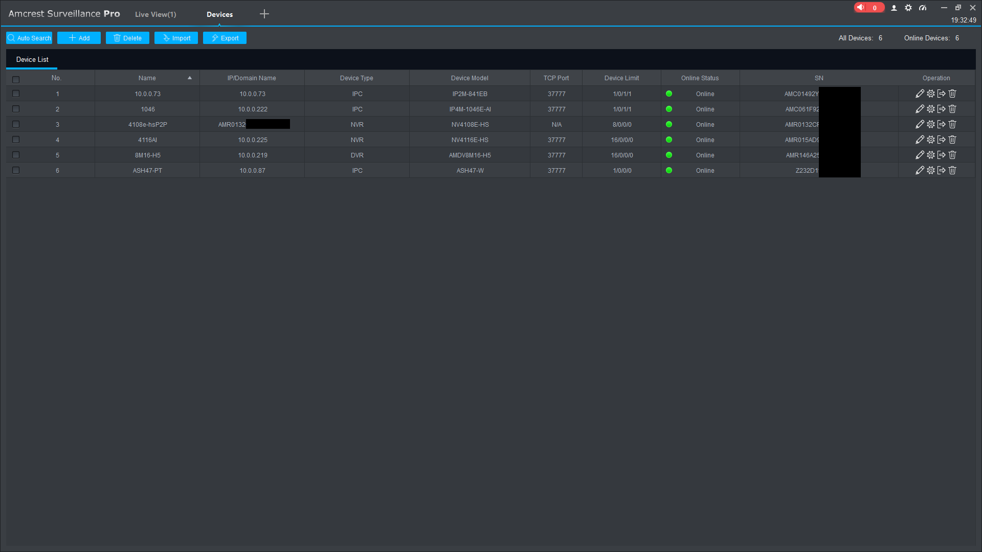

Yeah if the P2P is online and you can't access it after being able to. This is all different issue then a Firewall issue. Some times the Firewall with P2P don't even matter because the P2P punches though it without intervention however there are some ports that can be closed in your ISP or even your phone service provider. This could be an issue where the routers need to be rebooted or something.
Personally if I have an issue and there are times I will admit that I do, I found most cases I reboot my computer if I am using ASP and have issue. or reboot my phone if using AVP and I can then connect again. If I can't and I happen to be at the location of fault I reboot the Router and my connection is restored.
This can also be a Location issue from time to time. However this would normally show your P2P is Offline and then would be related to the servers being down. Either for repair or maybe just needing a reboot. However as I said I am able to access my DVR/NVR/Cameras that I have setup P2P so then the next issue would be that maybe the DVR/NVR or Camera was setup in the AVP or ASP in what would be Local Only (IP Mode) you want to make sure that you are setting up your Devices in P2P mode scanning the QR Code on the p2P page of your devices page or the SN on the Device it self. If setup using Ip then you are limited to connection on local area network only or over WAN connection if setup to do so.
YOu can tell in AVP or ASP if the connection was local if it shows the IP of the Device and not the SN.. Like the pictures below

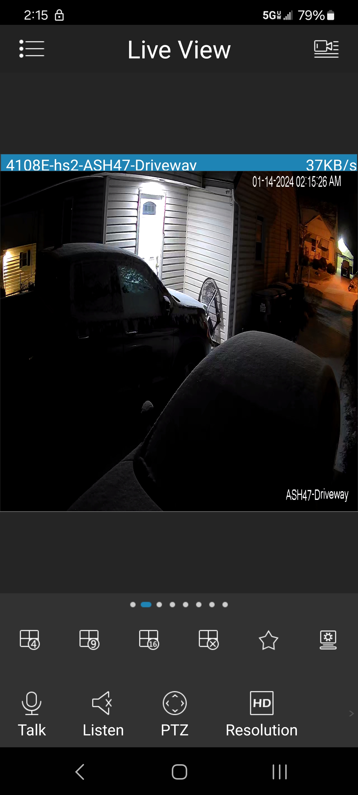

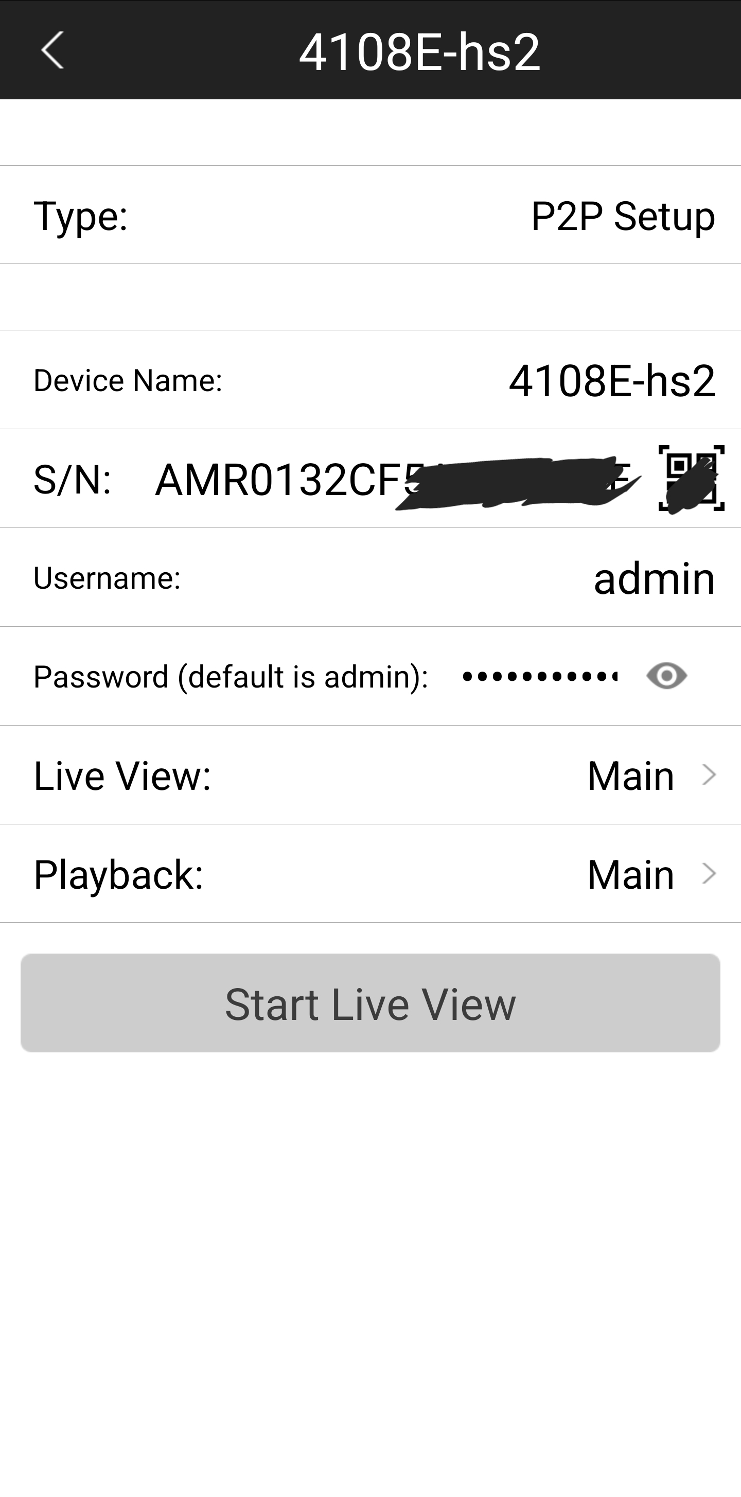

So a couple of things. First it is hard to tell why a connection isn't working. I will admit just now tried to connect using my Cell phone on the Cell network and it timed out. So I rebooted my phone and tried again. First time I tried it was trying to connect at 4g After the reboot it was able to connect on 5G. So not sure what or why however most times when the system don't connect I reboot my phone.
However if there is more of an issue and could be related to network link between your connecting device and your DVR's network. So then the best thing to try is clicking the button on the top left then Device Management, click the device you want to work with, then pencil, Then in the area where it says how you want your Live View, Try changing from Main to Sub then click Start Live View at the bottom.
Also there is no connection to a Server when you are connecting P2P. Only thing the Server is used for is a Link to your device. The connection is from your device to the DVR and there is nothing between.
So what would I do? I would Reboot your Router/Modem, Reboot your Phone or computer if use ASP. Here is my device and connection via 5g on my cell

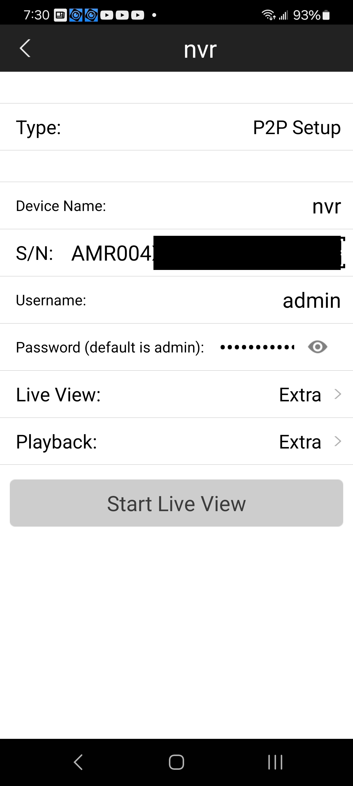

Re: unable to connect to NVR using P2P from outside.
Thank you for the reply.
I did try to change Live View from Main to Extra (no sub option on my device) resulting in no change.
We have rebooted phones/routers/DVRs/modems in all locations without success.
