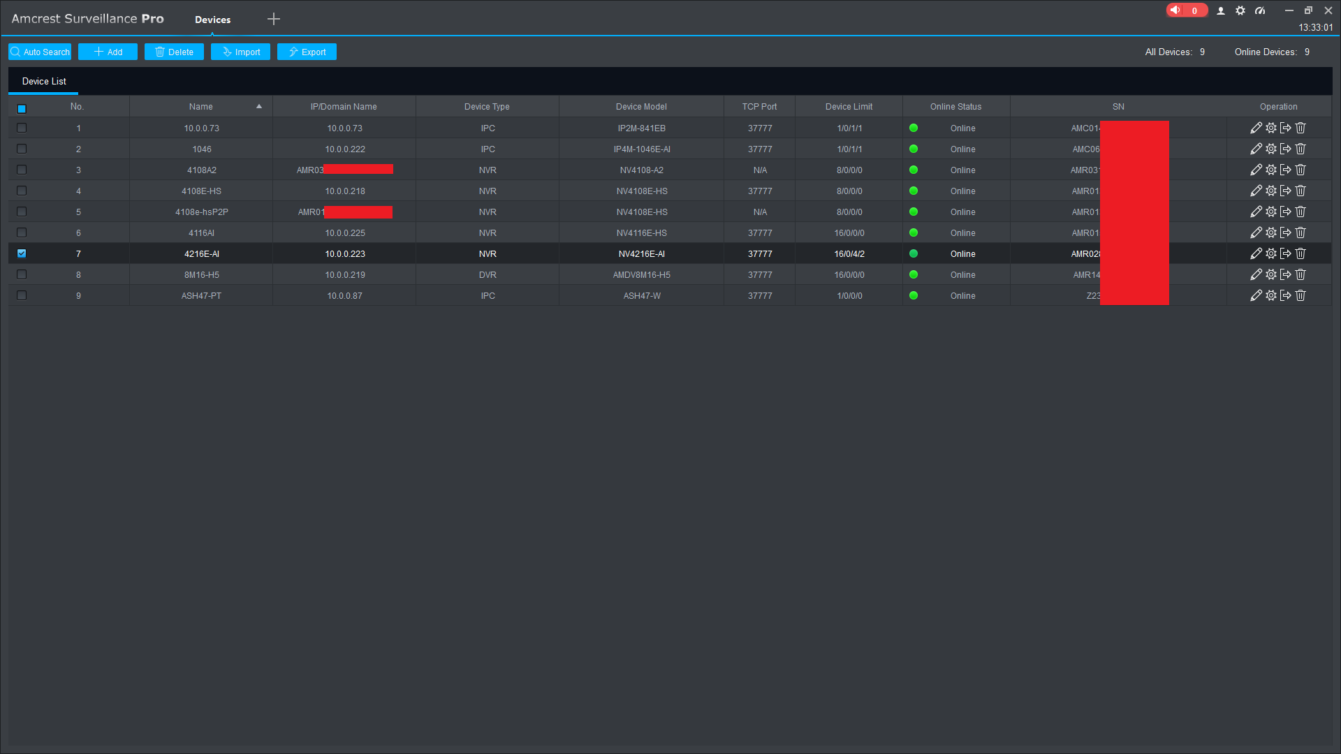

2 NVRs on site, one of the NVR can be seen outside of the local network but the other can not. Both of these NVRs were installed via P2P on the owners cell phone and our cell phones, different providers. One of the NVRs shows outdoor cameras, the other show indoors. Only the indoor once can be seen outside of the local network, while the outdoor does not. When on-site, we can see both through the app since we are on the local network, but they would like to see it when they are home if an alarm has been set off.
Same issue when I use Amcrest Surveillance Pro program on my office computer (outside of local network). I was able to see both NVRs but now I can only see the indoor.
I also noticed that if I have my VPN active and connected to a different state (outside of the site where the NVRs are located), I can pull up Amcrest Surveillance Pro program and can view all of the NVRs. Which makes me believe it is what others here have been saying, that maybe one of the servers nearby that the P2P has connected to is offline or they ran an update that now does not allow connection.
Re: unable to connect to NVR using P2P from outside.
Servers don't do anything other then being a Place Holder for Pings. What I mean. When you setup a P2P a server is contacted and (If NVR shows ONLINE) then it is doing its job... Then when the user either a Cell phone or computer using ASP makes a Connection the device makes a request and the server that has been listening says YES I have that PID/SID and here is your Connection.. Out side of that there is no Server Function. The Server has no ability to see the feed or even know what the P2P device is. It only knows that a Device is asking for Connection and if the Server has that it will hand off the connection to the Device... Can you please double check that Both machines are showing that they are Setup and showing ONLINE under P2P... Also So i am clear, There is no Extra Port changes nothing needs to be done seeing the NVRs should have their own IP address INTRANET all port info can and should be left as it was.. I have on my current network 7 recorders, and 1 Hikvision OEM DVR all setup with P2P and can access them all away from home on P2P via ASP/SmartPSS/DMSS in multi system connection and or AVP on my phones.
I would double check that your devices are setup using P2P format. Not just the NVR's are online but that the APP being used is setup in P2P format.. At times if I am going to fast I have setup in IP mode when I meant to have P2P setup.. Device will need to be removed and added back using right format... Also if using ATT that could be an issue as well.. Android and iOS it seems both are having issues using ATT..
Screenshot (1263).png (74.28 KiB) Viewed 5798 times
