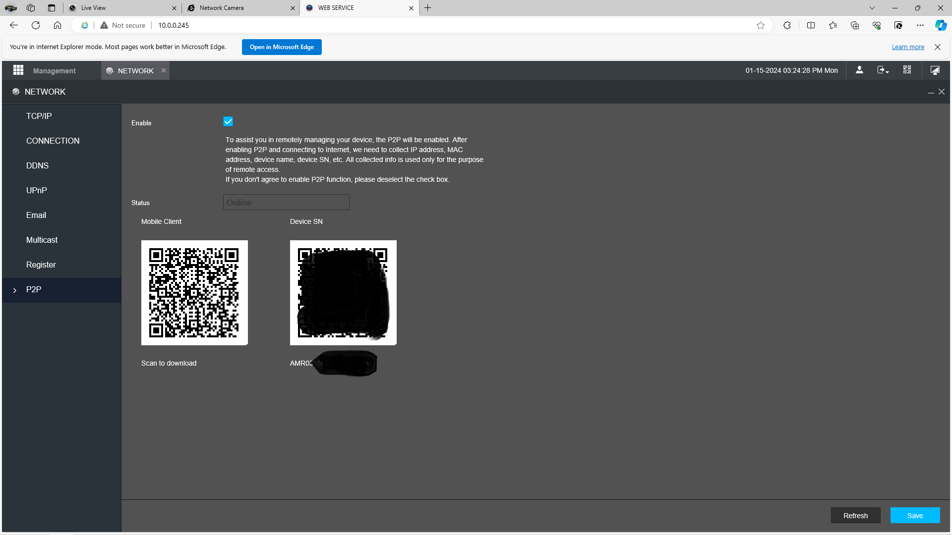

Next need to make sure that your DVR's have full access to the Internet, I am not talking about port forwarding or anything like that, I am talking about the router or firewall device isn't blocking any ports that are going to the device. TCP/UDP both should be open. Any Ip Filtering can be problematic if device IP's change over time. Next need to double check that each device is active and show they are online. You can look over GUI or WebUI under Network and P2P or Network, TCP/IP and P2P depending on the device FW date. If it is online and showing like picture below then last thing is that the App setup for the device needs to be setup using P2P method and not IP method. IP method would only work local to the device in same network as the DVR...
Screenshot (979).png (88.64 KiB) Viewed 9348 times

DVRs are set for P2P and show to be on line as indicated on the screen.
