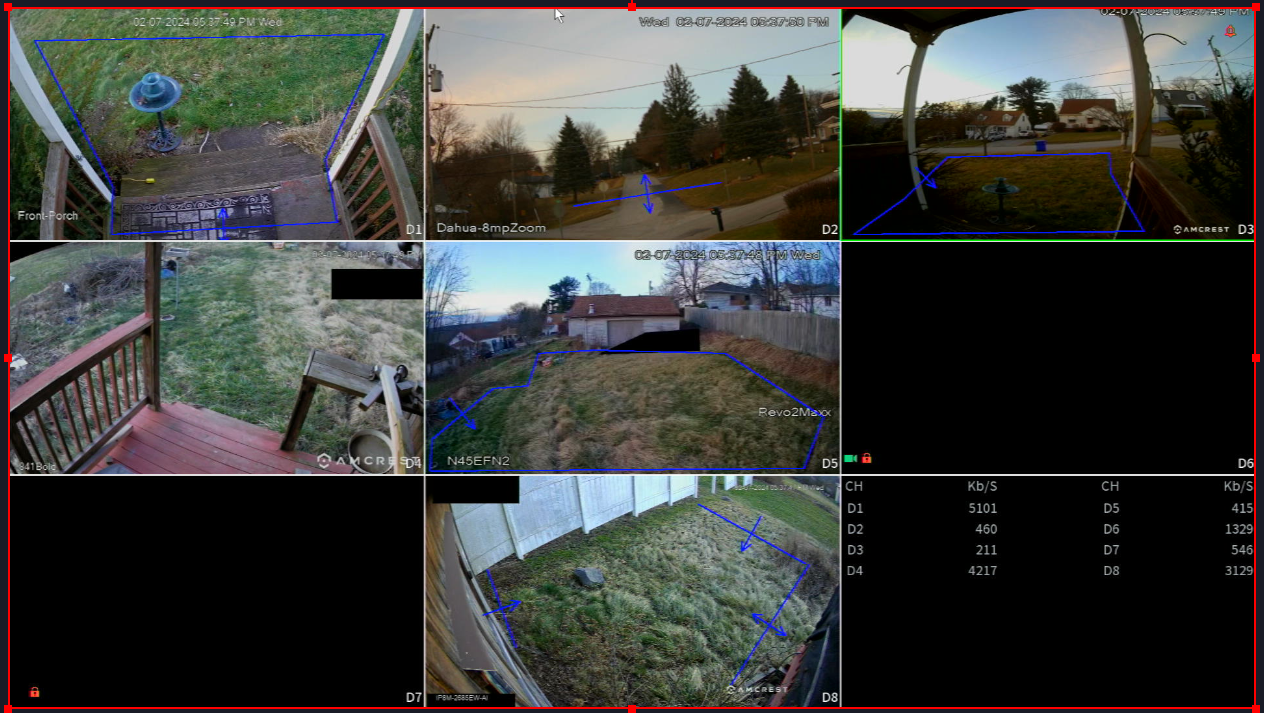

I am wondering if anyone can explain why when I have 7 ip cameras only 5 will show on my NVR monitor.
There is space for 8 cameras on the display. The spaces where the 2 cameras should show have red locks on them.

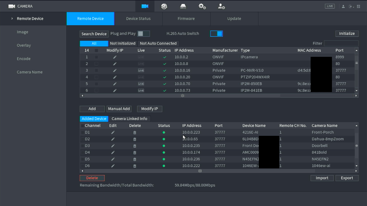

From the NVR click on bottom under Management, Camera. Then in there it should show how much bandwidth you have left See picture below. This is a 8ch NVR that has 8 channels. One of them is streaming a Remote RTSP feed even from one of my other properties.

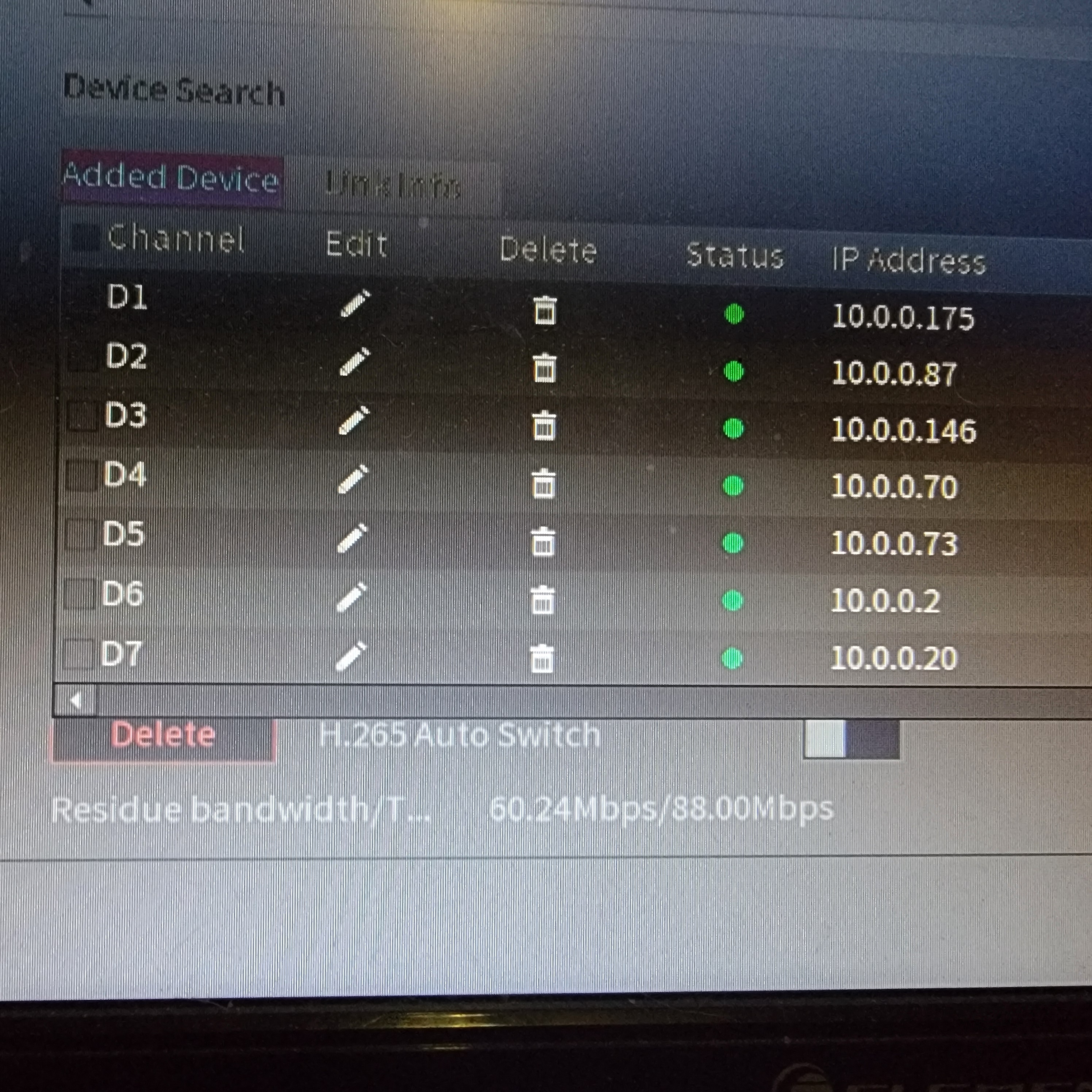

the residual is around 74 - 81 Mbps [fluctuates]
The total is 88 Mbps.

Although they sometimes show momentarily on an NVR restart, but soon only show a red lock on the monitor where they should be. Also, if I go into NVR settings and then leave these cams will show for a bit.

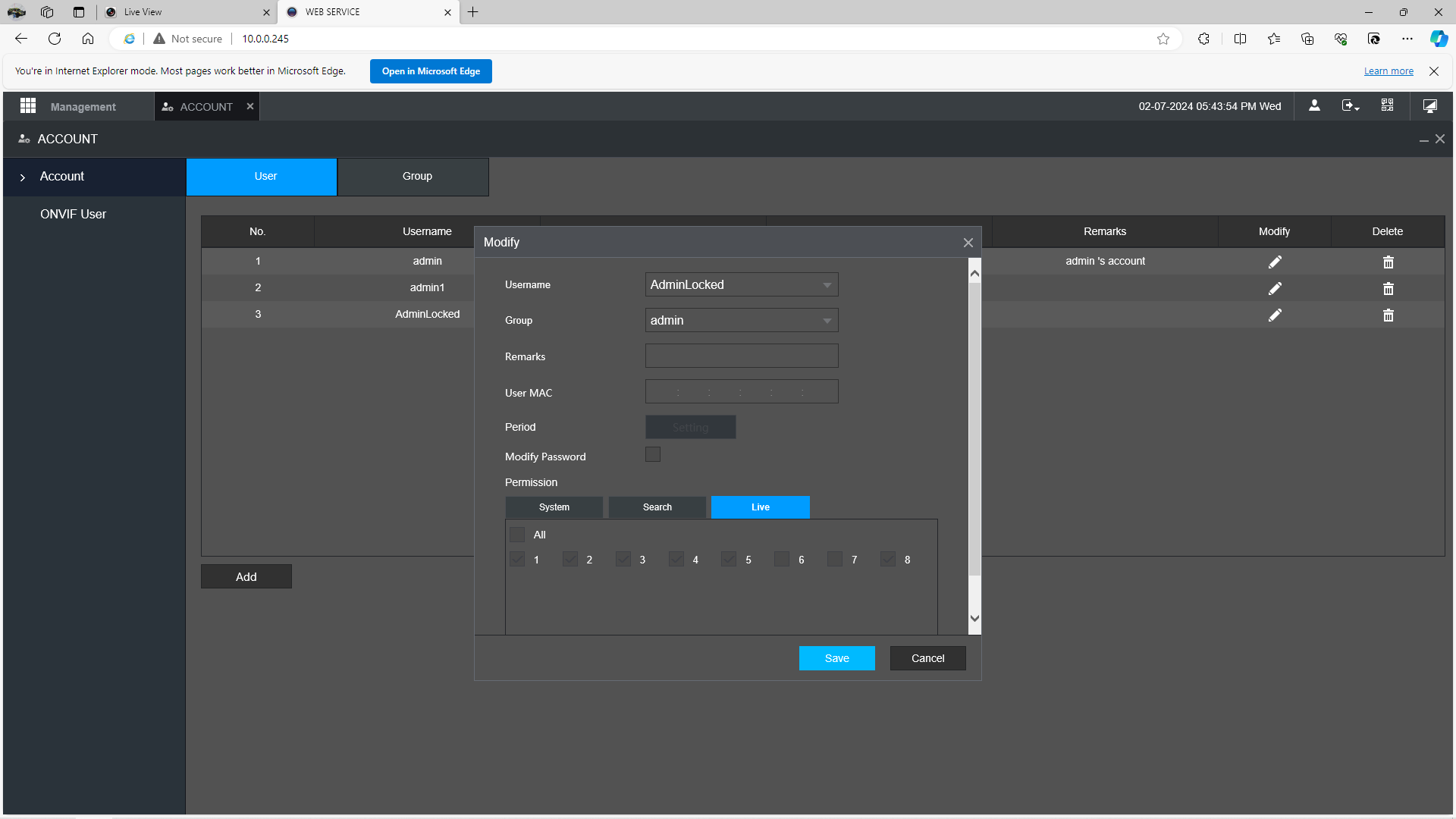

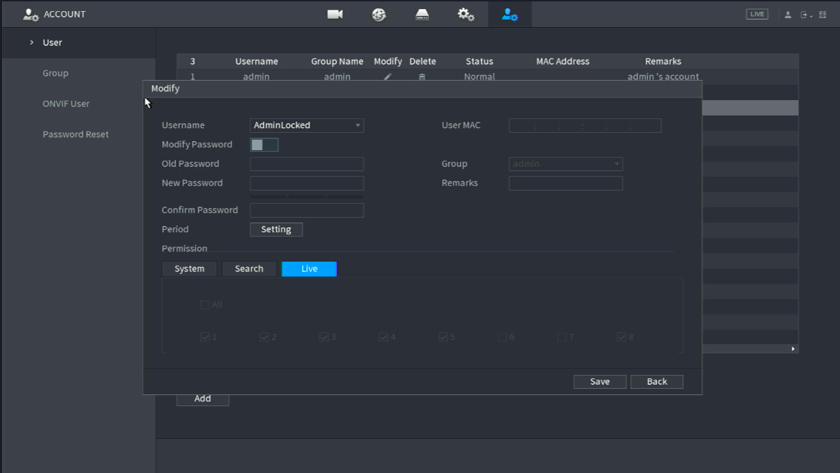

So here is what I get when i setup an account called AdminLocked, I then turned off 2 channels for live view. One of them is still showing that it is recording because on the main admin account it is recording. But outside of that is this what you are seeing?
Re: NVR problem
it is kind of hard to see however if you look in the info for D6 and D7 they are not checked Because I am logged in with AdminLocked account I can check them only the main admin can because when account was setup admin took away that right..

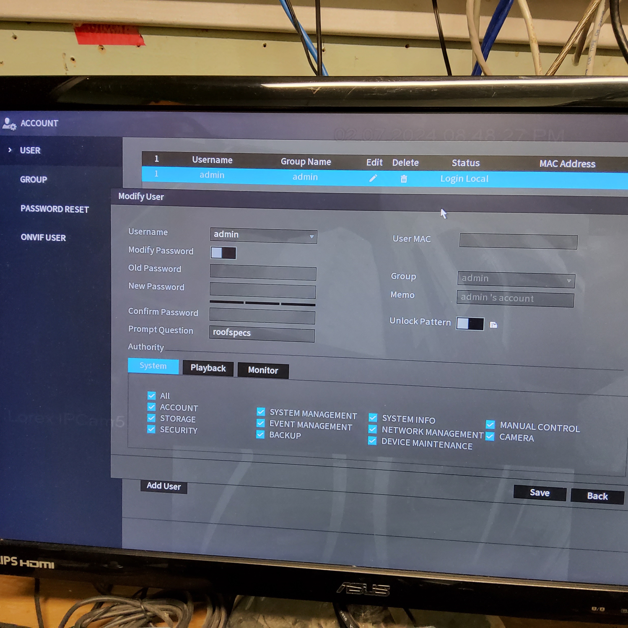

Under management>Account>User>Edit
It appears that all boxes are checked off for System, Playback and Monitor.
See picture [Account User.jpg]

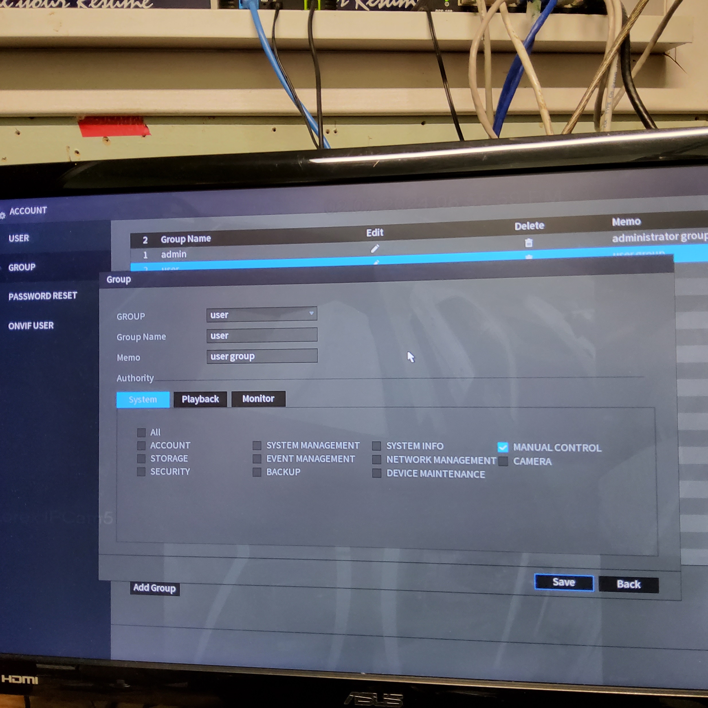

Under Management >Account> Group> Admin> Edit <<< It appears that all boxes are checked off for System, Playback and Monitor.
Under Management >Account> Group> User> Edit The only box checked is Manual Control under System and all boxes are checked for Playback and Monitor.
See picture [Account Group User.jpg]

Re: NVR problem
I see the pictures for admin and user don't see a picture showing that all the Monitor channels are checked.. Can you post that and a pick of the window in question with LOCK? and Picture of the camera remote window where it shows the loaded cameras. Mine says Live yours says Monitor same thing different FW
