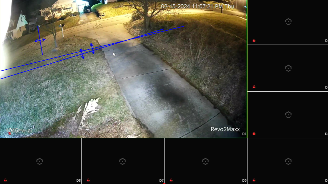

So I started answering this with pictures and it was just taking to long. So I thought i would just make a video, maybe it will help. About the lock, Pictures in the first page of the thread is only place I know where the locks can be found on my DVR/NVRs.
Also show in my Video what my 16ch looks like in 16ch mode without any cameras loaded in ch10-16 there are no locks. This whole thing with the Locks is throwing me off..
https://youtu.be/-Rf22QzP7fw
Re: NVR problem

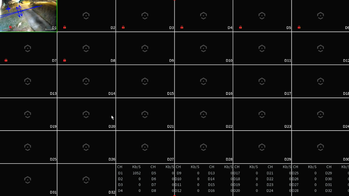

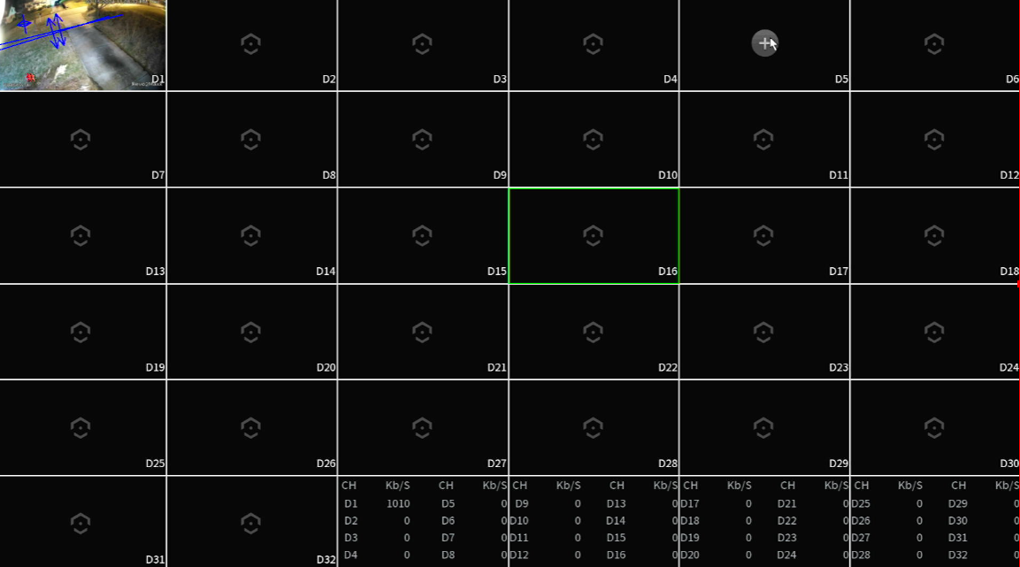

So I just reset my 32ch back to factory and setup 1 camera, My 1046EW-AI on it, Then I setup an account Revo2Maxx, I gave it permission to use ch1, removed 2-8 and the rest has permission. So Then I logged in, did 8ch so you could see better picture of the Locks. Then did 36 grid so you could see in grid view and then I logged out the Revo2Maxx user and took a snapshot.. In the last photo If i really wanted them removed I would have done it at the area of what to show when not logged in. So I am really thinking if you see them for a Min or 2 that is because in this setup it will show when the user is logged out, However as soon as Revo2Maxx logs in you will get the locks. I am wondering if that is when you get the locks is after you log in.. Like I said last picture is after I log out the Revo2Maxx and I have not even logged in the admin account yet.. Last Picture LOCKS are gone.. That is what it would look like when NVR reboots before admin logs in. Or Revo2Maxx in this case where I have them setup as removed..

Please note, are you using the Main Admin account? I just checked and I can't remove 1 or all or any of the Video Rights.. When I try it says I can't modify my own viewing rights. So then I thought Ok lets log back in Revo2Maxx that has admin rights and when I look it shows that the admin account has same cameras that are missing on mine meaning I can't remove them. However I can't remove any of them even with all of the channels added back in because it knows that that account is Main and as the Main admin it has GOD rights.. If you take away and then happen to remove your second admin account. The new admin account if you made one would have them missing channels as well..
If this is your NVR. I hate to say you are going to have to do 1 of two things.. First reset the NVR back to Factory. If that don't help you gain your cameras back after a Reset then if the NVR is still new *Meaning just bought from Auth Dealer* then you will want to setup a RMA for a Defective NVR.. If it isn't new and/or have no Warranty, then your NVR has an issue that isn't NORMAL and will have to live with it.. I don't have an Extra 4108-HS I gave mine away to another member. If I did, I would be willing to trade you a working one for your ODD BALL, However all I have left in my Fleet is POE NVR's and 2 that are not POE but are not an HS model. I mean I do have a LOW Hour 4108E-HS that I added to service after I gave my last 4108-HS away. I guess I would be willing to trade that as long as you are in the USA that is..
