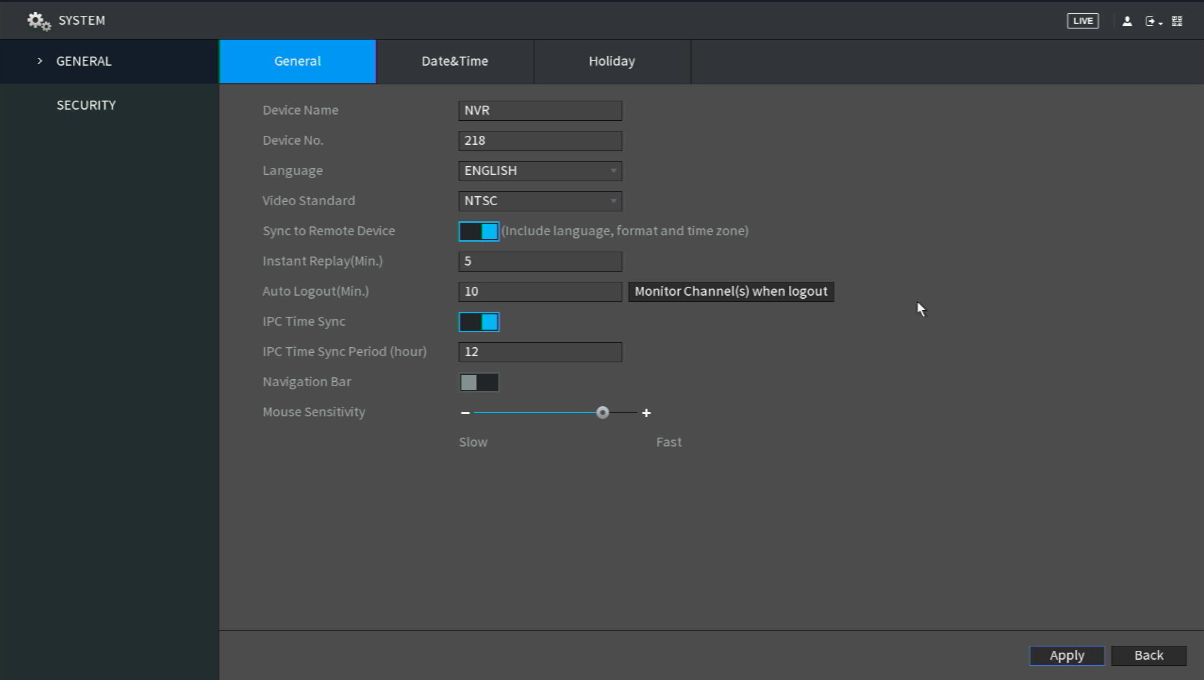

Re: NVR problem
Older and newer Amcrest NVR, so was just pointing out the difference, could have used different device but not cameras I normally post so just did one that didn't care if camera were posted.
So need to see 2 things, monitor page and display page to right of auto log out is another view area

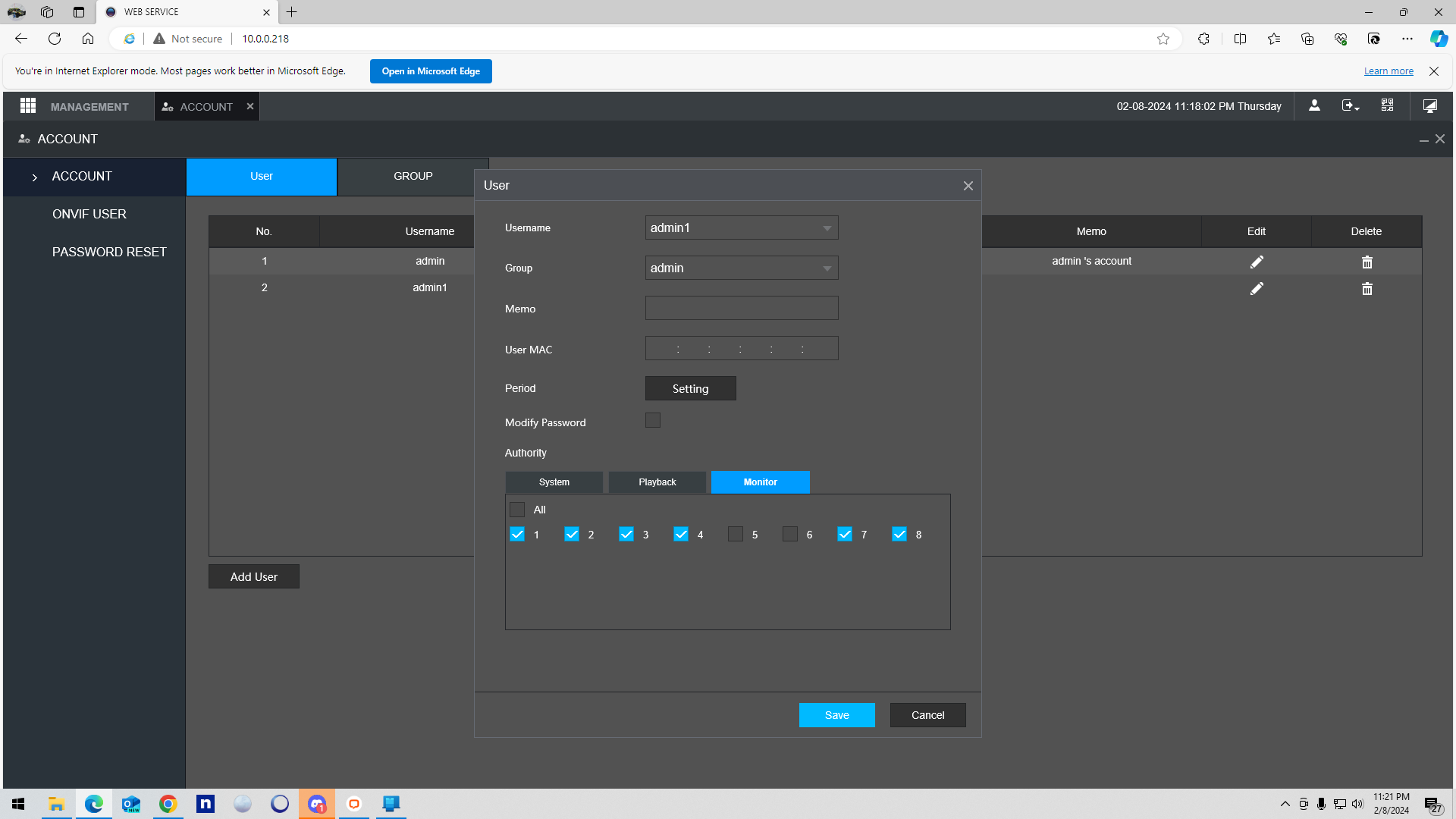

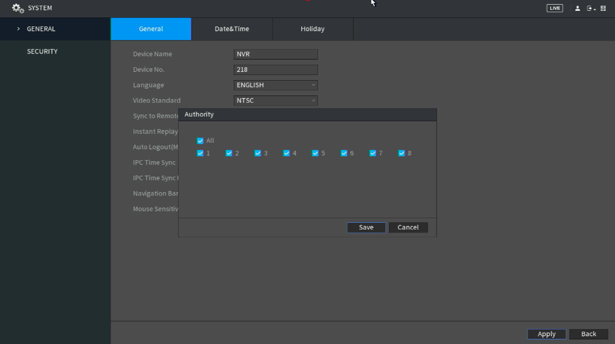

Here is a couple of pictures of what should look like yours.. Anyway in the one from before showing with Monitor, All should be checked and in the second under system should have all them checked as well.. First picture is off the WebUI the Other is from the GUI after I realized that WebUI don't have the info in second picture..

the trouble is:
When I go to System > General << I don't see anywhere to bring up the "Authority" screen, either under the WebGUI or GUI.
Is there something I need to change in settings to see Authority screen?
When I go to:
Account > User > Edit - ALL boxes are checked under Monitor.

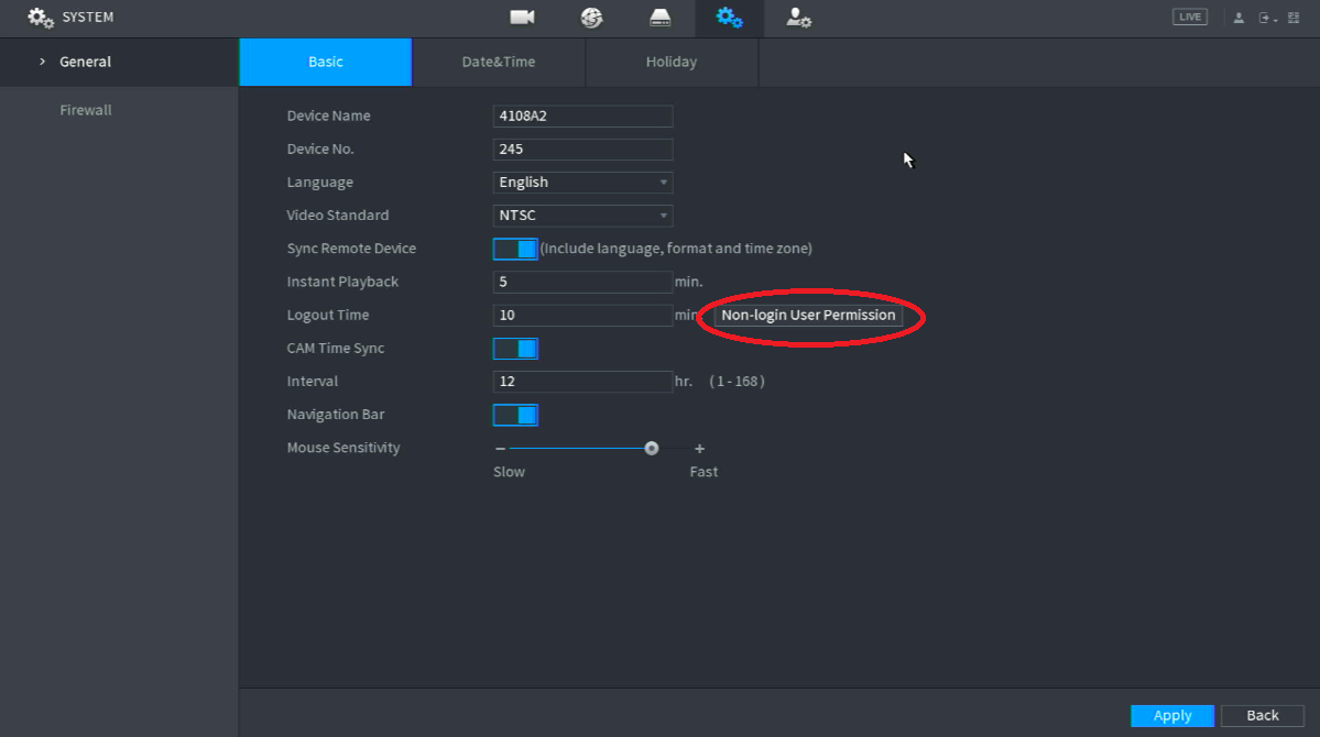

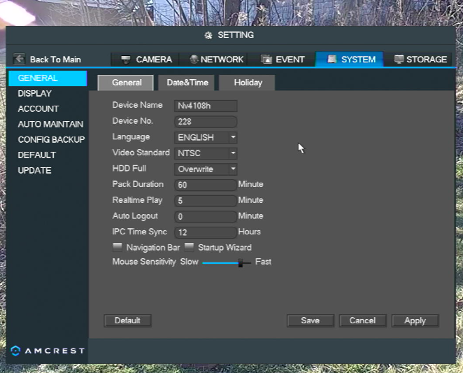

Re: NVR problem
Ok so I know you are saying that you are using a NV4108, It has been a while since I looked at the GUI of the 4108 normal aka 4108H 4108E NVRs. The Newer ones that I own 4108E-HS, 4108-A2 and all other NVRs that I own has that option so thoughts yours did as well.. If using the Normal it seems there is no access to that area in the GUI that I can remember and not placed where it is on newer ones as you can see in the pictures below..

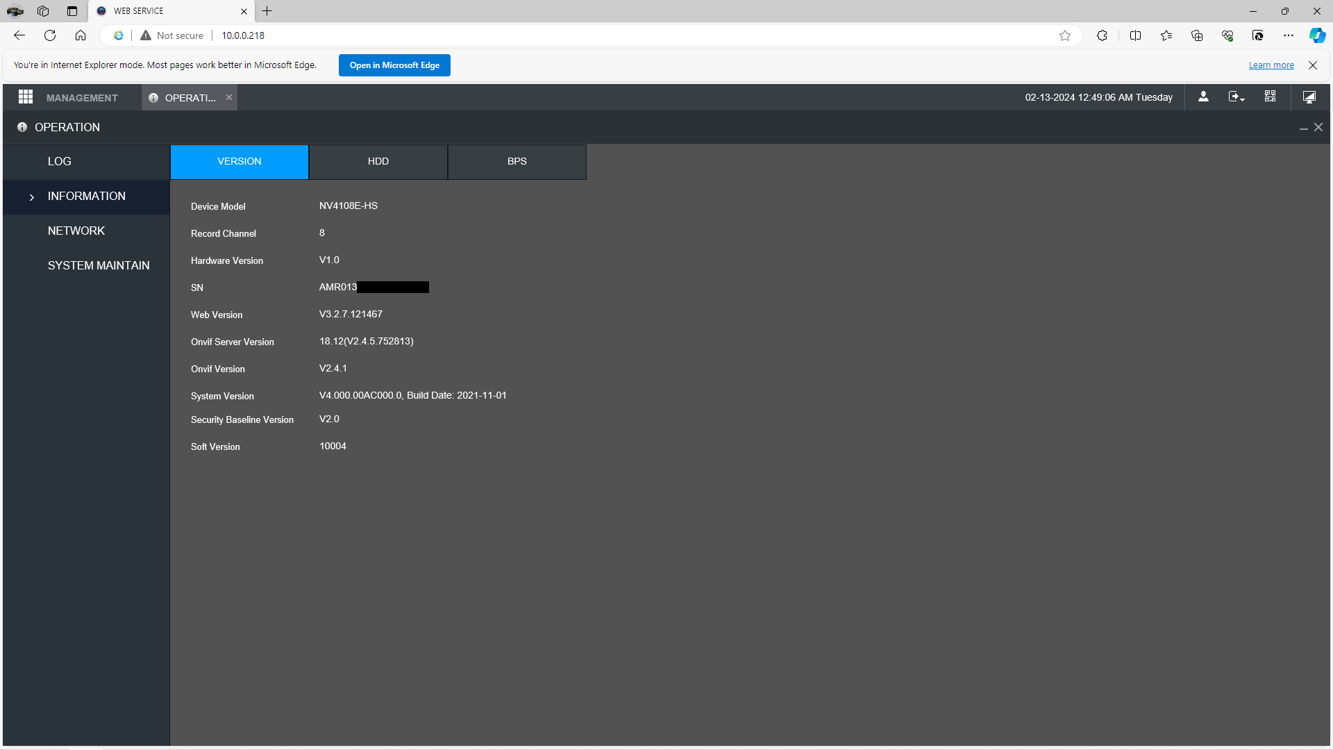

I am trying to find my current firmware version. Can you tell me where to look on WebGUI or GUI? I see on the Amcrest site there is a firmware update for my model, but I don't know if I already have it.

Re: NVR problem
Sure, From the main desktop of the WebUI, click on Operation then on left click on Information. See picture below. If easier from GUI of the NVR it self.
Right click, Main Menu, *Log in if you have to* then top right should have Operation *if using any 4.0 version* that is, Then again Information and it will dispaly your current FW

Ok My firmware is up to date.
