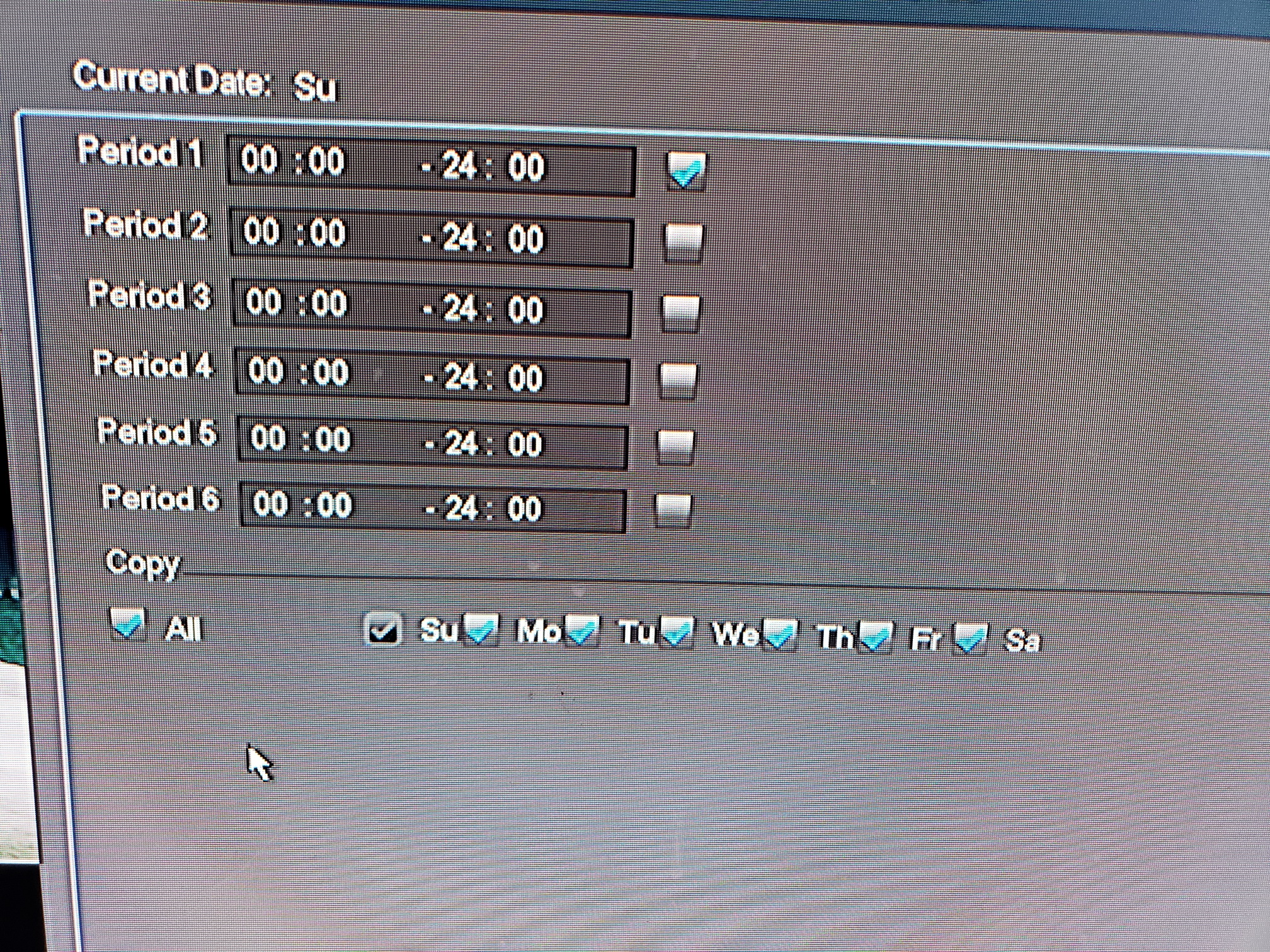

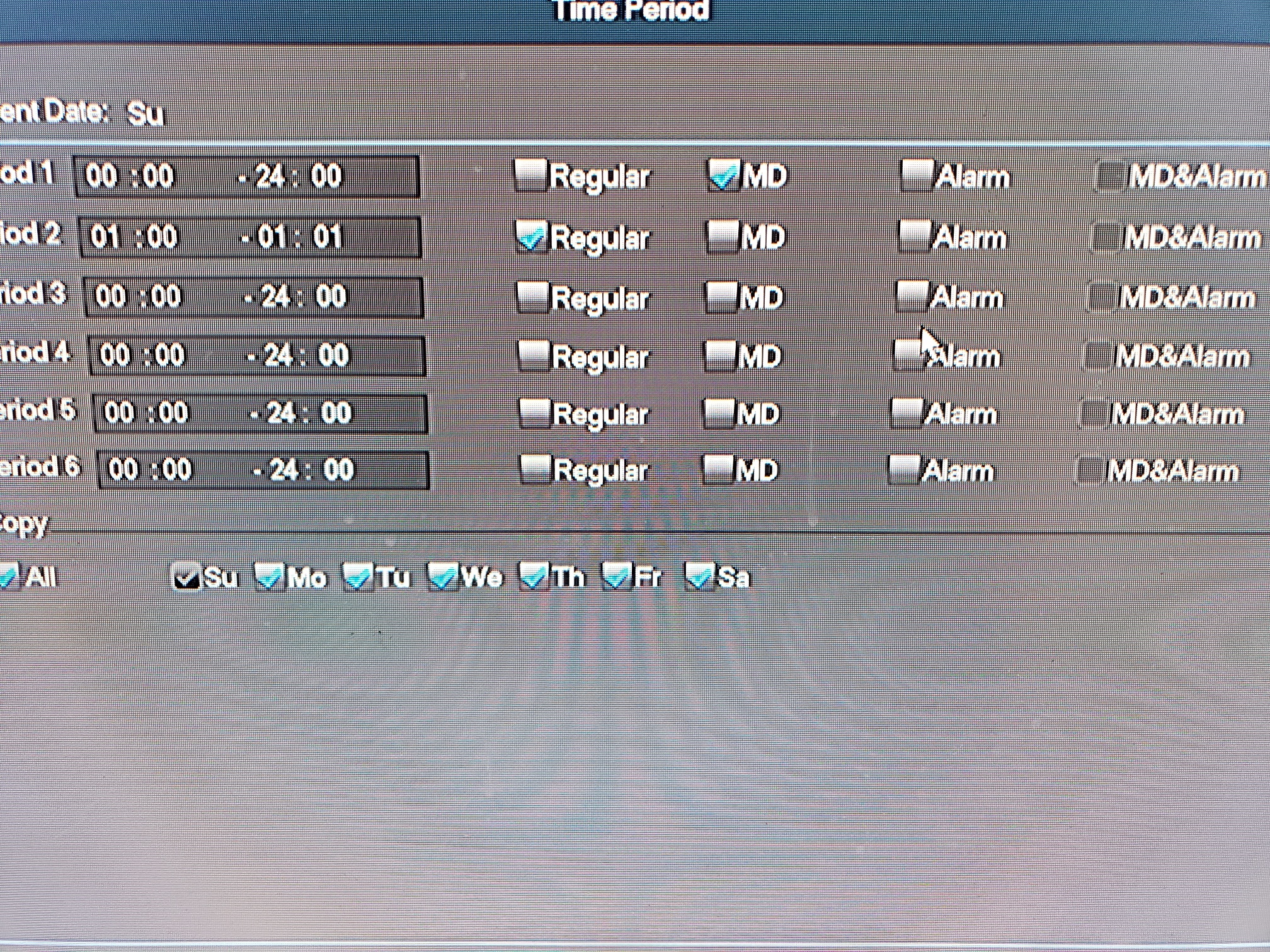

hummm Well it would be hard to understand that 2 cameras would go offline at the same time and this make your NVR now record... So then it could be with as you have listed here an issue I am going to guess over the NVR Power supply... Are you using the normal PSU that came with it or you using your own? Mainly ask because it can be that the PSU that your using is not giving enough power...
However it might be that you are not telling them to stay on all the days as well... So here are 2 photos on is for the Event for 1 camera you will have to copy to the second one after you make the first one... The other picture is under Storage and record for all days then click on the COG it will show you this picture.. ONe you pick MD and One you PICK for full time for that min... then looking at the bottom of them you can see that I am on SUNDAY... but have them all click for all days...
