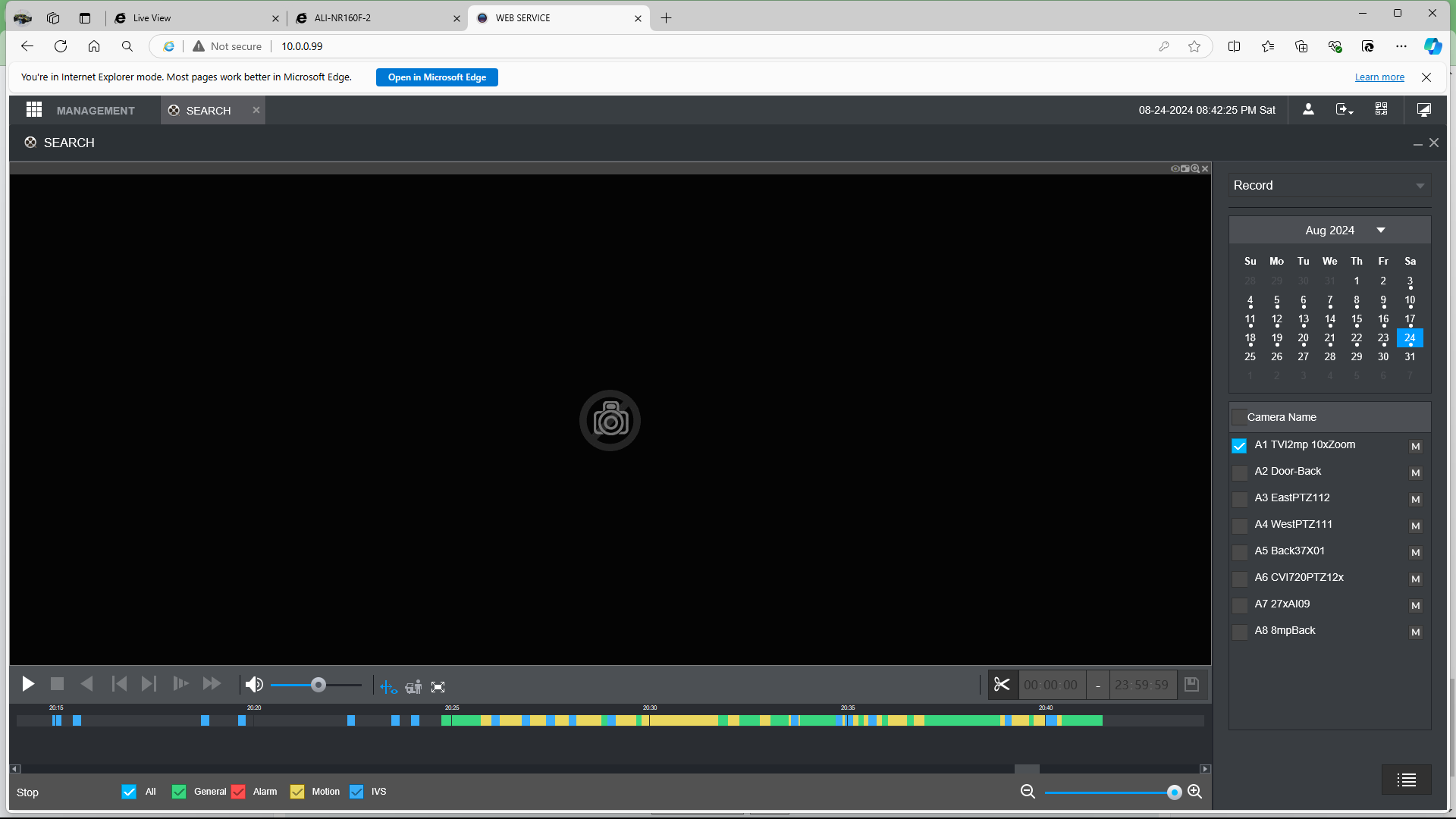

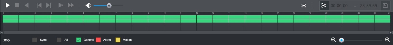

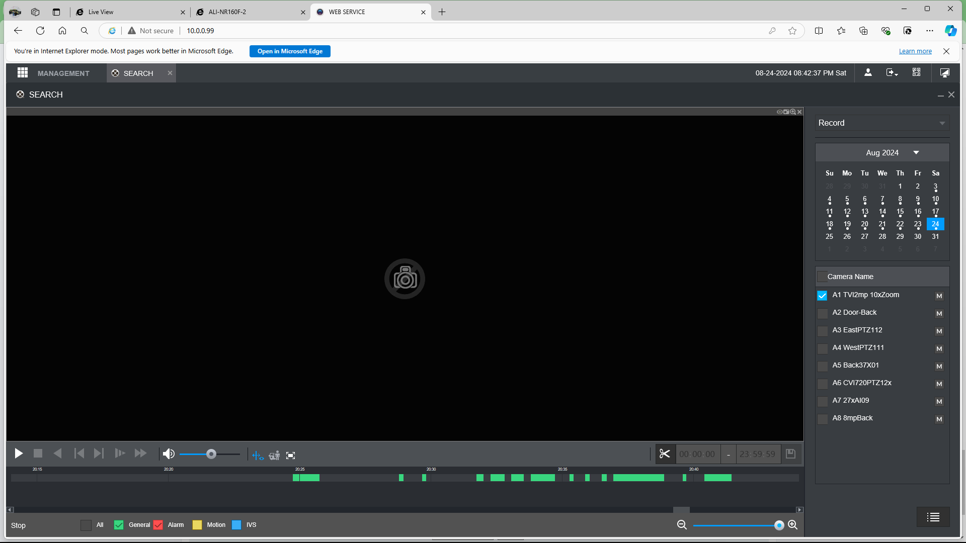

Pogo, Would love to see a picture of this.. IF you are recording full time, and motion please do a search of this and take a snapshot of the search for your channel with all event types in the search. This will show the yellow and green. Then click and remove motion and take a picture of that as well..
I have many Recorders from Dahua and Amcrest both While I don't normally record full time anymore in Main Channel I just checked my 1 DVR from Dahua that has 2023 firmware on it and 6tb HDD I did leave full time recording and I just checked on that and I just checked on my 5108-E1 that I setup tonight to record full time on main and turned on motion and normally only recording IVS.. I let it run for a short time then I went and looked at the search in IE on Edge and both the Dahua and Amcrest DVRs will only have full time in the time line of the Search if there was no motion or IVS.. It has been this way forever that I know of I am not sure how you have something different on your NVR and DVR?

So I will concede to how the timeline displays what's selected to be viewed. I've simply never zoomed in far enough to notice what you described.
And I get why it works that way up to a point, but it's still a klunky and misleading representation of "what's really there"..., which is (or still should be) everything designated to be recorded regardless of the category. That's obviously what 'All' is designed to represent.
The point is that everything should still play back in linear fashion with or without the breaks in the timeline which omit certain categories. And that's generally how it seems to work.
If an IVS trigger setup from a camera that the NVR doesn't properly recognize (or process) ultimately results in a black hole dead zone on the timeline, that's an unacceptable problem.
And the main point is, if the above is indeed the case, why bother with all the workaround nonsense when better AI methods already exist? Dump the crap and move on to something that works as it should, not just how it 'can be sorta made to' if you have time to piss up a rope all day trying to polish a turd.
Or just use zones and motion detection without all the fancy boxes and tripwire stuff and probably get better and more reliable results anyway.

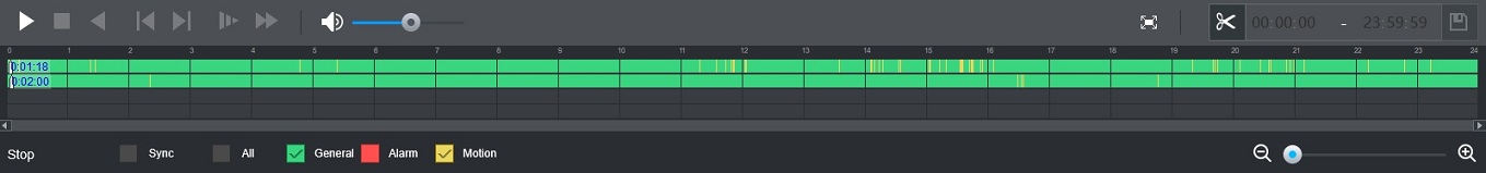

As requested, two timeline examples depicting my contention. The one minor blank line is hardly noticeable, certainly not to the extent of indicating there are blank areas at each motion location. But I stand corrected nonetheless.
Timeline 1.jpg (45.33 KiB) Viewed 6120 times
Timeline 2.jpg (42.89 KiB) Viewed 6120 times
Re: How am I supposed to setup my cameras?
Easy to understand how it might go un noticed with an area that don't have many or very long different events, for me I noticed long time ago while trying to search an event that had started before motion seeing where zone was. So I thought I would remove motion and dl from outside zone from full time recording. When I removed motion as part of search that was when I noticed. Since then or shortly after I found full time to Sub was only way to record all day full time and get full events as well on the entry line series. Only machines that can record all without breaks are very costly ultra recorders if they use multi hdd setup and setup events and full time to the correct hdd. If not it will chop. I still record sub stream full time to save space anyway on my 4216E-AI and my 5216E-16P Ultra NVRs.
