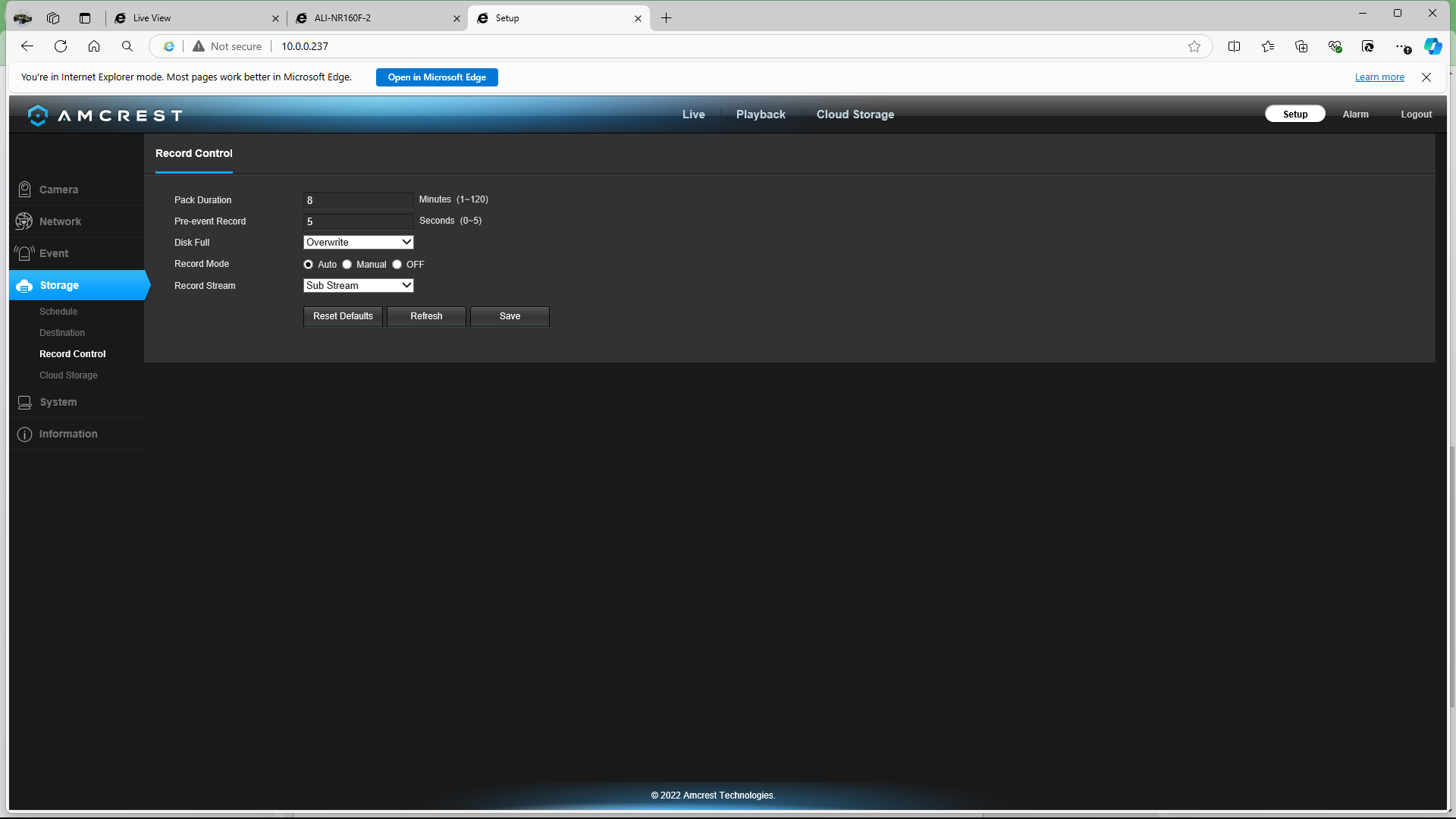

I do have pre-record setup in the NVR. There's actually no setting for that on the cameras. It's just not working.
For some things the NVR overrides the settings on the cameras, for other things the camera overrides the settings on the NVR. None of the 4 different manuals I have say which takes precendent for any of the settings so I'm forced to use trial and error to figure it out. Don't forget the inconsistent chinese to english translations
Maybe this NVR can't handle 30 seconds of pre-record like the 960H DVR can because of the higher resolution leading to larger data. I'll try setting it to 10 or maybe 5 and see if that makes any difference next.

Hey, I missed that. Maybe it's contradicting the setting in the NVR. As I wrote before, sometimes the NVR takes precedent, sometimes the camera does, none of the manuals say which does what for any settings.
First guess would be that was for recording to the SD Card, which I don't have, but with this system, one never knows.
I've already set the pre-record on the NVR to 5 seconds. I'll check it out tomorrow and see if it made a difference.

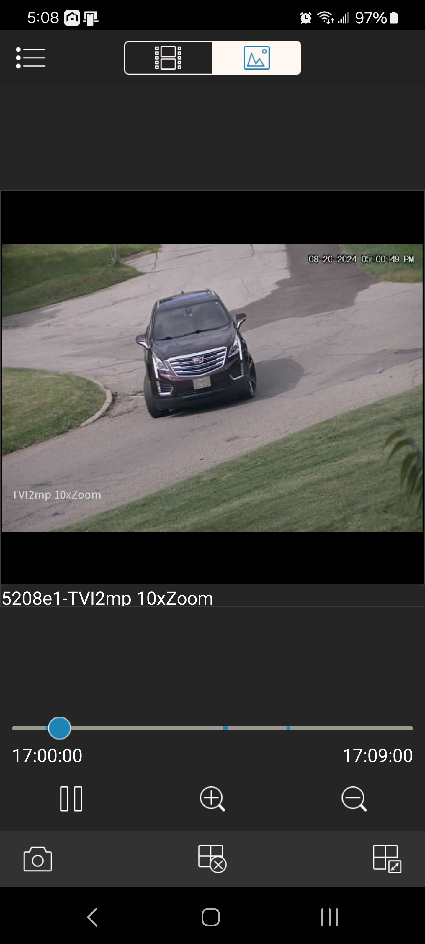

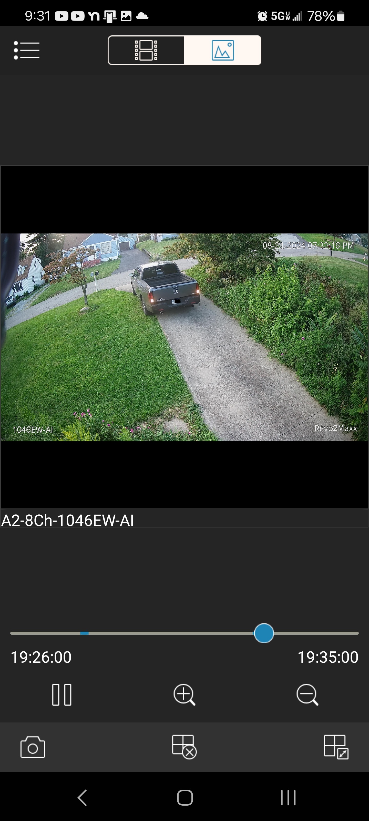

Ok, this just got weirder.
If I view the recordings using the phone app or ASP, I see a video with the 5 second pre-record.
I set it to 5 (in Webui > Management > Storage > Schedule > Record) last night before I went to bed.
If I view the same exact recording using the Webui for the NVR, I see no pre-recorded segment, the video begins 5 seconds later.
Note: This is the first time I've used the Android app for playback and I was using only the WebUI on the PC before.

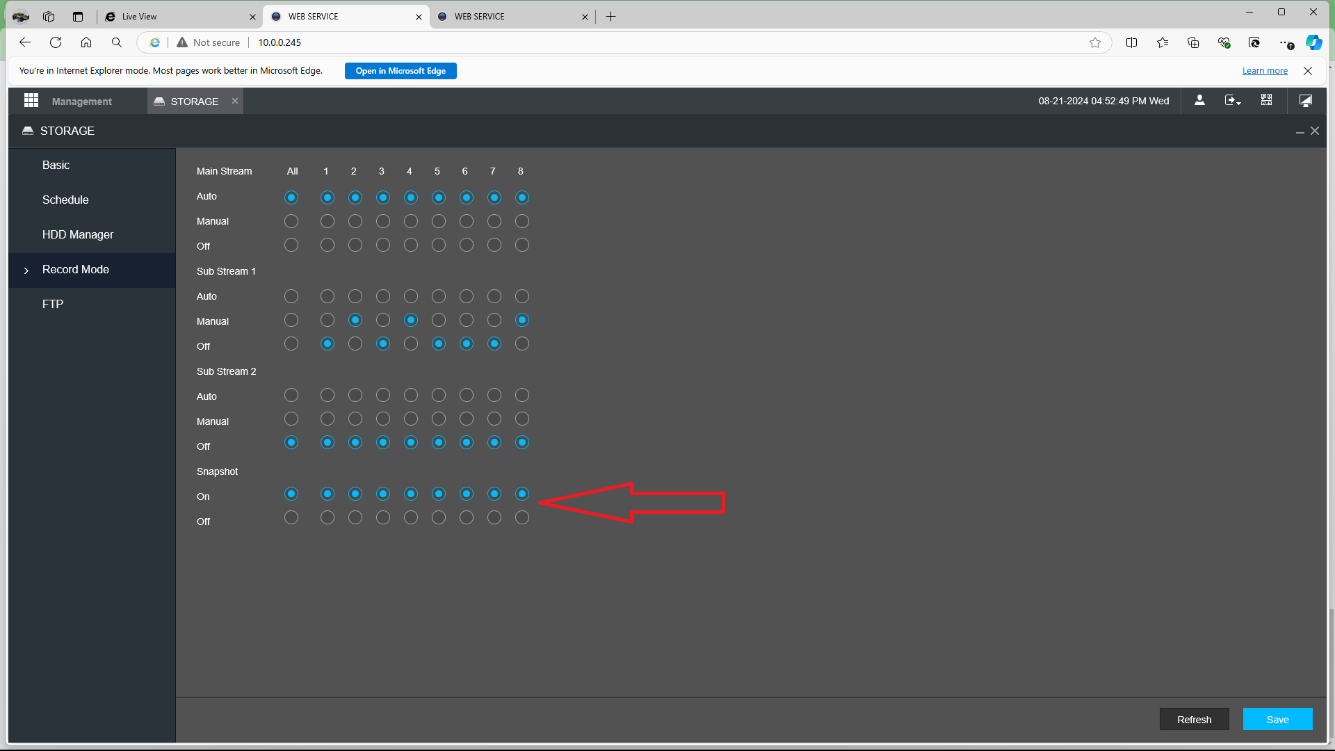

In the webui > Management > Storage > Schedule > Snapshot - I have General, Alarm and IVS set to 24/7, Motion is off.
In the webui > AI > IVS I see no options for snapshot.
In the webui > Alarm > Video Detection > Motion Detection - I do see a checkbox "Picture Storage" but motion detection is disabled.
(I just noticed Audio Detection has the "Picture Storage" checkbox too but I'm barely getting into that part. These mics can hear the guy across the street when he's outside talking on his phone quite clearly. The smallest wind sets them off though with the default settings so that is off for now.)
In the webui for the camera > Event > IVS - for both IVS rules the snapshot box is checked, the 1 box is checked, and the 'period' is setup to match the 'schedule' setup for each rule.
When I search for pictures by any means, I don't find any.
Oh, I can manually take snapshots and they are saved in the proper folder on my PC.

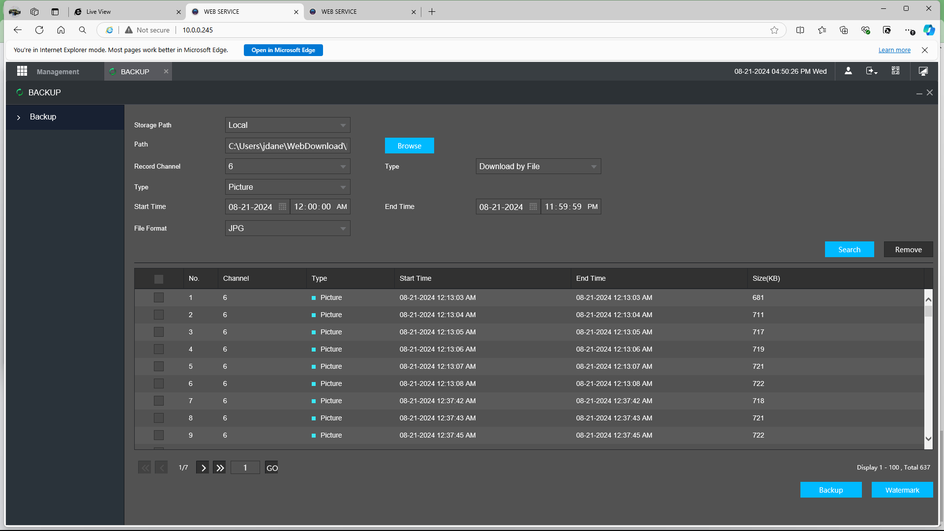

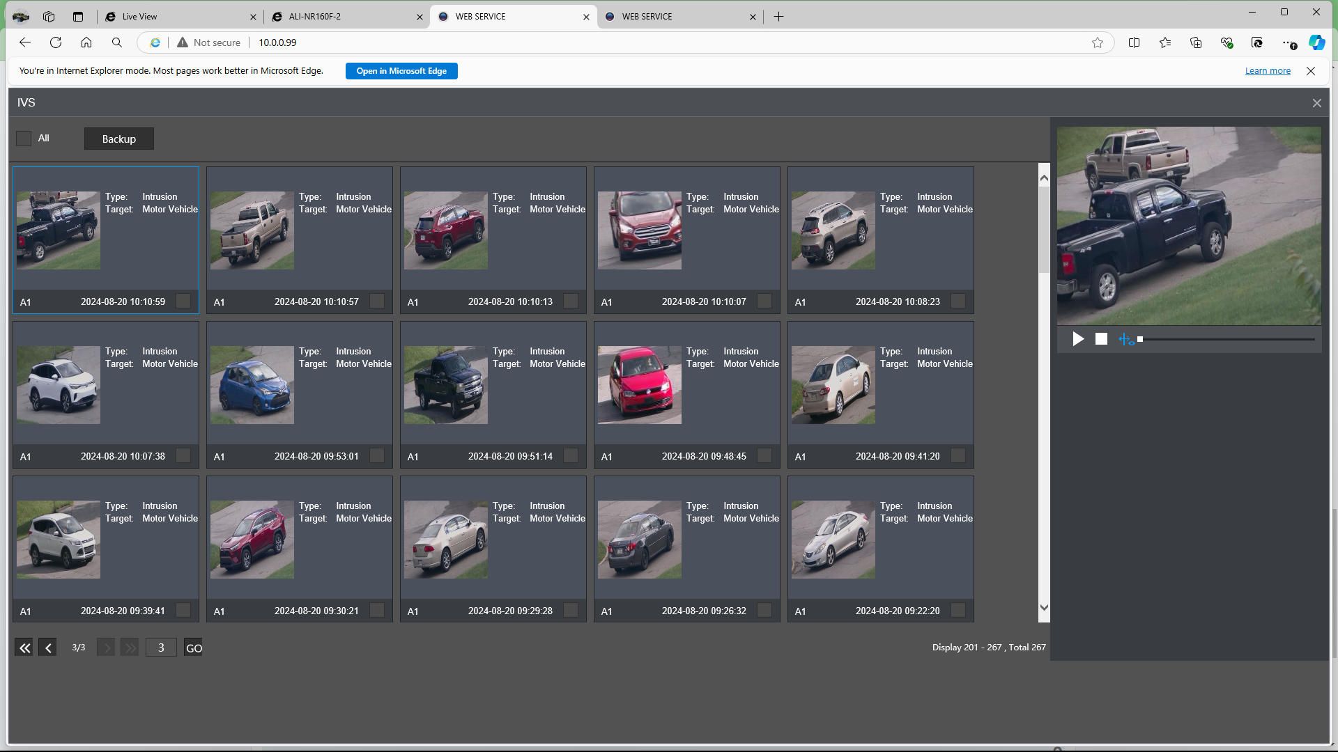

I am getting old so forgive me if I repeat my self. To see the pictures in full screen right click and see in new tab..
I would look at the first picture here if yours is setup with Snapshot on like where the red arrow is pointing and you have it setup for full time still then you are getting some big pictures every second saved and taking up HDD space...

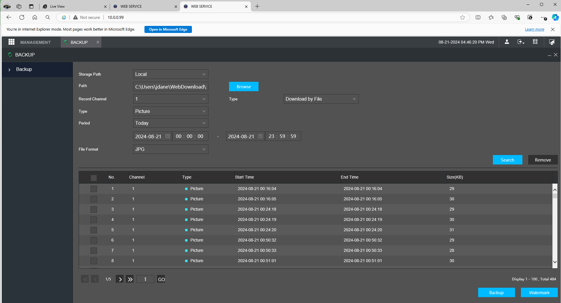

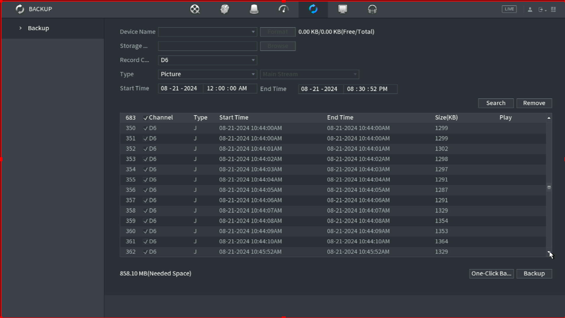

Next 2 pictures is 1 from my DVR and 1 from my NVR you will notice that the NVR picture size in the NVR is much larger in size then the DVR. That is because a DVR you can pick what size you want your snapshots to be in a NVR it is FULL Size not option to scale up or down..
Also note, I can't find snap shots in WebUI in search, I can from Backup as the 2 picture show. Please don't confuse this with the images being picked up from my local computer this isn't the case. That area in the picture is asking where I want to backup the images to...
Searching in the App is painful but can be done. for me because mine are setup per event and the app only lets you search in a 10min section it isn't fun lol But I will add in a picture showing it playing back in the AVP app..
Just trying to help with things that I have learned myself the hard way along the way.

Doing a search in the GUI of the NVR i can find images using backup tab for all supported and enabled channels. in the WebUI can be found also using Backup tab but that tab is most times missing in Chrome or Edge normal mode. So yes very hard to find images on a A2.. That is why it is easy to fill up a HDD if someone don't know that the system needs to be changed in Schedule from full time snapshot because 86,400 images. . I am getting old so my math might be off.. Anyway to any one reading this that has any recorder, If you are not changing your snapshots scheduling and wonder why your HDD fill up that is one reason..
Also I can't show any images for Ch1 because that is the DVR and it won't send images in the right size so the NVR doesn't store the Sub Channel image size it is looking for full size that a IP camera does.. That is only reason that I didn't show images in my A2 of my Ch1 because it is running from my DVR as a IP camera and image size isn't supported..

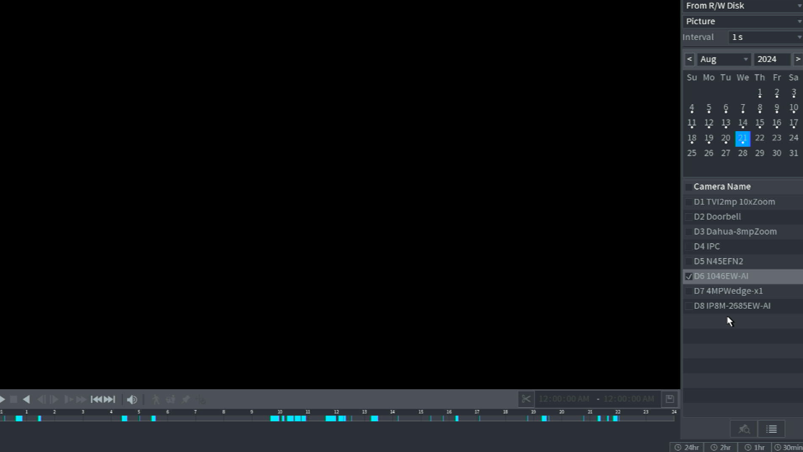

Re: How am I supposed to setup my cameras?
Oh yeah so I am complete in this. You can go into search in GUI not WebUI but in the GUI you can go to search and at the top change to picture and it will list all your images, can only pick 1 camera at a time for play back.. In the type you Choose R/W that is the HDD IO is your thumbdrive if one was in the NVRs USB slot..

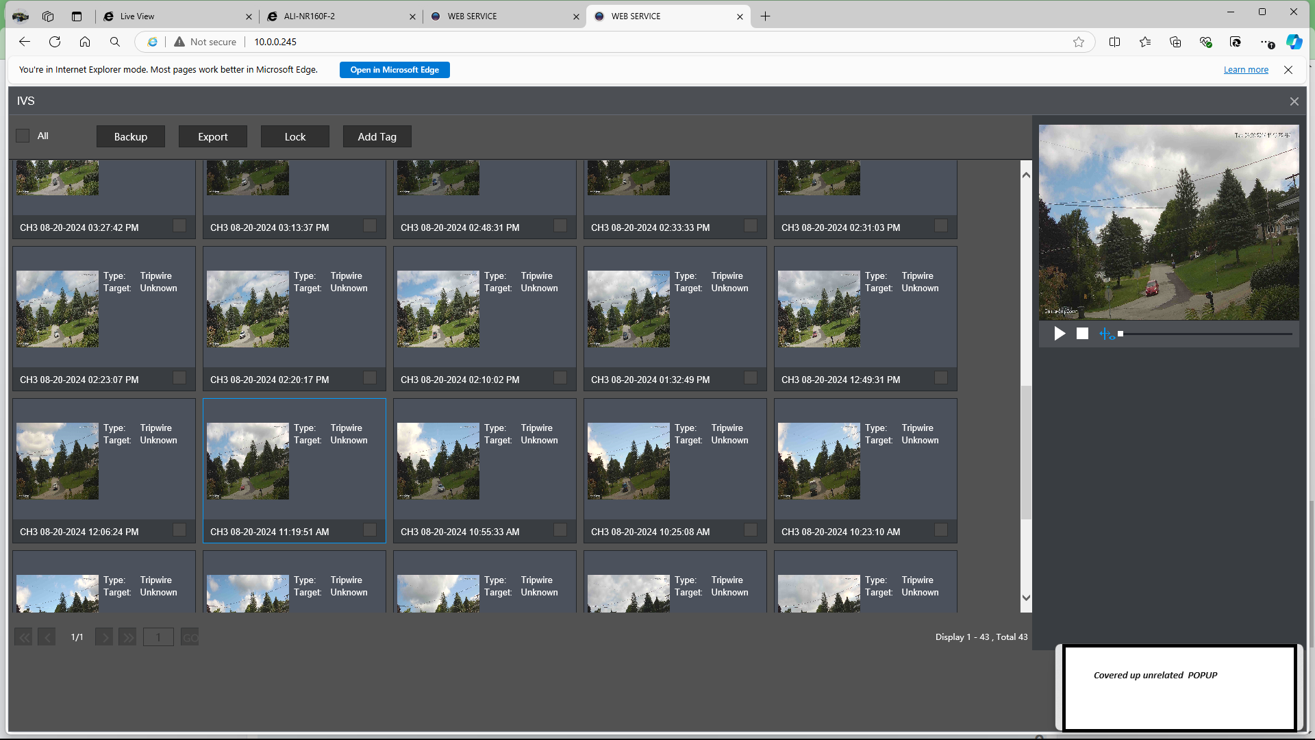

The front cameras record when a cat sneaks by close to the house in the dark in IR. I can see in the recording that it triggers both intrusion zones on ch1. But the light does not go on per rule 2. If I walk out there at that time, the lights do come on.
The IVS rules for both CH1 and CH2 are set to make both 1 and 2 record if either one is triggered. These two are on the front corners of the house looking out cross eyed so I can see down the street in both directions with the center of our front yard in the middle of both views. CH2 seems way less sensitive then CH1. CH1 will trigger on things that are much farther away from it.
The back cameras don't get triggered by our dog when she's running around the back yard. She's a Lab so she's alot bigger then a cat. She's usually in her dog run, the one location no cameras can see.
Anyways, now that I've got it roughly doing what I want I'm thinking of adding some small motion detection areas, I can do 4 per camera, or maybe some trip wires to get the system more sensitive.
Questions: Trip wires record for a set time after tripped correct? And motion detectors record the entire time there's motion in the detection zone?
If recording is triggered by both motion detection and IVS on a single camera is it just 2 reasons for the camera to keep recording or do I get 2 seperate recordings?
