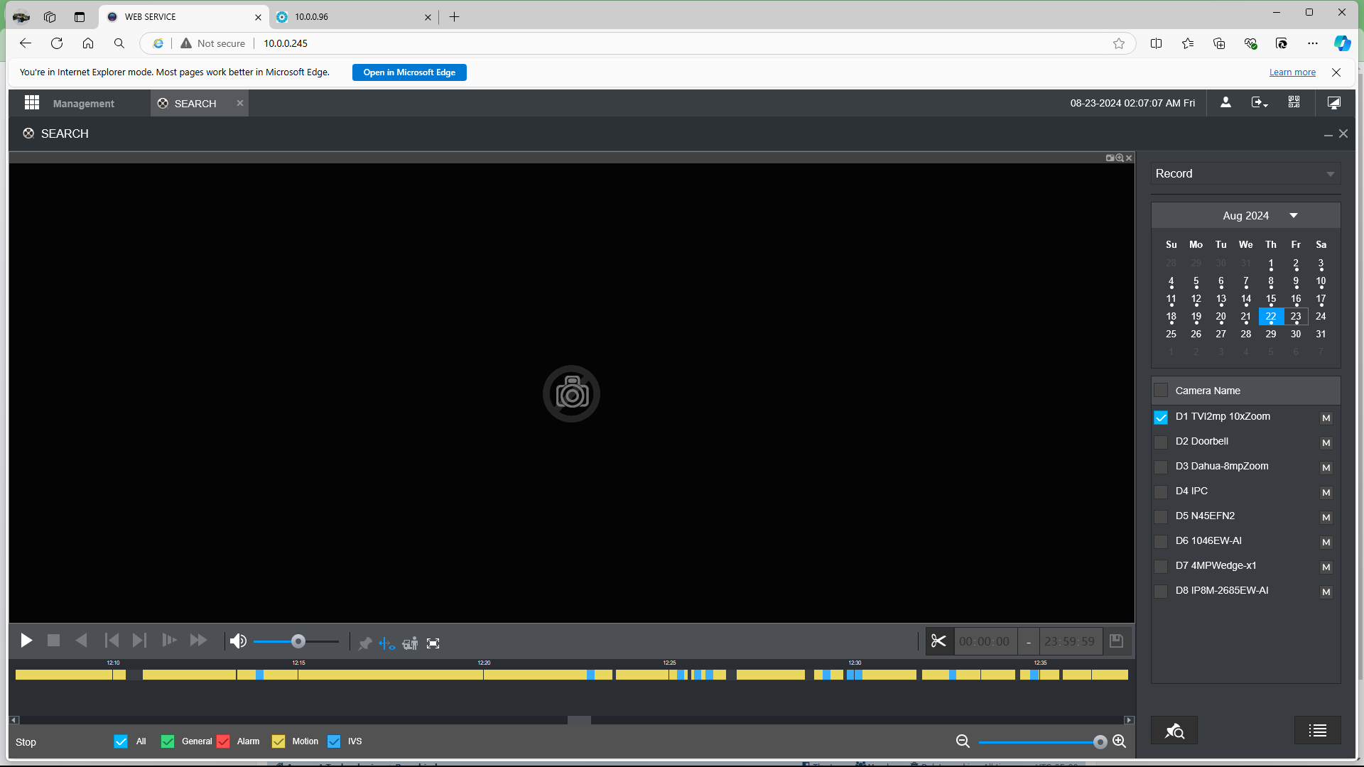

Thought I would add in some extra content of what I mean about Motion and IVS. If IVS is removed from the search it will not have any motion in that area to keep the full scene going I personally don't use many of my AI cameras in Motion because I want real events only to record. Anything that I want to have full time I will do so on Sub Channel to keep recorded data longer. In the 2 pictures you can see 1 has the IVS and the one with the IVS removed from search and I know that it is hard to see because there was a few areas that didn't have any motion to start with. Looking at the picture full screen and switching back between the 2 pictures makes it easier to understand. It was windy day so there was a tree that was blowing in the wind causing all the motion for the day.

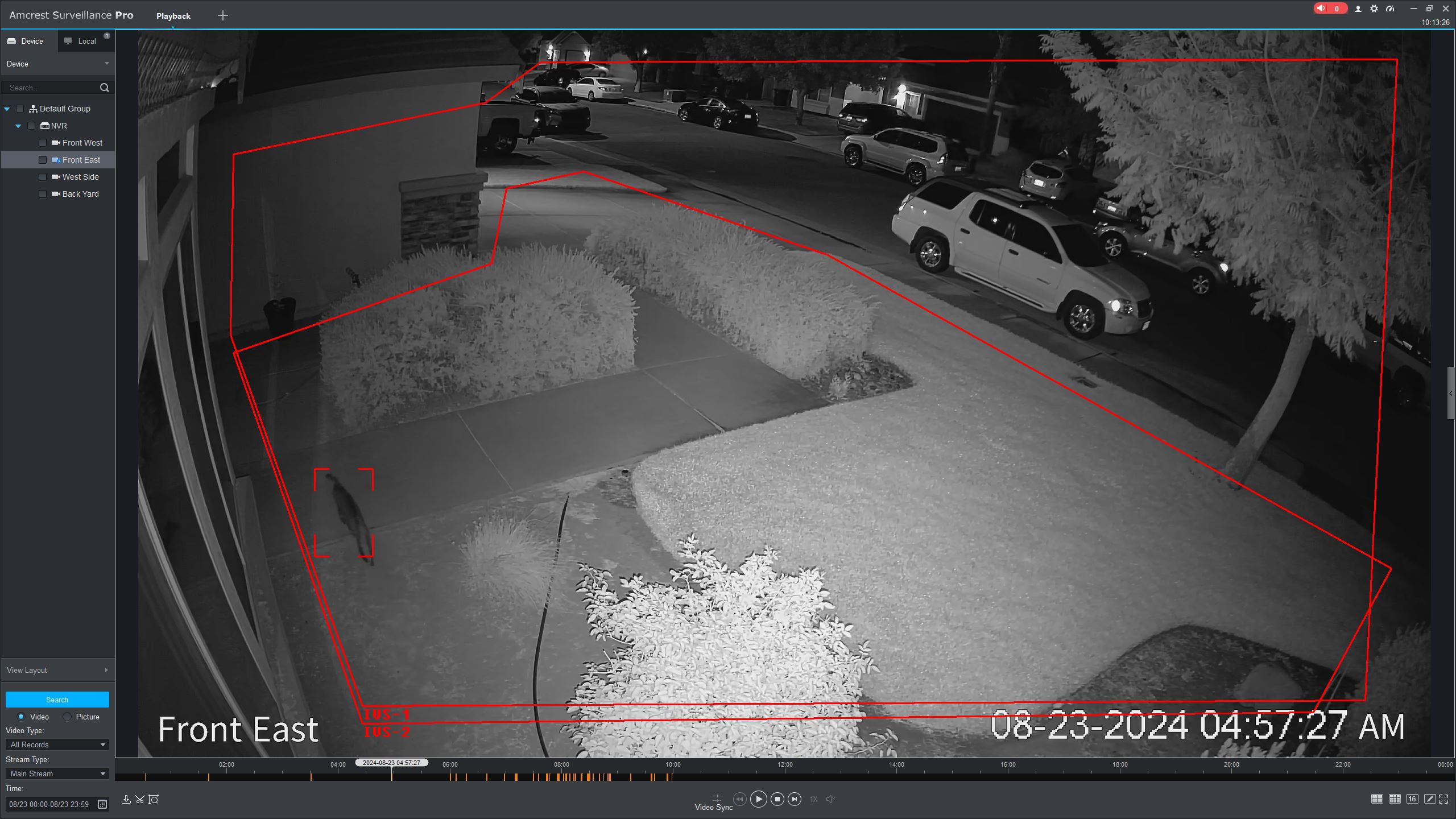

Also, here's that cat again. It clearly trips both IVS rules but the light doesn't come on. If I walk in the same spot at the same time, the lights come on, weird.

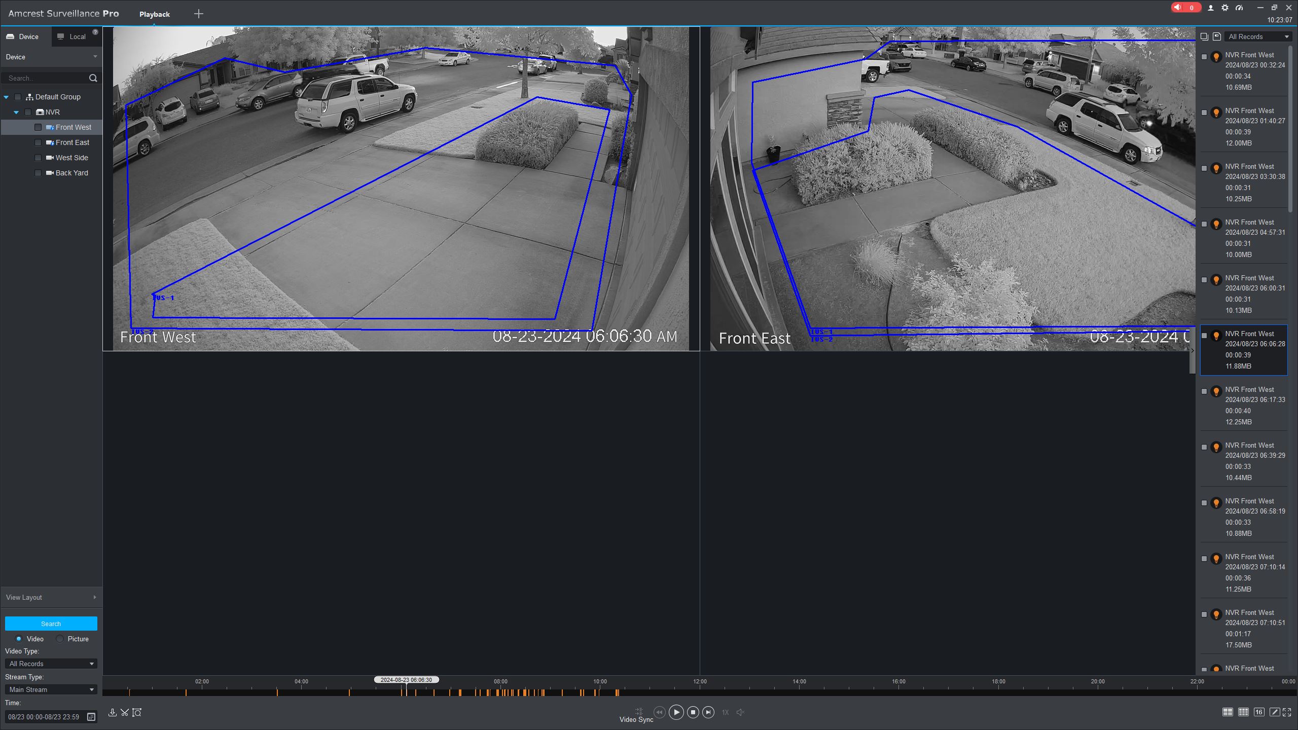

In the second image below you can see what I'm trying to do out front. The larger rules are 24/7. The smaller rules are 8pm to 7am and they make the lights turns on. (trigger smart illumination)

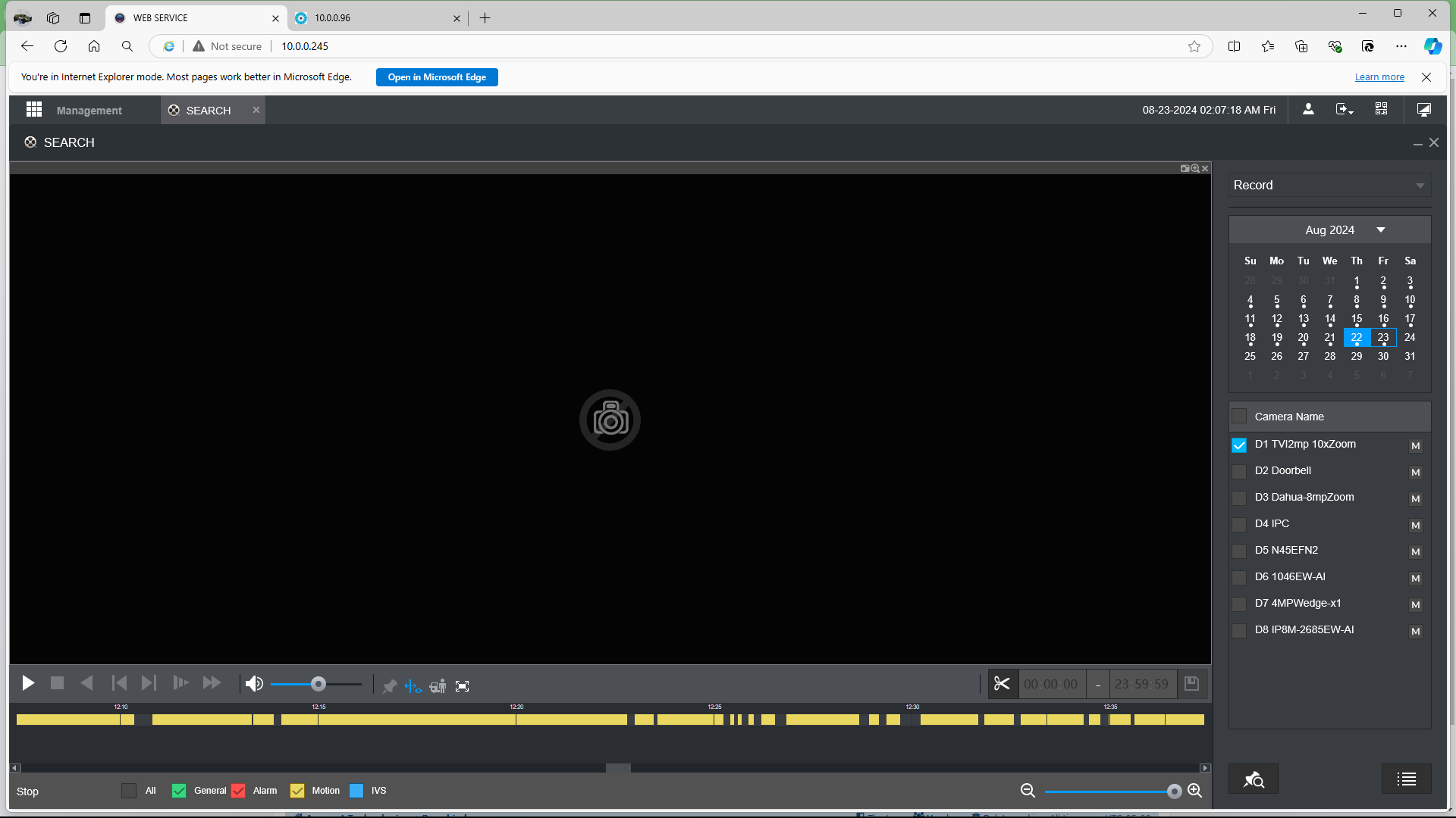

OK page 3 of this thread and 4th picture down you can see where you pick the Sub Channel as your record full time even without it being setup in Scheduling.. Changing that to Manual for the Sub Channel it will record sub channel full time and not interfere with IVS recordings..
Re: How am I supposed to setup my cameras?
So thought I should also mention how to access that incase it wasn't seen in any of my post..

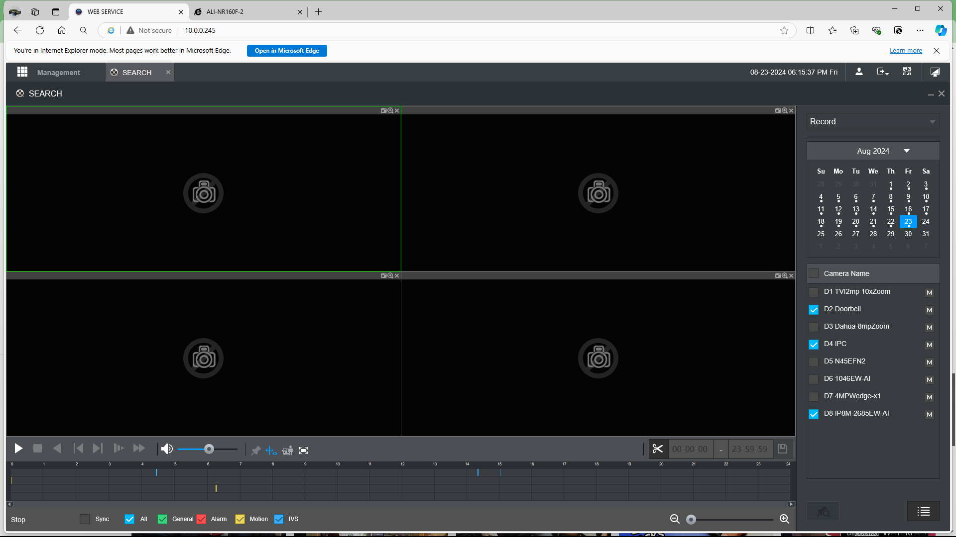

If you look at the 2 pictures the first one you see I have 3 cameras picked, One of them don't have any events today and the other 2 have very little. IF you look in that first picture you will notice that the M is in the list on the right.

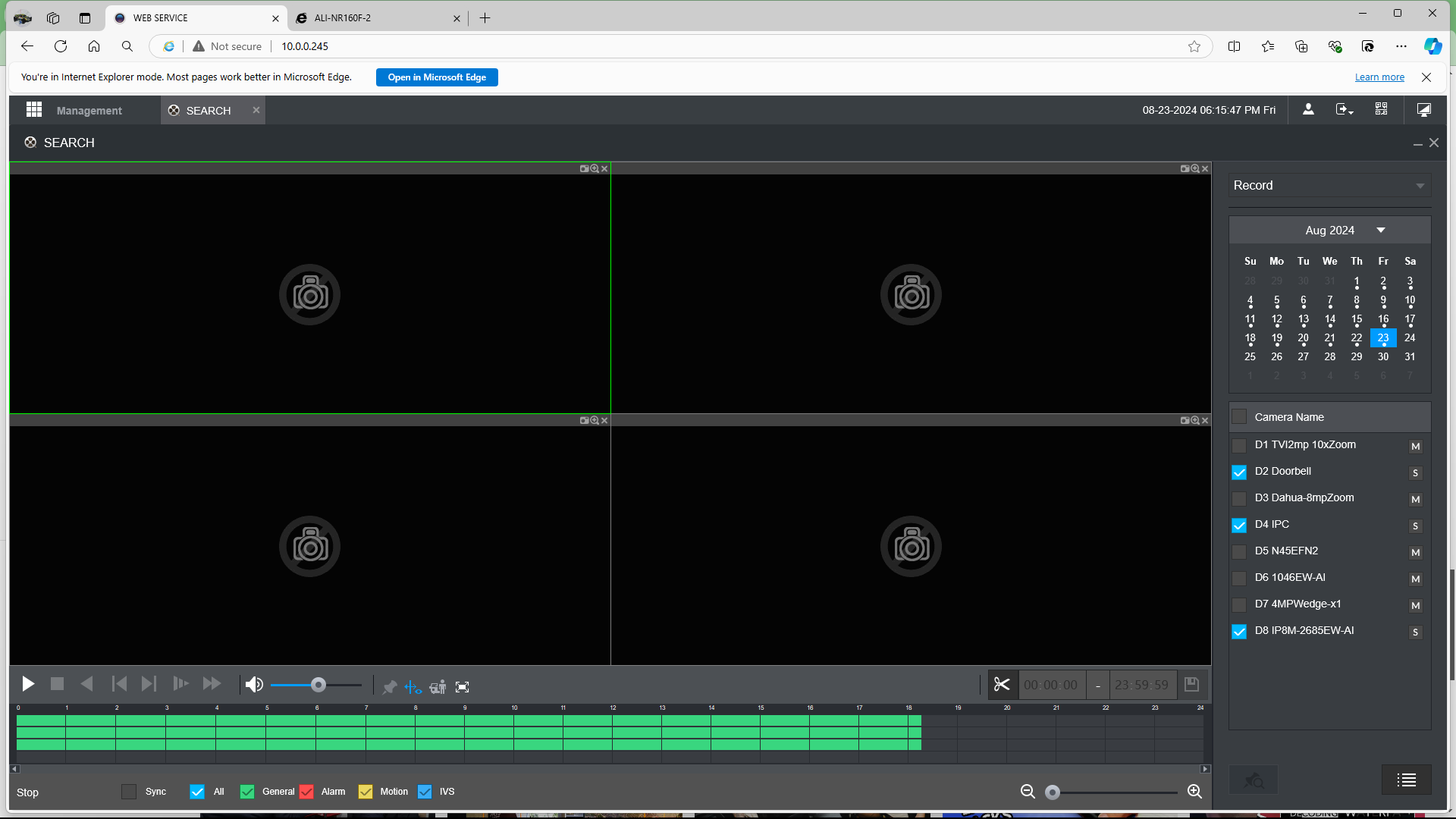

In the Second picture you can see that I have full days recorded footage and looking at the area on the right it is now S that is because the recording is on the Sub Channel.
