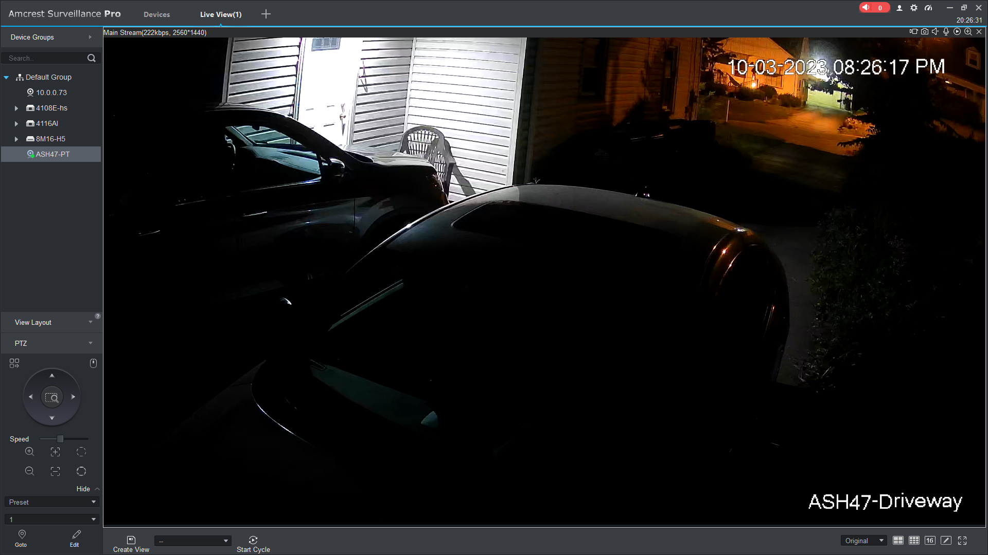

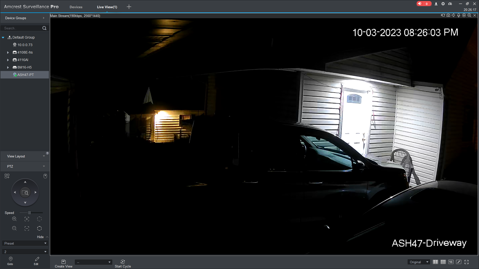

No premade presets in ASh47 camera. Again in the Presets you will need to use a 3rd party app or ASP from Amcrest. Here is a couple of Pictures of my ASH47 using Preset 1 and Preset 2 in ASP..
Screenshot (227).png (664.86 KiB) Viewed 22909 times
Screenshot (228).png (808.13 KiB) Viewed 22909 times

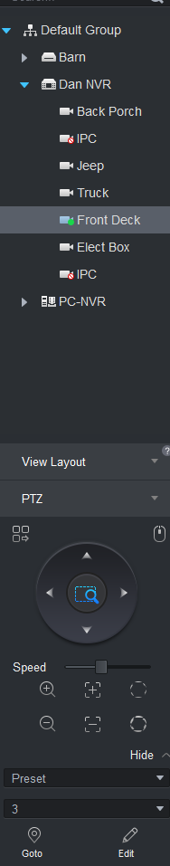

I wish I could show you (in a video like you did what you did). Maybe one day. I like the pictures tho. Okay the picture shows you how my ASH47 is at, as it's called Front Deck. Now I go down to PTZ, click on Preset, and select #1. Then I click on edit, select save and then start all over with the next number. I did 3 of them. After I was done doing this, I clicked on #1 and hit goto. Camera didn't move to position #1. Then I clicked on #2 and clicked on Goto and the camera didn't move. It's not moving. What am I doing wrong.
Dan
Re: What's It Called?
Ok just tested out my 2 local NVR's and sure enough it will not save presets using the NVR.. You can see this at this Video here
