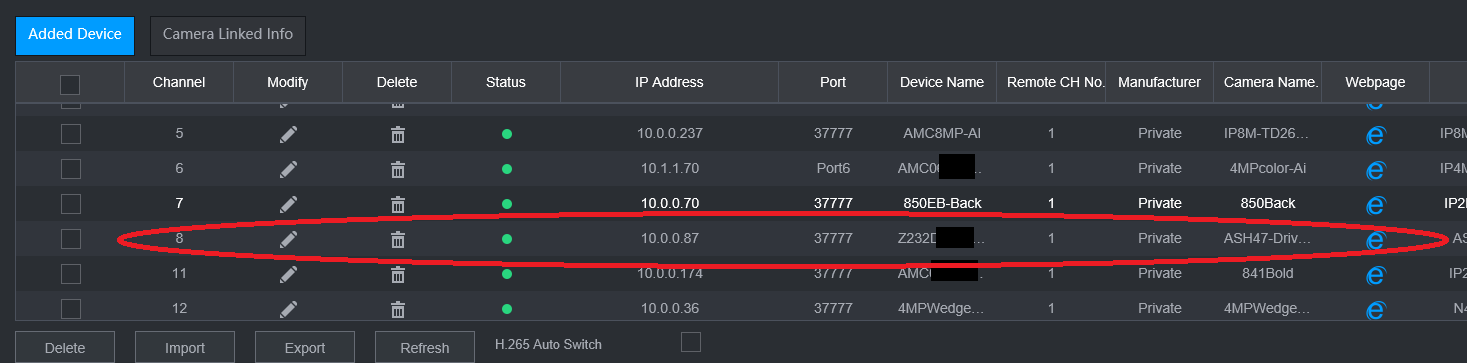

Here is a picture of how I have my camera setup I am going to guess that maybe you have had to do something strange with your adding of the ASH47. So I thought I would put out there what and how I have it setup in all of the NVR's it is connected to All of the recorders area playing back Full time Main or Sub it don't matter for what machine I use for Format..

I looked at your screen shot and yours and mine are the same. No differencs. I did another video :
https://youtu.be/LbDueo-vb1c
and still no tour.

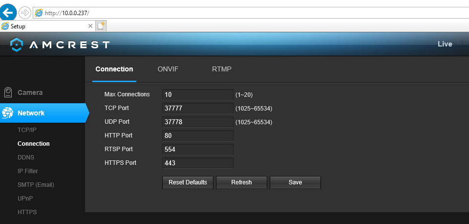

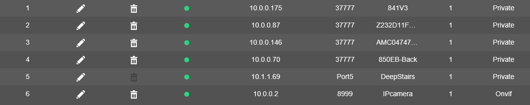

Before we go anything further into this, question. I've noticed that all my Amcrest cameras are on port TCP 37777 and my new camera is over on TCP 8080. Can someone tell me how to move my new camera over to port TCP 37777 or does it matter?
Dan
Re: What's It Called?
TCP port 8080 would be a non Amcrest non Dahua type camera. so some might use ONVIF Port 80, In fact even a Lorex doorbell uses a Different port then the 37777 even though it is Dahua type camera. So if you look at the picture below. YOu can see there is a ONVIF camera on Channel 6 and it isn't using the normal Amcrest Private Port id. The one showing Port5 is connected using the POE of the NVR it is on so uses the POE port and not a TCP port for connection.. 8080 is just out of the normal port 80 and is where a lot of different IP cameras can roam.
Well I don't want to say no. If your camera has WebUI then sure you might be able to make a change in the cameras settings to open a different port then what it came as Standard. Just keep in mind that at times doing this can cause issues with connections to the camera on a NVR or 3rd party software.. As you can see in my Amcrest camera has the option to make changes.
