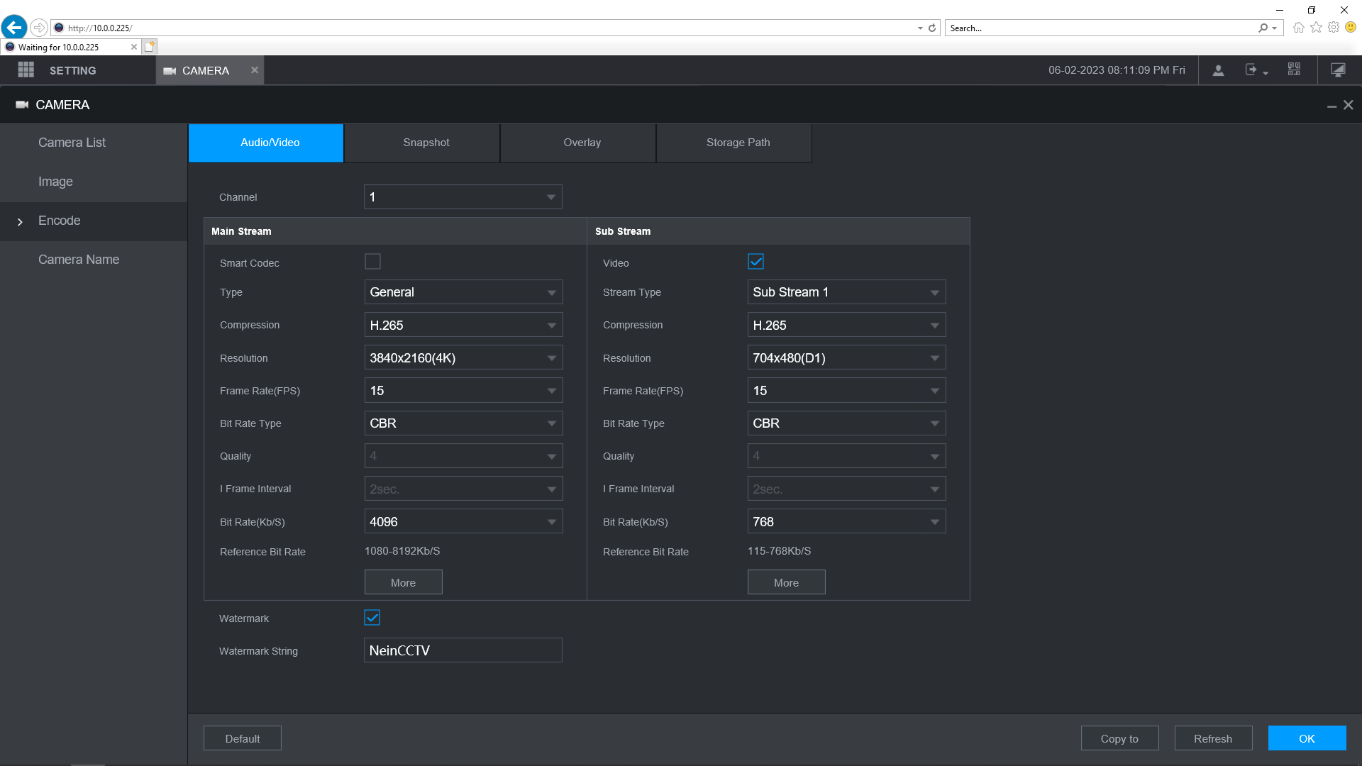

So hate to say it but there are a few things going on.
First question, Why did you choose the settings you have your camera setup on? While I don't own that camera I am going to guess this isn't' the way that camera was setup out of the box..
Second, To be honest I am not sure what my settings were for my 4k camera. What i can say is VBR is never a stable option and will never look good in any format..
Third, I would look to see if that camera has an option for h.264h if it does I would change that camera to that format and CBR. Keeping it at 4096 is best.
Now I have some other cameras that won't work well in h.265 and don't offer the H.264h so I have them setup on just the none H and that works well. if yours don't have the H.264H then I would try the normal.
Worst case, I would take one and Reset back to Factory setup and see what it comes in setup as. If it is VBR really change it to CBR.. Again if it comes setup H.265 then if changing it to CVR didn't help much change it to H.264 at a min. It will take more space on your Micro SD but a good picture is what you want worry about space later..

Thanks for the tips! And almost immediately too!
The settings on the camera in my video just happened to be what they were last on during testing. I've tried CBR and VBR at all the different bitrates and regardless of the settings it either looks the same or worse, always a grainy noisy mess.
With regard to the browsers that's not how I normally view the video, it's normally over an rtsp stream into go2rtc or into frigate. In the new video I also show it going into VLC with all the different codecs.
I made the changes you suggested, switching to CBR and increasing the keyframe interval to 2 seconds, and on H265 it's basically the same. On H264 it shows some improvement but it's still unacceptable. And the refreshing is still very visible at 2 seconds on the keyframes regardless of codec or bitrate. Whenever the keyframe happens there is a flash of noise and then it clears up a little over the next few frames.
I tried reducing the bitrate to 4096 as well like you mentioned and all that does is send less information through, so the graininess is reduced but also picture quality.

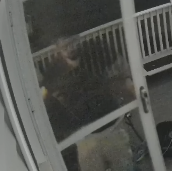

Resetting the camera completely to factory defaults makes STILL images crisp, but that crispness is completely fake. It uses the '3D noise reduction' to hide the immense amount of noise from the sensor. It uses 50% as the default setting for it. This means any motion is full of ghosting. The stationary image of the camera looks fine but any moving object is ghosting around as the noise reduction has to try picking a clear image out of the sea of noise on the person walking by.
It's unacceptable because that's what we're trying to do with security cameras, see things that are moving. It doesn't matter if the still image is crisp if anything moving on it is like a ghost as the noise reduction averages all the sensor values over a couple seconds. The noise is so bad that with noise reduction enabled people leave long trails in their wake and look translucent as they are walking, blending into their background.
Here's a screenshot of me opening the door to that deck. You can see the deck railing and the chairs right through me the noise is so bad. This kind of issue seems to be inside the camera, before it even reaches the encoder to be sent over the wire.
