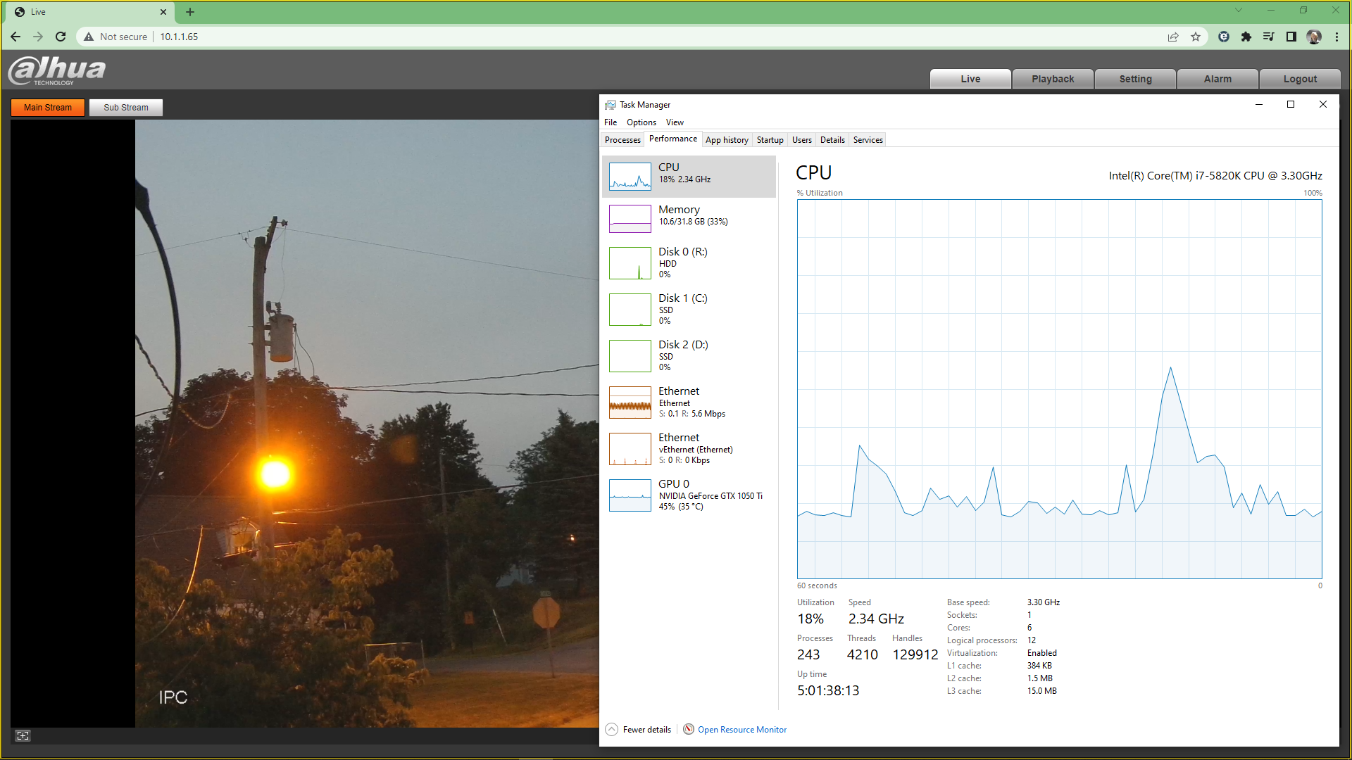

WOW! So I am sorry to say that I think some of the issue is the Browser you are using. I am not sure how that make any sense really because you said you took the footage of the last test off the Micro SD however I just made a Video with something in my testing I thought I would shoot your way.. I turned on the Smart CODEC on my camera. and I will admit it looks ok as long as 3d is turned on. I made a Video of it and then I thought Ok lets see what it looks like in Chrome.. WOW.. Logged in, Static picture.. Nothing.. It is crazy that Amcrest was able to make a camera that works 8mp in Chrome and while my camera is said to be Chrome Enabled there was nothing while using h.265. In that video I change to H.264 and sure enough I had the 4k in Main working but if I move to h.265 it just turns to a static Picture.. Also with Smart Codec turn on it wouldn't work in H.264 either. So had to turn that off and H.264 before I had main feed in Chrome..
So my CPU and GPU is little outdated to your's and maybe that is why your system is able to run it. However here is what mine is running at with Chrome turned on and smart Codec turned off and in H.264 because the video won't run on main with it turned on to H.265..
If you care to see the Videos I have not uploaded them as I was not sure they would help. However I am more then happy to upload so you can see the good and the bad of what I am talking about..
