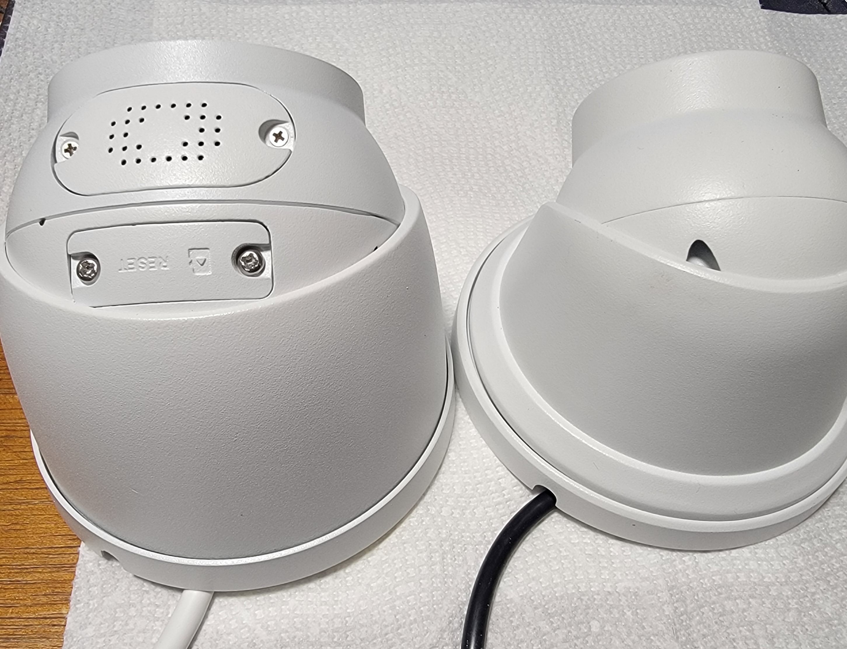

Between 930am and 130pm turned into by the end of the day lol Just got my new camera 6pm. So not able to get things setup for testing much tonight. Unless I get lucky somehow and get it put out even if out to the Valley.. First off, Why did they have to have the Alarm turned on by default lol. WOW this camera is Huge compared to my 8mp Analog camera. Sure this has same Built in Mic, and then offers more things like Speaker, Micro SD slot but wow wasn't expecting this Turret to be this big lol. Took a picture don't look to big if you look at the mount look at the 2 balls of the turret..
First off the Video I have to say looks very nice not so nice if you Digital zoom however so far what I see on my Bench looks nice anyway.. Also the zoom in was to my monitor of another camera so it could be picking things up in there that I can't personally see so won't know until I get it mounted and do some testing..

So I don't know it is really hard to say at times what is a good camera because everyone has a different area of view and region of interest. So i did put the camera in the location behind the Dahua 8mp I was making my Videos with. The Amcrest camera is Amazing compared to the Dahua and it really should be seeing it has better Sensor to start with and semi pro compared to a Lite Dahua with Zoom. I mean wish the zoom was on the Amcrest to be honest.
Would I recommend the camera, I would. Can i say that it would work for your application? I hate to say this because I am not easy to be understood at times. The camera on your front porch is being asked to much of. The camera in the back yard I think the camera would be great there however the garage being there might be asking for a lot at different times of the day. The good news is that the camera has SSA so I would turn that on and it should be golden on the back yard. I am not sure even with SSA turned on that the camera would work well in the front porch because of the scene. Sorry I say front porch however I think that is the back porch. So I will just say the camera area where the Deck is that leads to your driveway. Not sure that camera would work well in that area trying to do all that you want it to do at that location.
However the camera a IP8M-TD2685EW-AI-GB not sure what the GB is lol but ok. Anyway is 200uSD and maybe is the kind of price you are looking to spend on a camera. Maybe buy one and another camera to try that is a Semi AI camera is a IP8M-2496EW-V2. It is a ok camera and does well for the price. I didn't have any issue while I had it on my back yard outside of spiders and bugs setting off the Rules because it didn't offer the Object filters. 2496 is a small bullet camera but has a nice picture. I have never looked at it without 3d turned on..
Here is a Video of the TD2685-EW-AI-GB that I made. Seeing the baby Doves Fledged yesterday I thought I would put this 8mp Turret camera behind the Dahua 8mp for a general idea of what it looks like in the same area That isn't were I will be mounting it just for testing..
