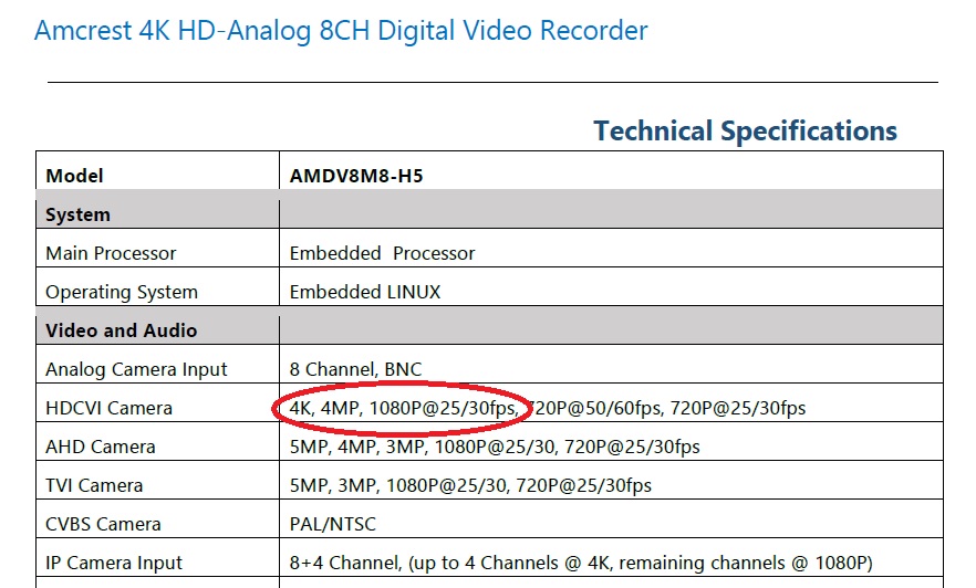

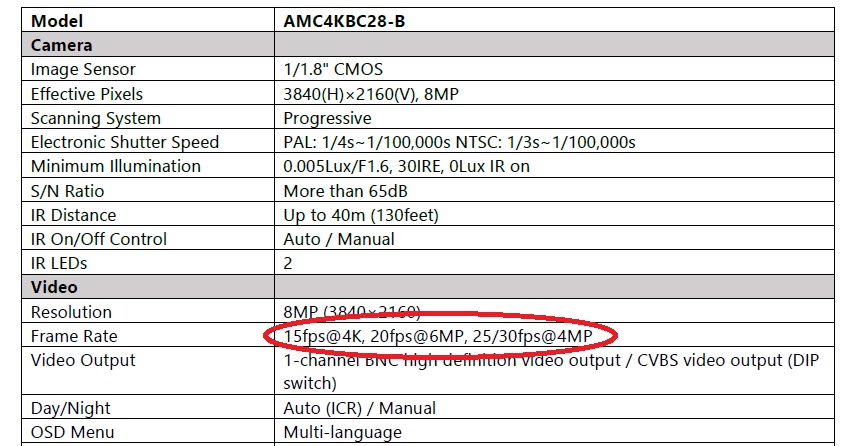

I was excited to see these on sale last week and immediately ordered one to try with my AMDV8M8-H5. It has become quite a letdown after several hours of trying just about everything I can think of to make it perform as advertised with a DVR advertised to be a great match for it.
The main problem: It's supposed to run at 15fps @4K/8MP, 20fps@6MP and 30fps@4MP. It doesn't. 7fps is max at any resolution under any configuration combination. I realize there is a 7fps recording limitation on the DVR at 4K, but that shouldn't affect real time viewing -- unless the DVR itself has a problem with this particular camera which would indicate a general Amcrest compatibility issue with one or the other, or both. The camera is set to HDCVI and recognized as such by the DVR when set to both 'auto' or 'CVI'. It also looks bad -- on a 4K TV. Very noisy and unstable like a bad cable or low power. Both have been eliminated as a problem and the camera looks beautiful over the network in Blue Iris at full resolution, but still at only 7fps. That takes me right back to the DVR/Camera combination as the source of the problem somehow.
The DVR is a refurb direct from Amcrest which could indicate it possibly had problems in the first place. Then again, it could also have simply been a refurbed return with no obvious issues. It certainly seems to have one now recognizing the capabilities of this camera by restricting its published specs, which are presumably accurate?

Sorry the details are stated on the Web site of Amcrest. 7fps is best that recorder will do. That also states view
https://amcrest.com/4k-8ch-video-securi ... m8-h5.html

I've been deceived by the ads more than once and rely on the spec sheets. One is clearly not exactly accurate. Must be the published specifications if what you indicate is actually true. Even more disappointment.
Still doesn't explain the camera not being able to be set up for lower resolutions like any other hi-res camera or why it looks like crap straight out the HDMI interface to a 4K monitor. Must be the reason for such a high rate of returns on the thing. I know the DVR will do 5MP @30fps and would be happy with that out of this camera.

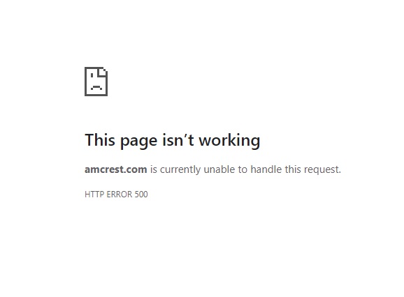

And why do I always get one of these when posting or responding to a post?
I guess I shouldn't be surprised. LOL

Don't know I get as well I have mentioned it to Amcrest.
