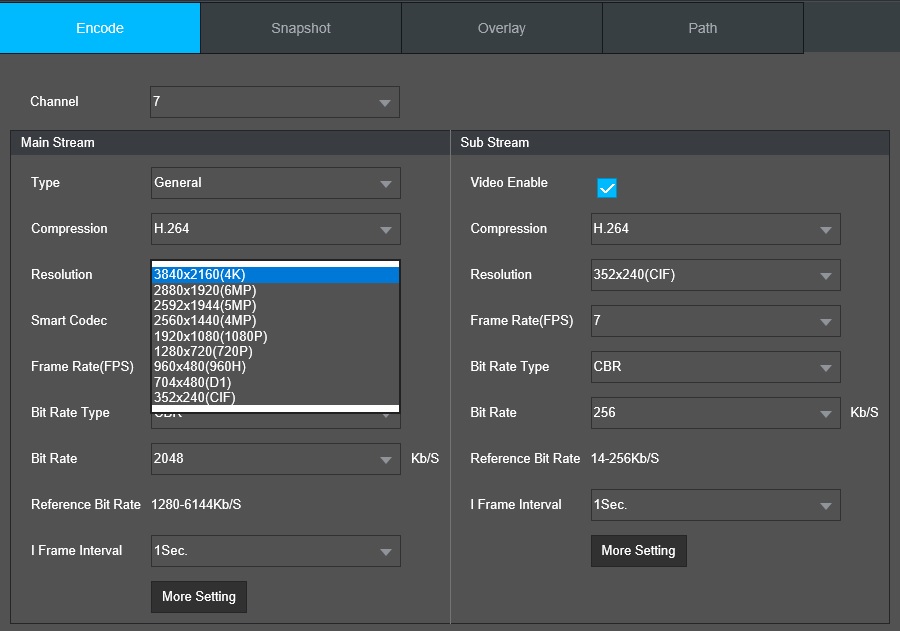

The problem is that your DVR isn't' able to run 6mp. If you look in the settings for the Encoding type it does many others however 6mp isn't an option and might not have been something that was used at the time the DVR was made. Knowing that 8k, 5mp, 4mp and lower was a thing at that time 6mp isn't something that was to common at that time the DVR came out.. At this time for some reason I am not able to post a picture however I did make a snap shot of the DVR's format supported just no way at this time to post it..

Revo2Maxx wrote: ↑Wed Apr 26, 2023 7:35 pm The problem is that your DVR isn't' able to run 6mp. If you look in the settings for the Encoding type it does many others however 6mp isn't an option and might not have been something that was used at the time the DVR was made. Knowing that 8k, 5mp, 4mp and lower was a thing at that time 6mp isn't something that was to common at that time the DVR came out.

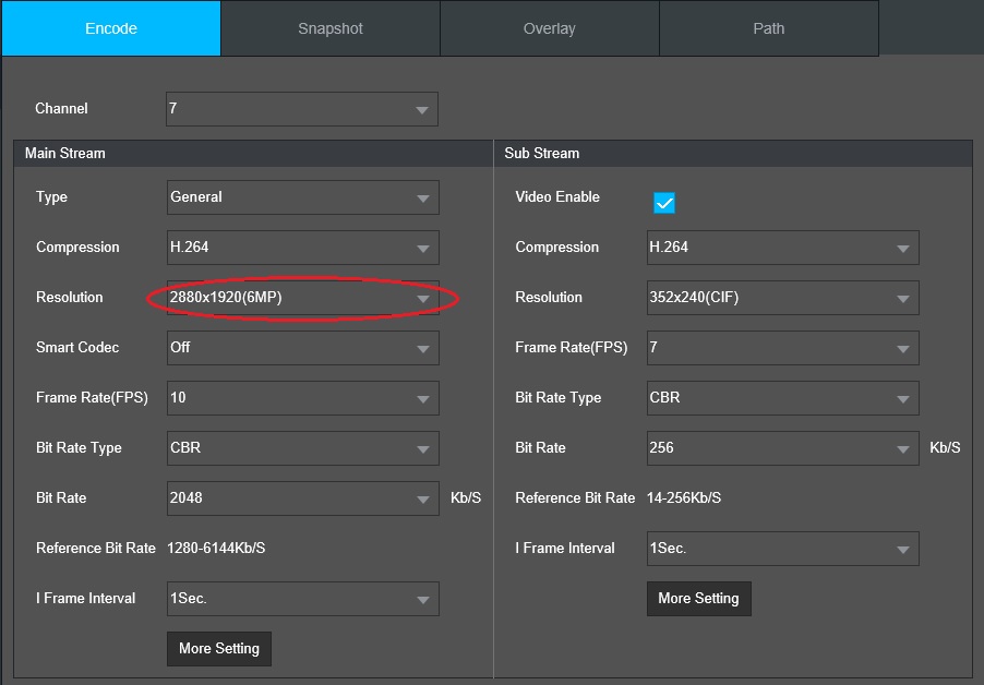

Actually, the DVR is indeed able to run 6MP..., and probably anything else a compatible camera tells it to do within the actual 4K top end resolution capability of the DVR hardware and the associated firmware. The key is having the 'Channel Type' specifically set to that of the camera.., in this case, CVI. The 'Auto' setting clearly doesn't necessarily detect (or properly process) the configuration set up from the OSD, at least not the resolution/fps parameter in this particular case.
While the disappointing limitations are still there, revisiting the encoding possibilities within the OSD at least provided the advertised flexibility, more or less. I guess I'll learn to live with it, but my system is primarily a real time observation setup, not a 5fps parking lot rig. The lousy image on the TV is probably a resolution mismatch somewhere, but the camera looks beautiful on my workstation monitor via the webUI and through Blue Iris and the server monitor. All in all, $44.00 well spent after a discount and some Amazon credit and I may buy another one at $60.00 after kicking the tires on this one a little more. One aspect that did surprise me was the IR performance. Better than expected, but definitely a power hog. Cheesy coax and a wimpy power supply aren't gonna cut it with this camera.

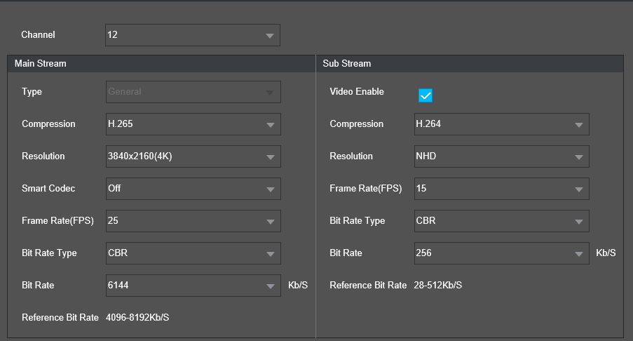

On the other hand, I have a Reolink RLC-811A running with the configuration shown below which goes totally against the DVR spec of only 7fps @4K. And that's with all other channels loaded to at least 1080p with three of them at 5MP. I'm liking this DVR more and more. Just wish it had twice the bandwidth but am certainly not complaining.
And while the Reolink 811 has its own problems, I'd be interested to know if an Amcrest 4K IP camera would also perform at 20 or so fps on a DVM8 or if they have proprietary restrictions in the firmware to simply conserve bandwidth. The Reolink proves the capability is there with third party cameras so I don't know why Amcrest would restrict their own.
