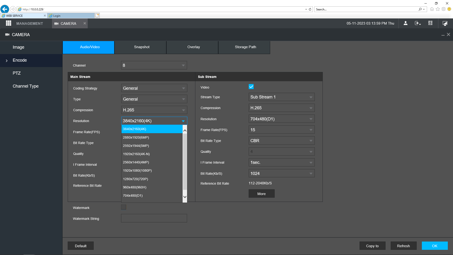

Anyway there seems might still be an issue somewhere (Only with the Audio) all other parts are working with the 7108 at this time. I have not as I said tested it on the older DVR.. One of the things I like about this camera is on the 7108 anyway the camera can be setup in 4K-N and incase have not worked with that before that is for Narrow format. . Also another item I don't get is what is up with this Voltage display on or off? There is no display on my 8m16-H5 or my 7108 so what is that there for
