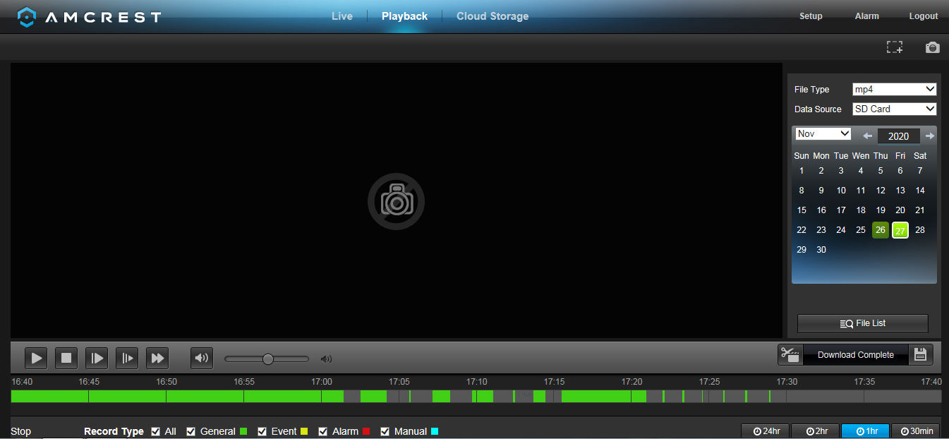

I noticed continuous recordings from my camera to its internal SD card look like they are shot full of holes, with big random gaps where the recording stopped. Motion detection is not enabled, and the green bar indicates that it is the continuous recording that is fragmented.
What could be causing this? Is this what failing SD cards look like in the Amcrest firmware? The SD card is about 7 months old. The camera is an IP8M-T2499E.
SD Recording Fragmented

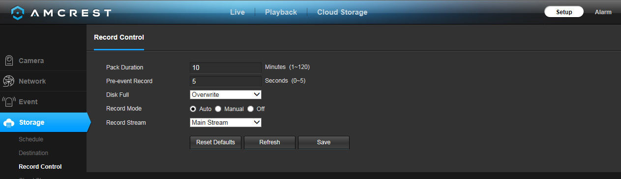

I have not looked at my Cameras MSD for long time but don't remember any of them showing Manual setting for playback...
Personally I would double check that your Camera is setup for Auto Recordings. you mention that your Schedule is setup for full time record and not motion.. So I would Log into your cameras WebUI, Go to Setup, Storage, then Next to Record Mode, I would change that from Manual to Auto. Then your recordings should be setup Green from now on as Full time Recordings and as long as your setup M-Sun 24/7 recording it should showup in your playback as such.

Isnt Manual recording the default for continuous recording?

No you want to setup Auto for always to record
It almost sounds like there is a issue with some type of connection and that is why the Manual Record turns on when there is a connection issue as a Back up of there is an issue with recording to the connected device...

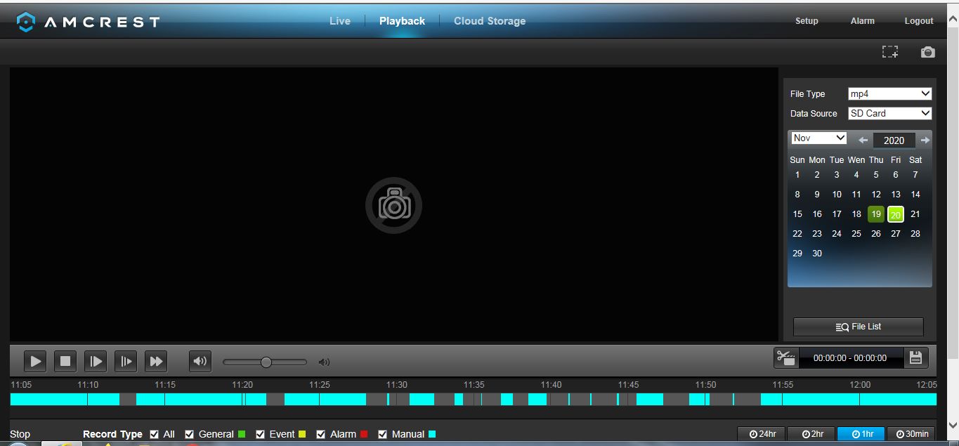

This seems to have started around Halloween with cameras set to manual working fine until then, and no changes in cable.
Re: SD Recording Fragmented

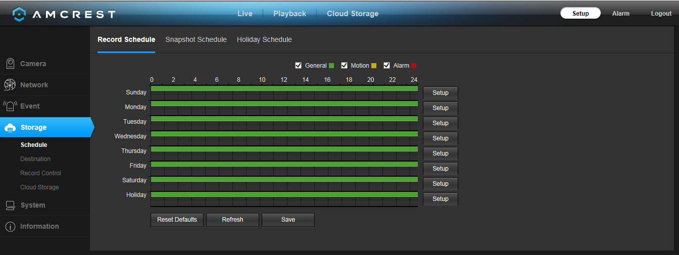

Your snapshot shows the line color for Manual which is not green.patric wrote: ↑Fri Nov 20, 2020 4:43 pm I noticed continuous recordings from my camera to its internal SD card look like they are shot full of holes, with big random gaps where the recording stopped. Motion detection is not enabled, and the green bar indicates that it is the continuous recording that is fragmented.
The "normal" way to record continuously is:
Go to Storage setting.
In Schedule, set up General(green) recording. It must be saved in Setup if used, AND on the screen with the green line in it.
In Destination, set SD card for General recording.
In Record Control, set to Auto.

You were right about the "green" line; Very subtle color difference between the two.jack7 wrote: ↑Sat Nov 21, 2020 8:13 pm Your snapshot shows the line color for Manual which is not green.
