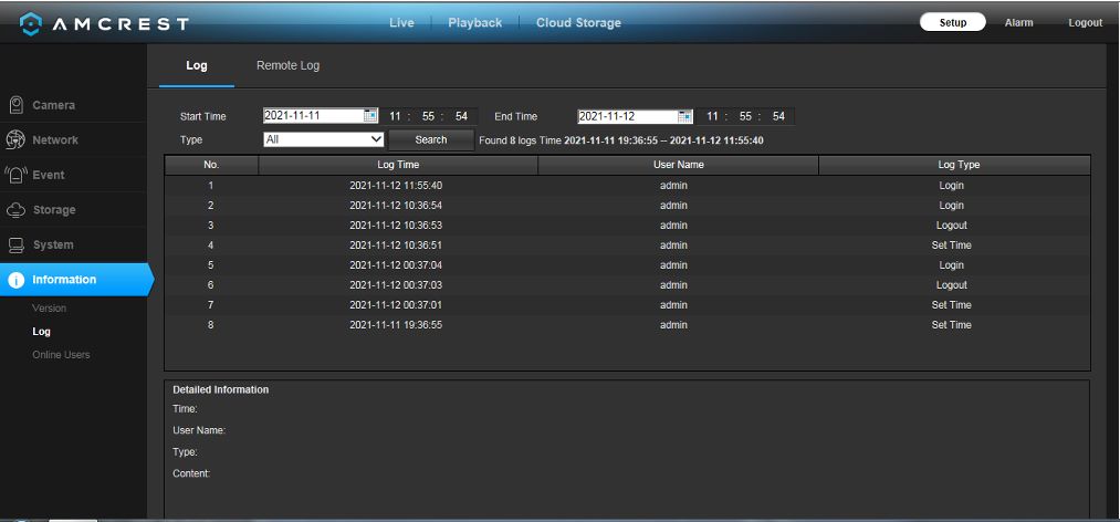

About half the cameras didnt store a log (other than me logging in to look at the log).Revo2Maxx wrote: ↑Thu Nov 11, 2021 11:37 pmIt is odd that a Camera that is Remote and your local camera would stop working the same day. This leads me to believe that as Jack7 said cloud or as I am saying maybe ASP has made a change in settings on a Multi camera scale. I know that I have had some issues while using ASP with multi cameras on multi location setup. Some settings that I made for one camera translated to more then 1 camera and even settings that I didn't make to a camera was changed making me have to Reset the camera to get it to work correctly.
What does your logs say for the day leading to the times recordings stopped.
The cameras that did retain a log just showed a few remarks, mostly odd clock adjustments I didnt do manually.

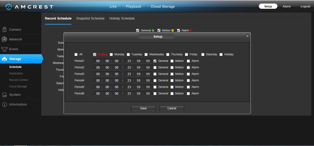

This screenshot is a local camera after I formated and re-booted.
In the settings, Storage | Record Schedule, the lines are all green but Setup isnt saving changes. I was fairly certain all the days were checked off earlier. (see screenshot).

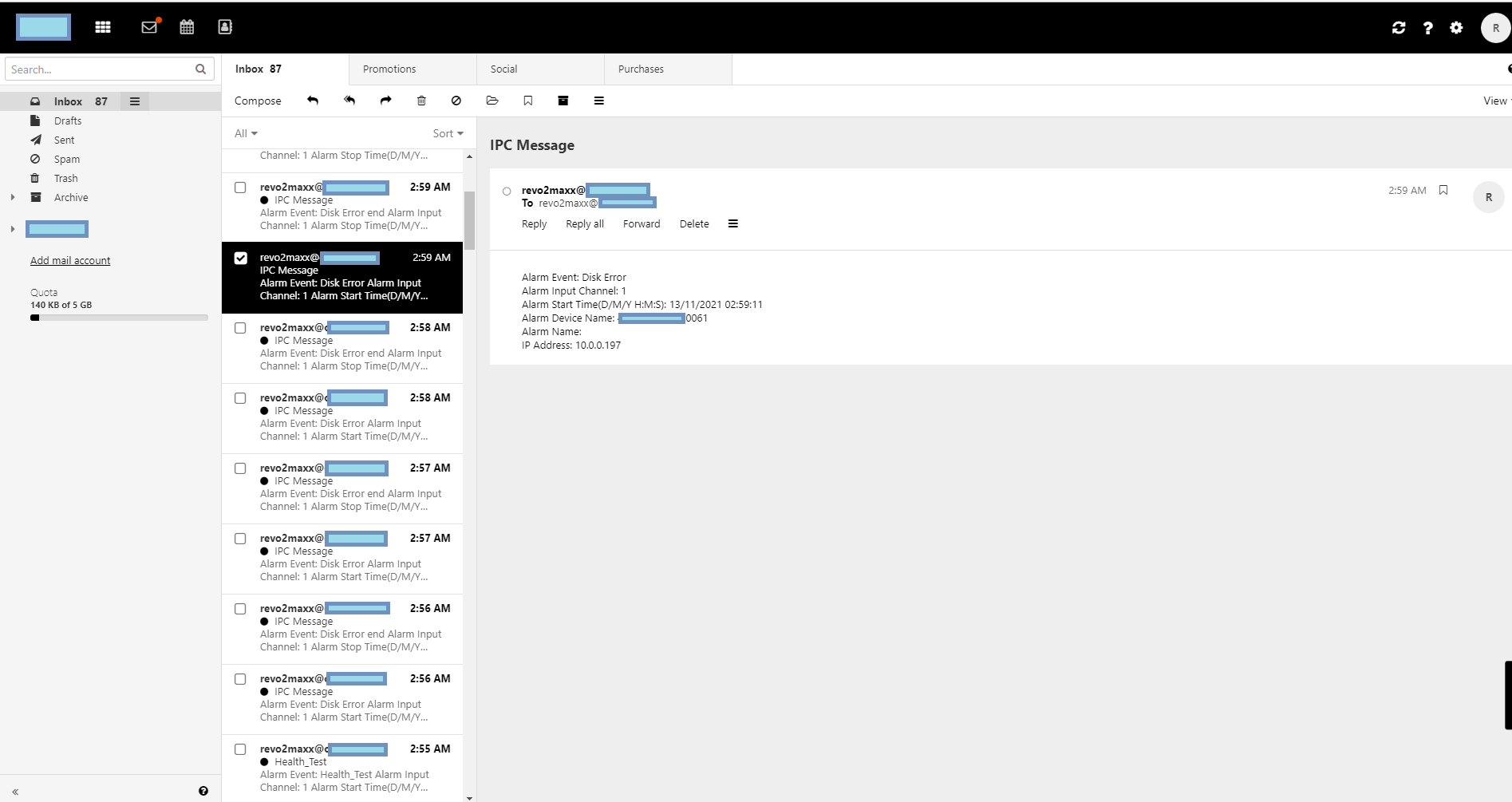

WOW ok all this talk about bad mSD cards and now starting at 209 EST one of my cameras has spammed my Email over 90 times lol Yeah don't setup to go to email. Personally don't like email much so only have alarms and 1 or 2 tripwires that go to it but now seeing that the alarms have a start and end email wow that is just to much lol I will move back to only using push from the app. I just wish the app would get updated with IVS..
