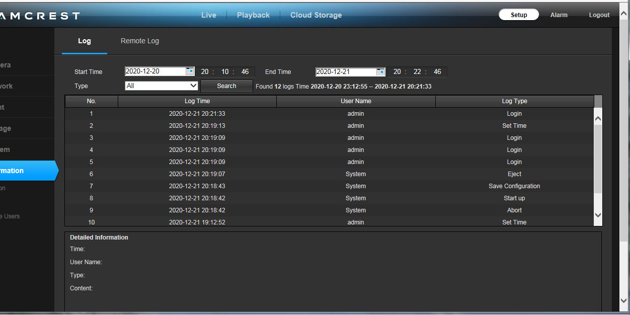

I happened to be listening to the audio of a live camera via the HDMI output of my NVR when it unexpectedly quit. The picture froze and eventually went to black with a "host not found" message.
It eventually came back online so I looked at the cameras log to try and see whats up. I cant say whether or not this is the same problem I documented in previous posts (above) or something unrelated, but there was only one "skip" in this event. Puzzling.

Re: SD Recording Fragmented
The log events
Abort | Start up | Save configuration
seem to correspond to the "blackout" and camera freeze (and the corresponding hole in the green bar) culminating with
Eject | Login
and restoral of camera operation.
Could "eject" be the SD card dismounting itself?
Eject | Login

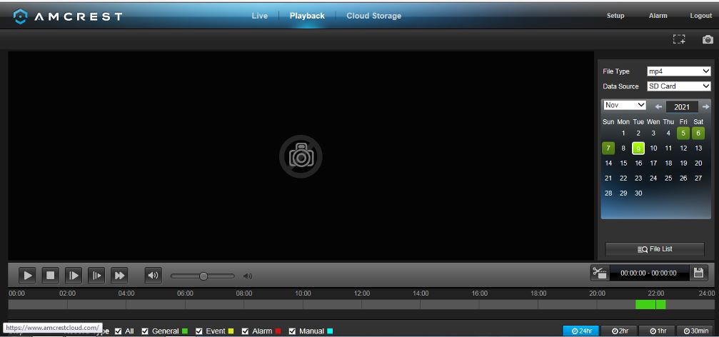

So this issue, which affected most but not all my cameras, seemed to go away for several months and just re-appeared. This time, however, it was also happening to the same model camera in a different city in almost the identical manner.
I formatted the card in one camera and allowed it to reboot, and it looked fine for about 2 days until it would randomly pause recordings.
Is there something about the first of November or the end of Daylight Saving Time that turns your SD recordings into swiss cheese?
In the screenshot below, the SD card recorded normally but recorded nothing on the 8th, and only a few minutes on the 9th. Several of my cameras behaved almost identically, skipping the 8th and recording a snippet the following day despite being properly configured to record 24/7. This is why im convinced it isnt an SD card because others on the network are doing the same thing at about the same time.
The irony is they all worked flawlessly all summer.
Was your camera video stream working on the 8th?
Are you using amcrest cloud? The amcrest cloud link in lower left corner of your screenshot caused me to mention it.
Maybe cooler weather now is causing the problem?

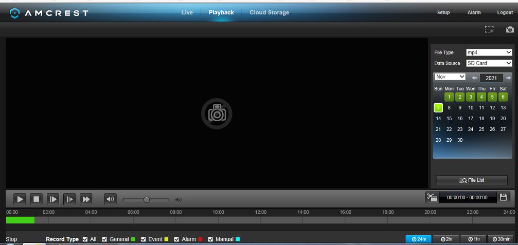

Change in weather might be a logical culprit, just not this time. We have had bigger changes that didnt affect any of the cameras, but the clincher is that the same mode of failure affected cameras I administer that are almost a thousand miles away. The screenshot shows a very remote camera that simply stopped recording the same day my local ones did, on Nov 7.
My local cameras are tied into an NVR and I monitor the HDMI picture daily, the remote ones arent connected to an NVR and are just accessed via their web interface. Im not using Amcrest Cloud. So that rules out a cold day or an old SD card.
What could be happening?
