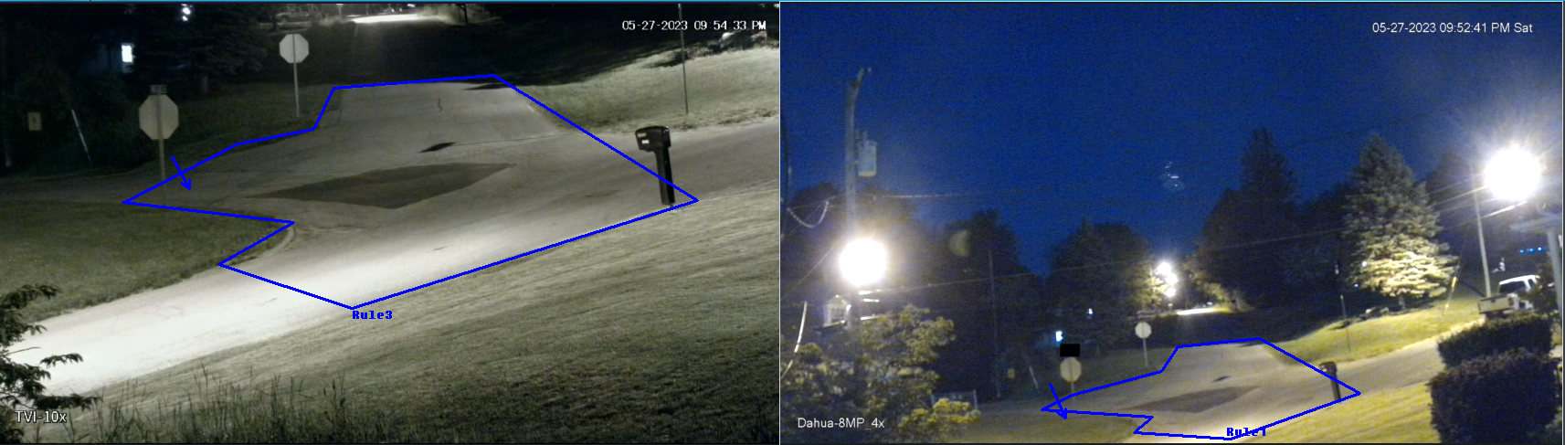

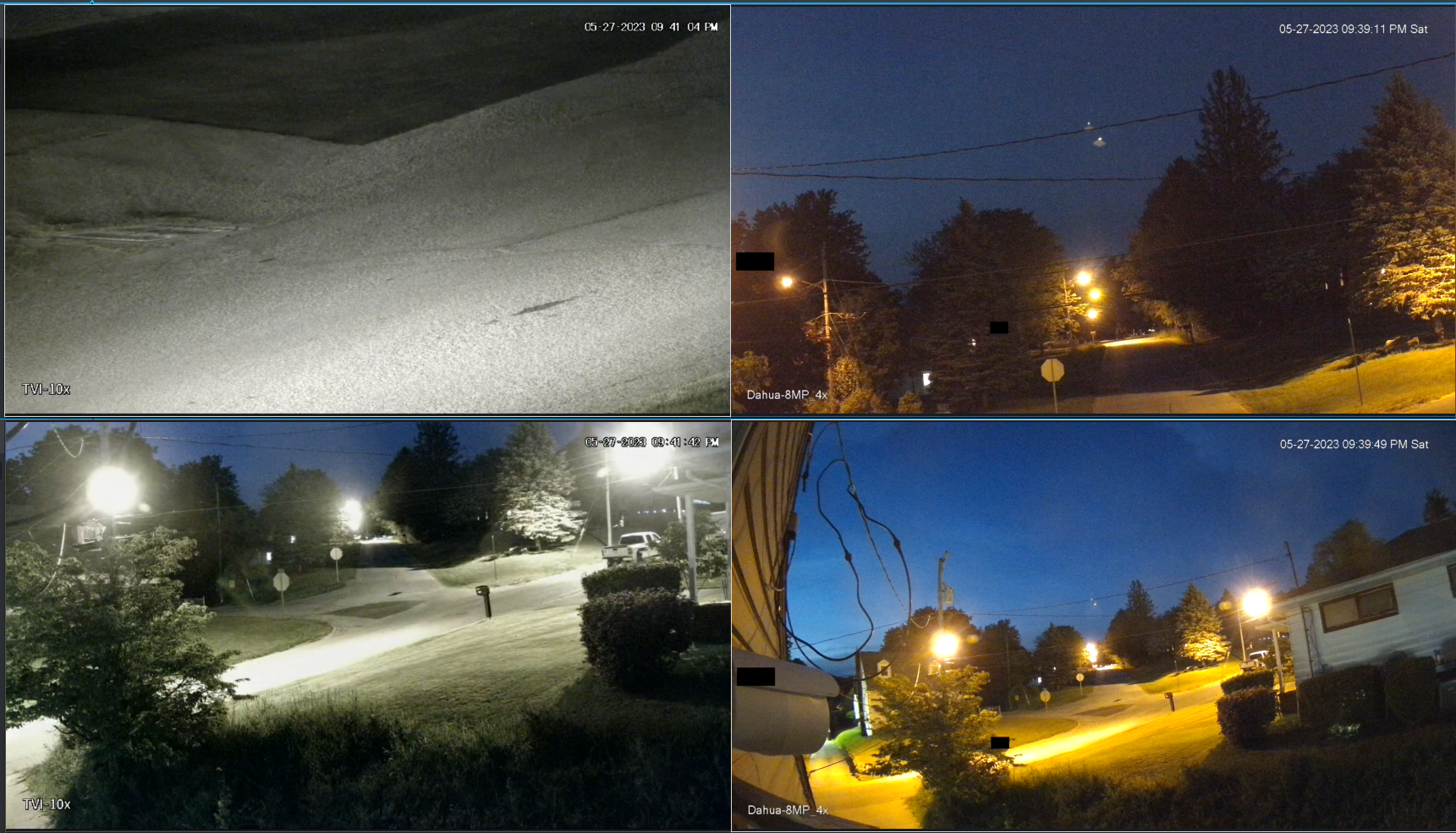

Revo2Maxx wrote: ↑Sat May 27, 2023 6:40 pm So I just looked at one of my 8mp IP cameras that has a max FPS of 15, I setup that camera to run at 15 I-Frames for a few people that drove by and to be honest I didn't see anything different in playback even playing back while paused frame by frame it looks about the same. So how would I know for sure to be honest I would have to have 2 of the same cameras at the same point of view and one set to 1x and other set to 2x aka in this case 15 i-Frome and 30 i-Frame respectfully. Play back and look at the images in each frame forward to see when the real frame changes. To be fair that is most noticed on events that have no change. Because the I frame is the frame of Change the P frame I think is the Frame that don't change within the time.. It has been a long time and the books are buried right now..
However about a camera as Pogo said in your area there I personally would put up a Static camera that has a good size lens to get the best picture quality at night time. Most cameras with the right sized image sensor will look great.. Personally 4mp is what I prefer unless you have a need for a Long view then the 5mp. Then using a PTZ camera even an older one seeing you don't want or need the AI you said I would buy the 858 and that is because it has 25x zoom and you will be able to see the smallest bird in the grass from your cameras area of view.. Use the static camera for full area static image and use the PTZ camera to get a closer view of the wildlife. Like in my case I have a PTZ camera that I can view a bird feeder and ground feeder that feeds everything that passes by. Then I have a preset that lets me zoom into the bottom feeder and another preset that lets me see the water bowl (Not the fountain that is in the front yard) and a preset that I can look at the Temperature outside and so on.. Then at night if I get bored lol. I will look at the moon with the camera.
However if the price between say an AI 25x PTZ camera and the non AI was only a few dollars different then buy the updated AI camera even if not tu use the AI seeing it will have Firmware Updates much longer then the older soon to EOL if they haven't already..
You're referring to this camera I assume?
https://amcrest.com/amcrest-prohd-ptz-2 ... white.html
I was looking at this camera for the 5x zoom.
https://amcrest.com/4k-poe-camera-turre ... 779ew.html
Re: Need help with image quality
Well to be honest I was thinking about telling you that would be a nice camera. Only issue is that it is FIXED install and then it gives you the ability to zoom in up to 5x the issue is and I have made a video I think or maybe just a post.. However when you install a camera like that you will want to zoom it to 100% in as far as the camera will go and then install and point to the area you want to have the best view of. Then the issue can be that once you zoom out you might not get the best view of the over all area..
Now there is a 4mp PTZ camera as well. While I did say 858 there is also a 1053 that might be a better option sorry didn't think about 858 being the 2mp.. However keep in mind. That 858 on the target area of that 8mp camera with the 5x zoom. That 2mp camera with 25x zoom will give you the best of all worlds in picture quality. What I mean. Is Let's say that your bird feeder is the area you have your 5x zoom too, The 2mp camera at 25x zoom would have a better quality picture past the point that the 8mp camera would become blurry using the 5x plus digital zoom.. Looking at the picture below is of 2 cameras in area about 2.5feet from one another you can see the 2mp camera in the 8mp zoomed out picture. That is because this camera has a Wide area of View with a 2.8mm lens and then will zoom in 4x to around 12mm.. now the 2mp camera is only a 5mmx50mm and is a 10x camera. However if I didn't have a nesting bird with some chicks behind the camera I would fix the 8mp to look at same area when zoomed in to show that the 2mp camera 10x zoomed in would have a better image quality then the 8mp at 4x or in your case 5x zoomed and then would have to use digital zoom to get to that area of view.. The second picture I took to show the area of view I have setup for the 2 cameras. One is on a AI DVR the 2mp 10x is and the other is a Semi AI camera and I am using the IVS intrusion for some quality control testing between my 2 systems. The camera is up the street to capture more of the area that the 10x zoom 2mp camera can't see at it's current height position. This camera 2mp I can use to read License plates if I wanted to even at this location with this lens.
Then the 1053 PTZ would be even a better camera then the 2mp one for the best quality over the 8mp camera and over all that what makes it even better is that it will pan and tilt and zoom to even a much further area then the 10x zoomed in looking at the street. I know some people might think why did I put it there and to be honest that is the area where cars come around the corner and front plates can be seen perfect. However as of now my state did away with requiring front plates so don't really matter but was there for while already..
Screenshot (4458).png (2.64 MiB) Viewed 6531 times
Screenshot (4460).png (1.31 MiB) Viewed 6531 times
