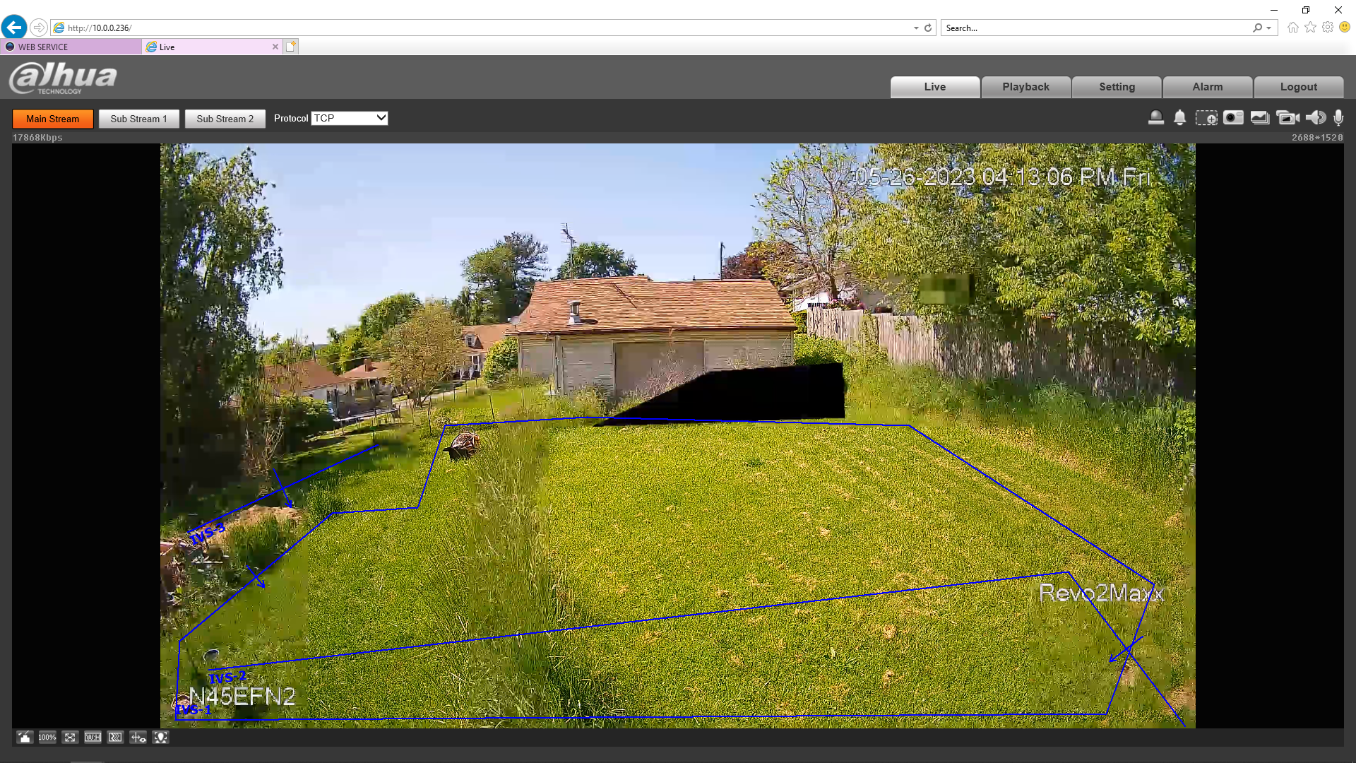

Revo2Maxx wrote: ↑Fri May 26, 2023 1:12 pm Cut down the red tree and your video issues goes away...
Jokes aside, the issue is that your camera is trying to focus on something that isn't in the right area for your view. So something you might want to try. If your camera has ROI setup the area where you want the camera to be best focused at. Keep in mind that doing so will or can remove the other area out of the picture all together. I mean like some cameras have a few ROI frames and others offer only 1. Then there are the ones that offer none and if that is the case that tree is the issue. This is my guess..

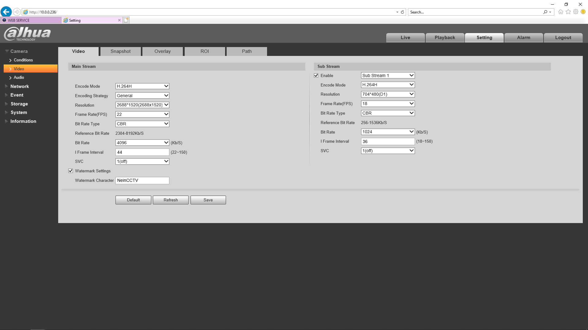

Re: Need help with image quality
Sorry. Region of Interest. So I know this camera that I am showing is a Dahua but it will give you a general IDEA where the ROI is or could be in your cameras WebUI.. Click on the Setup, then it will start in camera, then click on Video, then in the top could be a Tab that says ROI not all cameras will have it and as I said some will have more then 1 that you can add into your scene.
Also this camera that I am showing is a Pro Version. This camera has 4 different ROI and here is a picture with 3 smaller in different parts of the area of View. I have 4 areas that are very clear in picture them are the areas I have Enabled
Screenshot (4454).png (2.91 MiB) Viewed 4260 times

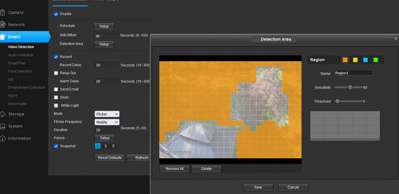

Thanks. Doesn't seem to be an option on this camera (IP8M-TD2685E-AI).
The nearest thing I see in the options is for motion detection where you can select the areas to focus on.
Can you post a picture of the Camera, video page like in my first picture?
Your 3rd picture on the front page is missing the Tabs that is what I want to see if you would be willing to post the page with the Tabs like in my first picture there is info in your picture that is missing that I am sure the Amcrest camera has.
