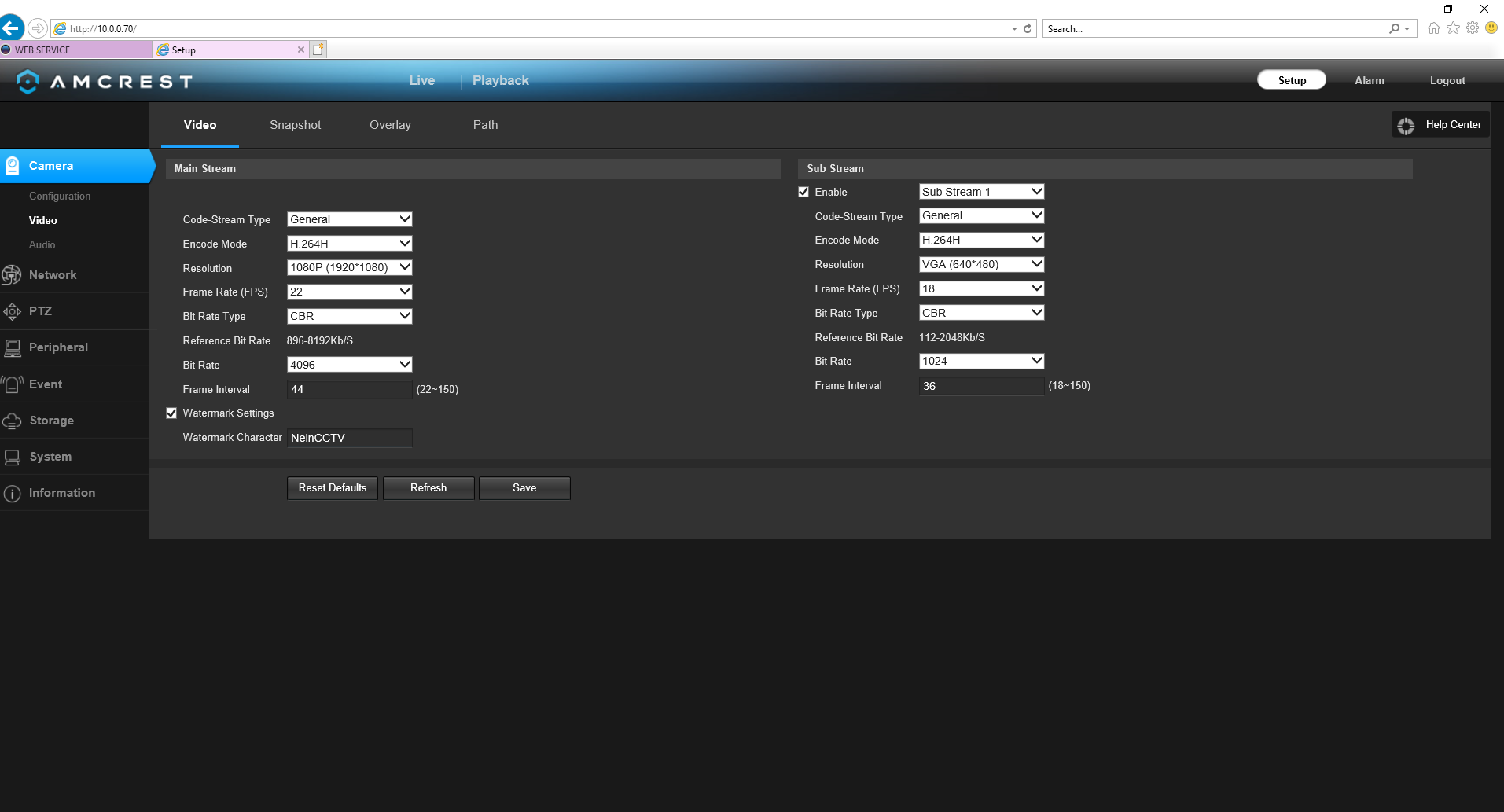

This is from my old FW Amcrest camera. IT would look something like at the top of the picture area right below live and playback.
Screenshot (4456).png (125.6 KiB) Viewed 5447 times

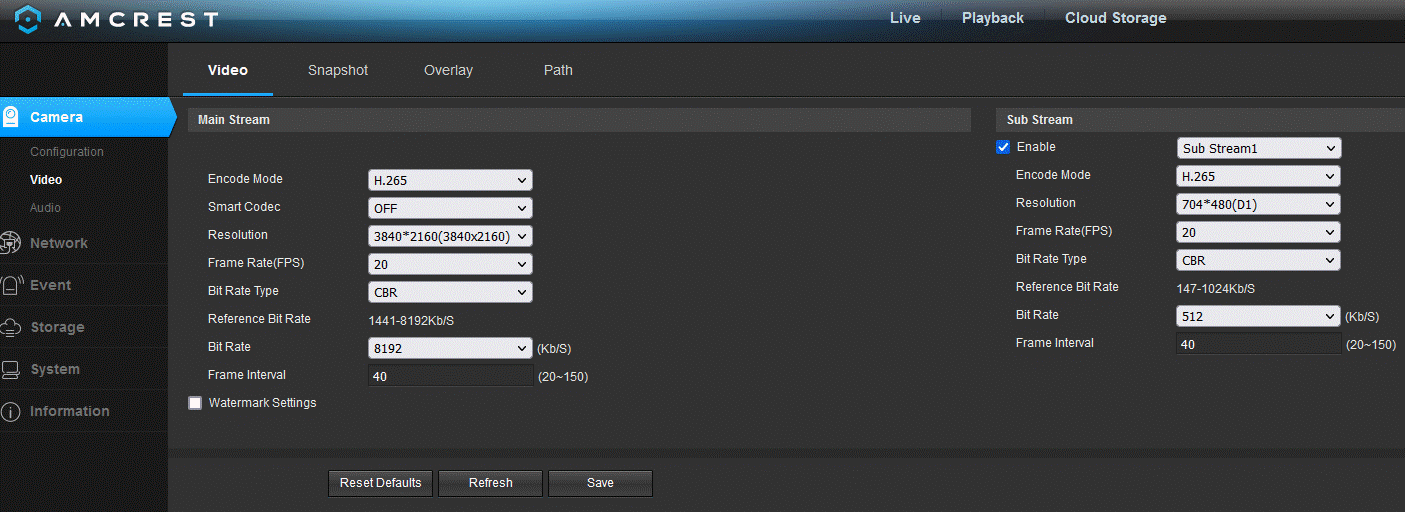

I just had another response disappear when hitting 'submit' so I'll try again with an abbreviated version.
What NVR are you using?
It probably won't make much difference, but it's common practice to have the frame rate and I-frame interval the same and your I-frame is set to twice the frame rate which is essentially every two seconds in your case.

Re: Need help with image quality
No the iframe on the NVR is fine. That is setup by the camera. it is little different in the DVR. IF you look at your DVR you will see there is a X1 or X2 option. In the DVR it is normally setup for X1 and that is how I leave it. However if it was setup to X2 it will be more like the IP Camera. If you look in my picture on that same page mine is setup for 22fps and my i-Frames is 44 that is how the camera is setup and as such that is how the NVR gets setup.
