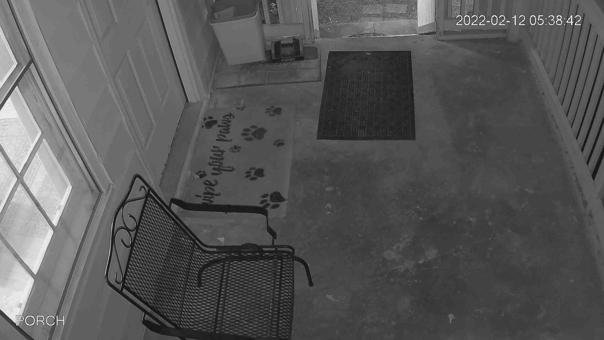

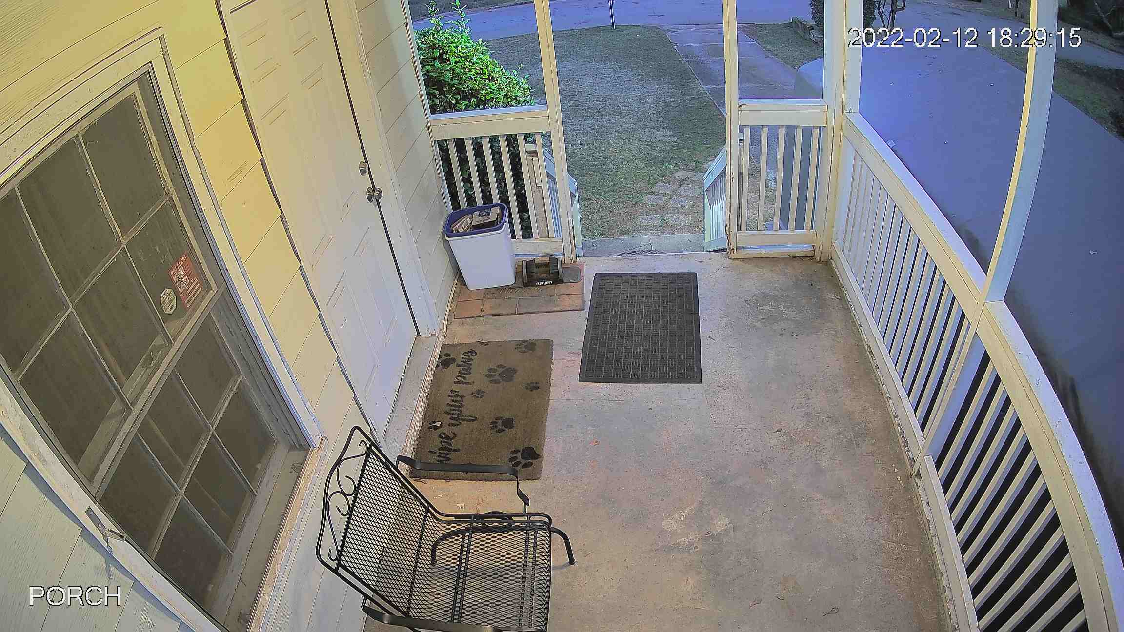

Hello,
I just bought a pair of IP8M-2496E-V2 on Amazon to replace some older cameras that I had. Both of them are running the same firmware (version=2.800.00AC001.0.R,build:2021-07-12) and were configured almost identically going by some written steps that I use for configuring all of my cameras.
Every time one of the cameras switches into night mode, it... "crops" the image. This is very strange to me, as the actual resolution it's capturing and streaming is the same, but it only shows a smaller area at the center of the image. The following snapshots are taken from the main stream without changing any settings at all, just one during the day and the next at night:
I've pulled the configuration from each camera via API (both config.json and the various getConfig API endpoints) and the only differences are that the problematic camera is set to a slightly lower FPS (for reasons), has WDR enabled in only the default profile vs all profiles, and does not have an "ExposureCompensation" item in VideoInOptions. None of those seem to me like they should cause this problem. Aside from FPS, all of the other VideoEncoder settings are identical. Aside from the missing (but default) ExposureCompensation value, all of the VideoInOptions settings are identical.
I've tried rebooting the camera to no avail. This repeatably happens every time it switches between day and night modes.
Does anyone have any suggestions, other than taking the camera down and returning it as defective (if Amazon will even accept it without the packaging)
IP8M-2496E-V2 Image scaling down / cropped only at night

I tried a factory reset last night, and then configured the camera again according to my notes. This didn't make a difference; it's still doing the same thing when in night mode.
HOWEVER, I did realize (I'm really not sure how I completely ignored this before, I guess frustration) that the other camera I bought "doesn't have this problem" ... because it never goes into full black & white night mode. There's a flood light illuminating most of its view area, so it never switches over. Tonight I'll need to shut off the circuit for the flood light and see if the other camera does the same thing or not.
I've had about 14 Amcrest cameras of different models now, and this is the only one I've seen a problem like this with; all of the others retain the same image when they go into night mode (which is quite important for me, since I use ZoneMinder and have motion detection only in certain areas of the frame). I bought this camera because it was advertised as having a "Super-Wide 105° viewing angle."
I'm using ZoneMinder to record them, but I've been using the WebUI to troubleshoot this (since I've been messing around with the settings anyway) and the snapshots in my original post were taken via curl to snapshot.cgi. All of those show the same issues.
I guess I'll shut off the flood light tonight to get the other camera into actual night mode, and that will either confirm a problem with the one camera (I suppose I'll try to RMA it?) or that this happens to both of them (in which case I guess I'll need to just use the camera somewhere else, and find another model for this location).

Well... last night I shut off the flood light and found that the other camera exhibits the exact same behavior. So either it's something caused by how I configured the cameras, or it's just their actual design. I guess I'll try contacting support/customer service.
Yes, I've been checking the built-in WebUI as well, and yes it's showing the same image.

I use the default "General" profile with Mode Auto, Sensitivity Middle, and Delay 6 Seconds. I believe that's the default when they're new. I have "Profile Management" set to "General".
Well, it looks like you're onto something with the profiles! I went in to the WebUI, Camera -> Configuration, and changed the dropdown from "General" to "Day"... and the preview image almost instantly changed to the "cropped" version that's been giving me problems. It stayed there when I switched the profile to "Night", and then quickly returned to the full image when I changed the profile dropdown back to "General". So there's definitely *something* going on here related to the profiles... only "General" gives the actual full image, and both Day and Night give the smaller/cropped/reduced image.
Unfortunately, I don't see any new settings in the Configuration/Profile Management pages that weren't there in older versions. And the only thing I changed in any of these settings was enabling WDR.
I guess I found the bug. If I enable WDR, it shows the full image area. If I disable WDR, it crops down as shown in my original post. It looks like the fix for this entire problem was just to go into the "Night" profile and enable WDR. As far as I can tell, there are two separate bugs in the firmware:
- The full image area is only shown if WDR is enabled; if WDR is not enabled, only the smaller cropped area is shown. This is per-profile.
- Despite Profile Management being set to "General", it seems that the camera is still activating the Night profile when it gets too dark and needs IR.

Well, so much for my theory of just fixing it by turning on WDR. That didn't work. I now know that on these cameras:
Hopefully support will get back to me with something helpful. Luckily the camera I replaced was still working, so tomorrow I'll swap back to the old 1080p camera. I'd rather have a constant field of view.
- Turning WDR off always results in a smaller/cropped image.
- Night mode / IR on always results in a smaller/cropped image.
