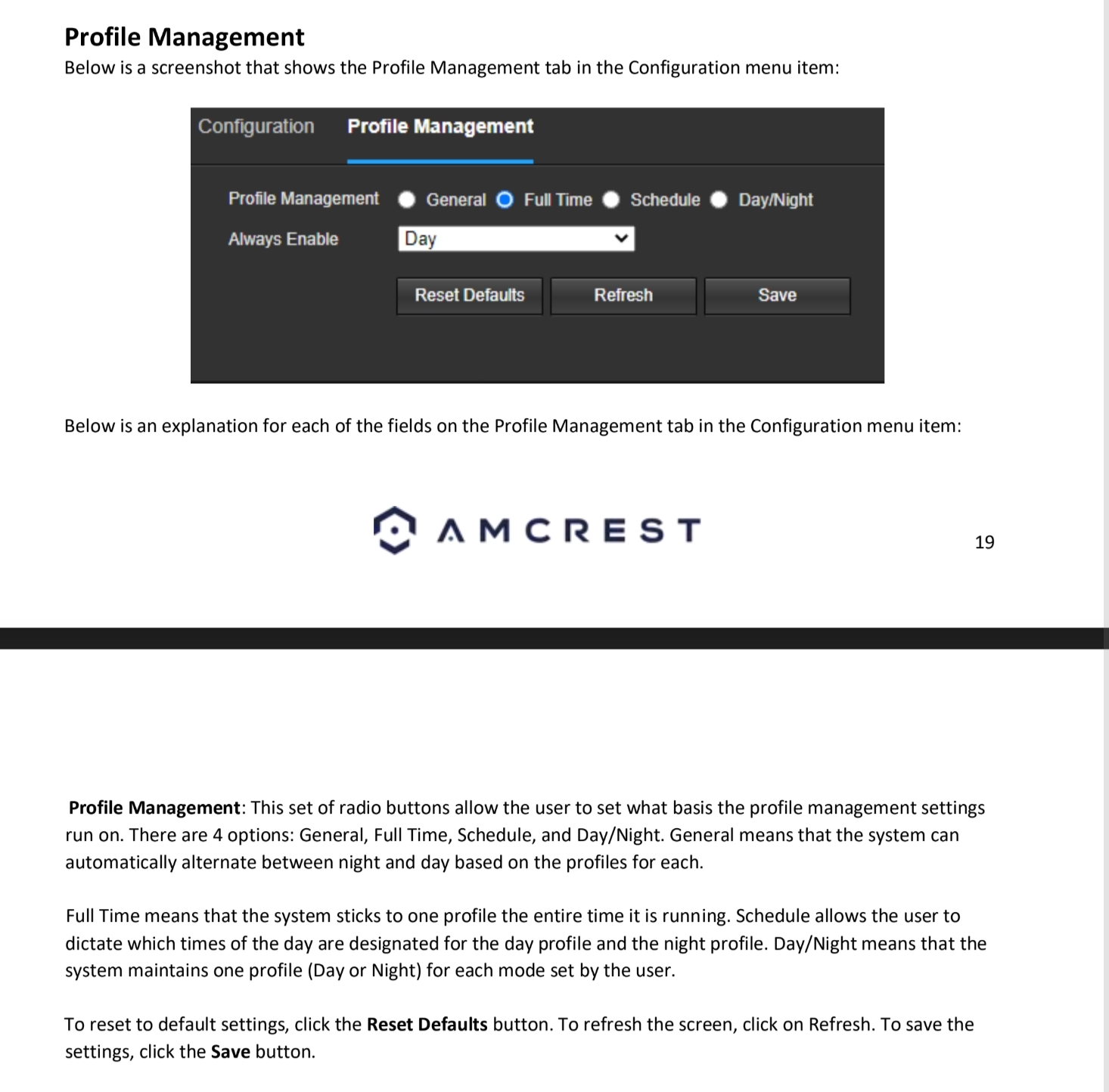

Maybe this will help.
Below is what your Profile Management page should look like in Web UI. If not, you are likely using plug-in firmware which does not show Day/Night option. To use the latest no plug-in firmware, try using a current browser that does not support plugins. I don't know what browsers are available in Linux.
From IP8M-2496E-V2 User Manual:
IP8M-2496E-V2 Image scaling down / cropped only at night
Re: IP8M-2496E-V2 Image scaling down / cropped only at night
Thanks so much, @jack7. Yes, that's what my Profile Management page looks like (I'm using Google Chrome). I guess I'd forgotten the details of it... yes, the options of General / Full Time / Schedule / Day/Night are slightly different from my older cameras, which had Normal / Full Time / Schedule. I guess I should have double-checked that.
However, that doesn't seem to be solving the problem. Even if I use the "Day" profile, if I change "Day & Night" "Mode" to "B/W", the image always gets cropped as shown. If I change it back to "Color" (or "Auto" during the day), it always goes back to the full image area. I'm starting to think that what @Revo2Maxx said in one of his messages, that some cameras have separate sensors for B&W that have a narrower field of view, might be the case.

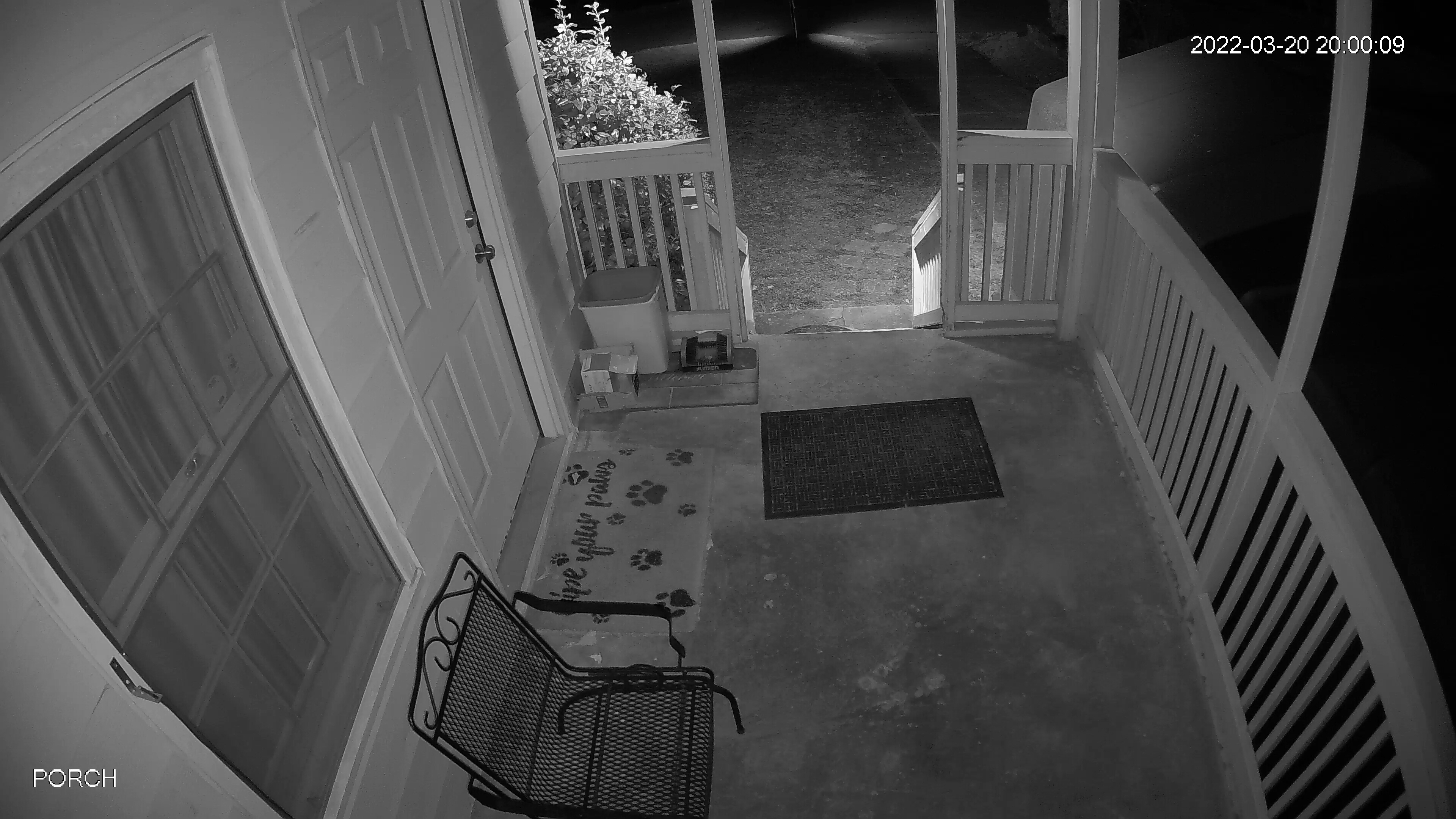

I mean the picture you posted look nice at night even though it is cropped, What is your feelings on the quality of picture at night with busy scene now that it is fixed? The camera isn't listed like a AI camera however the data sheet I looked at says it has Trip Wire and Intrusion? My son don't remember if it did or not. However again as I was saying the spec sheet says in the heading that it has AI and in the listing says under DORI that it has the 2 IVS rules. Glad you got it sorted out. Seeing the one he had has the 2.8mm lens not 100% sure where I will put it. Kind of need Zoom ability for where I want to update one of my cameras.
Since fixing the issue how does the night picture look these days?

Very nice. I have to say that your Picture is cleaner then mine. I have to run mine with IR off. I have not been back there to take it down and clean lens. I did replace the pack when I got the camera from my Son. I should have bench tested it before installing it for night vision with IR. While it isn't really all that bad it is a cleaner picture with IR off. What does yours look like with IR on Auto or say manual 55%. On mine and the reason my Son wasn't happy with it was the 1046EW-AI I got for him he liked it better. When I asked him to send me a picture he said he already took it down and he would just pack it up and send to me and I could have it and know for my self.. So far again didn't know. I mean I cleaned in and outside glass of the camera when I changed out the Gel Packet before I installed it. there shouldn't be any reflection from IR off glass seeing the way the IR is installed and the camera front. However there is something with IR on causing right side of picture little blurry for mine anyway. With IR off using IR from another camera it looks fine, or in color at night with White light from one of my Color at night cameras it looks ok. B/W in that location is best at this time for clear motion at night. Tonight I will show what I am talking about with IR being on and off.
Nice you were able to load large image my account only 2meg limit lol. Very nice clean picture there. Glad your Shrinkage has been solved.
